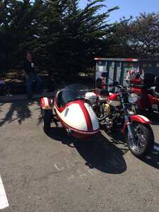

One of my sidecars is my old -89 Softail Custom: I replaced the 21in front wheel by a 16 (on the advice of different "gurus"), bought some nice raked custom
IMG 5316
triple trees, longer fork and a damper. The old Evo (68K miles) is still happy pulling the California Companion GT and is not too heavy in the twisties.
Posted : October 20, 2025 1:24 pm

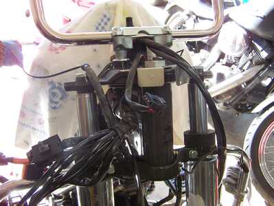

The trees are much different between the 69' and the 97'. On the left is the standard lower tree from my 72' FLH (not the adjustable tree fitted to side car bikes) the fork is forward of the stem, no rake in the stem, and the frame had 30 Degrees of rake. Thus the need for adjustable trees and a damper for chassis tuning. When elevated for a steering head adjustment, the natural position of the wheel is full lock to either side.
On the right is the lower tree from a 98' touring model. The fork is to the rear of the stem, the stem is raked at about 5 degrees, and the frame had 26 degrees of rake. When elevated, the natural position of the wheel is straight ahead. Harley started using this design on the first rubber mounted touring chassis in 80'. This design decreased the steering effort, and improved handling, as the new platform was much heavier than the old.
The last pic is my 04' FLHT which shows the newer style trees.
20251020 153216
20251020 143913
087

(@panhead_kicker)
Chris,
Glad to see several folks with knowledge of both eras here. Are you saying the fixed tree design of the 80 up FLs provides better handling with a sidecar, than the previous adjustable rake trees of the 60s-70s set to sidecar and not Solo position? This correlates with 2FLTCs opinion.
I do plan on running the -83 steering damper. You guys are boosting my confidence. I kinda figured Harley wouldn't do worse than the 70s and earlier design, but no longer offering specific forks for sidecars made me wonder how that was achieved.
