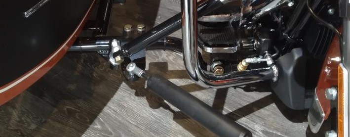

Quote from 2FLTC on July 17, 2023, 10:34 am
I still must be missing something on the gold one they have the banjo with what looks like a quick connector facing the sidecar and one the red it's facing the bike which looks a lot cleaner. Both are mounted on the rear master cylinder.
This is a better view. You can see they tapped into front Master cycl. The quick dis connect is brass . The line is hard to see but runs straight under  frame to the car.
Posted : July 18, 2023 4:55 am
Posts: 1587
I believe what has confused some of us, is the notation that the sidecar brake line is connected to the bike's FRONT master cylinder.
The pictures clearly show that the sidecar brake line is tapped into the bike's REAR brake Master Cylinder.
The bike's FRONT brake Master Cylinder is up on the right side of the handlebars.
As with ALL of the sidecar rigs I have owned, and built, I also tap the sidecar brake into the hydraulic brake line for the bike's REAR brake.
Posted : July 18, 2023 6:27 am

  Brain failure . Want I meant to explain was they plumbed it to the front master Cyl  witch is the rear brake. Normally the plumb to rear caliper.

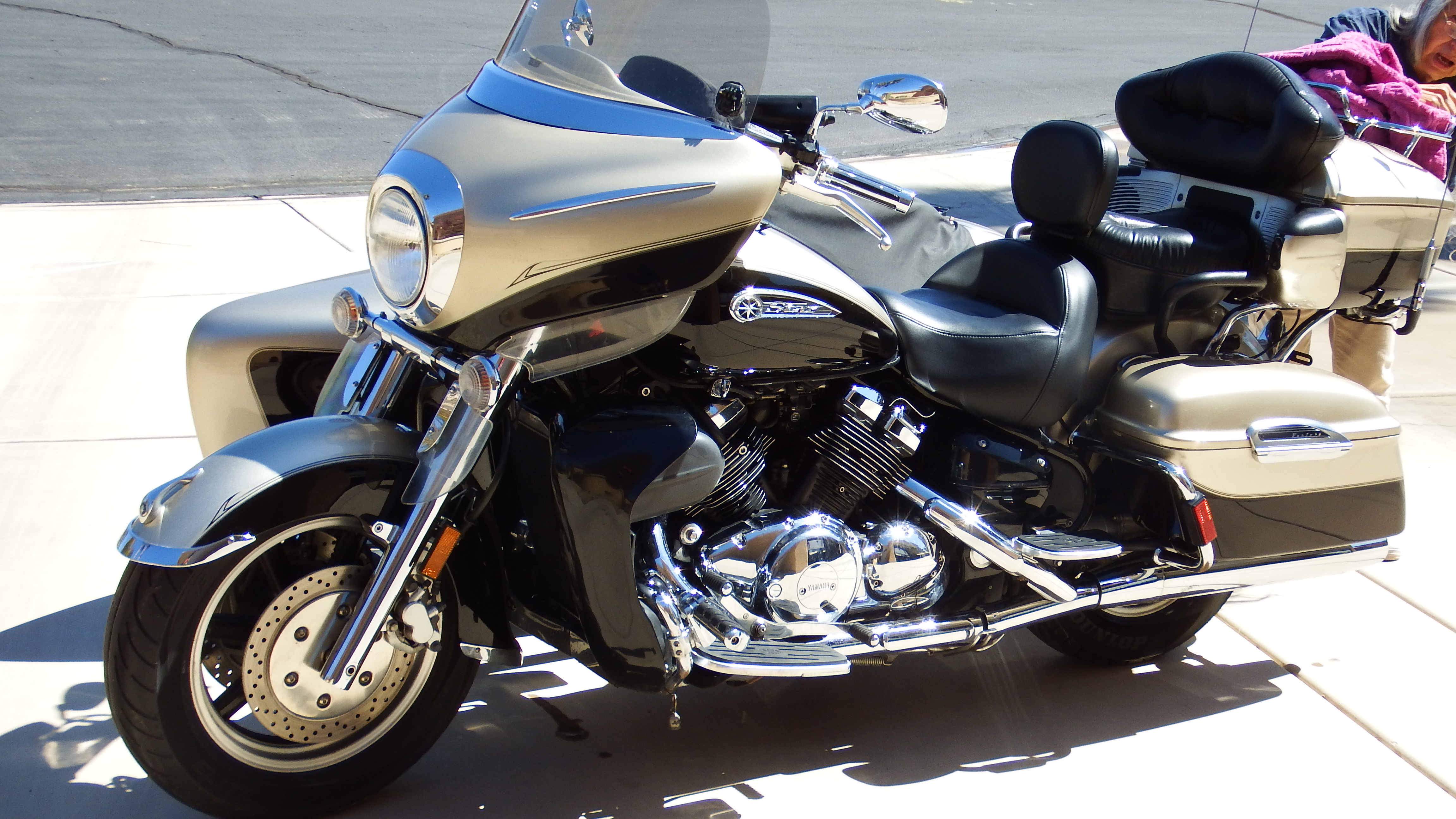

Friend bought an Street Glide after riding a Yamaha Royal Star for about a decade (still has it).  After reworking the suspension and getting a seat that fits him he absolutely loves the bike.  His favorite part is how it just eats up miles on the freeways, and how the stability allows him to enjoy the views along the way.  He has met some great people at the H-D events he's attended, but is not a fan of the H-D attitude exhibited by many.

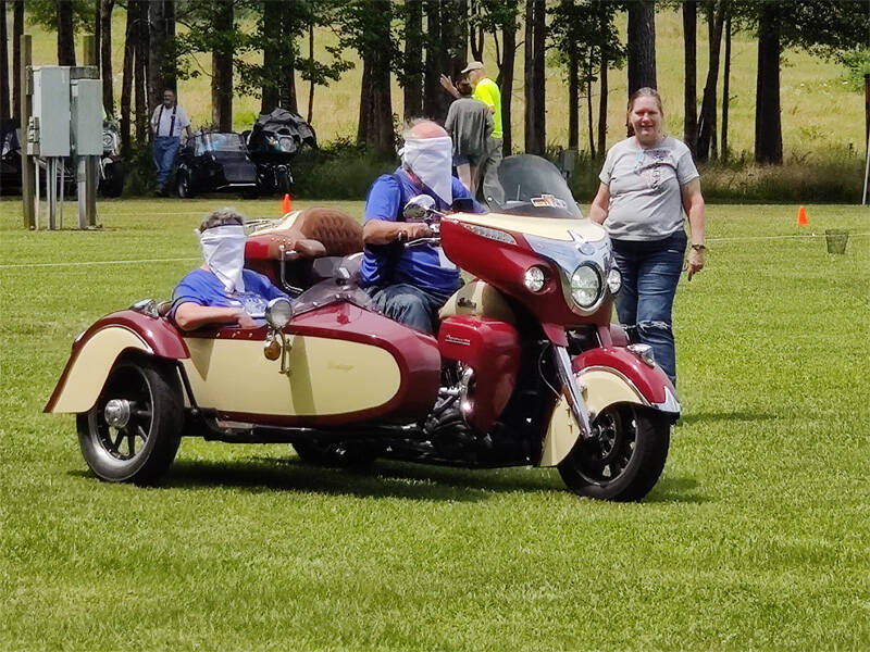

For me it would be an Indian with spoke wheels, and enough fringe to make up for my bald head.  There were some stunningly beautiful examples at the national rally in Iuka.  In my highly subjective, and biased opinion the classic Indian look is drool worthy.  😍
Here's a great example <insert wolf whistle here>:
Looks great even when flying while blind. 😉
Indian Flying While Blind
