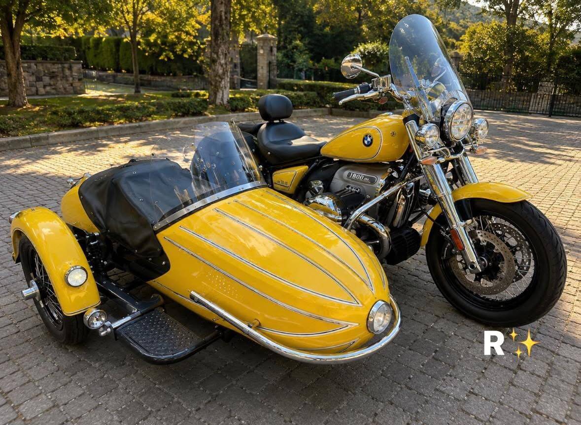

(@wahlbornwi-rr-com)
Posts: 19
IMG 0695
Is this on a Watsonian Frame or a DMC?
Posted : September 7, 2026 4:17 am
Posts: 730
I'd be saying DMC.
Other's will confirm.

Posts: 1858
Posted by: @brstr
I'd be saying DMC.
I must concur with my Western Australia mate....it's a DMC frame.
A "real" Watsonian sidecar frame would have been fabricated by Watsonian Sidecars in the UK.

(@sidecarusa)
Posts: 91
Appears to be a dmc frame the bumper is a giveaway since not part of the frame. From what I have heard tsc is no longer an authorized mfg for watsonian that partnership has ended. Probably wont be see anymore of the American made version
