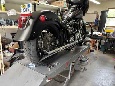

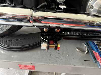

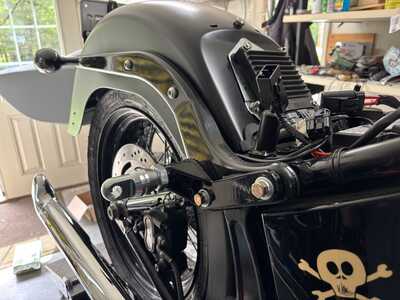

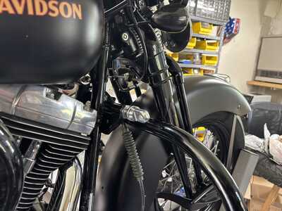

Weather was good today and I was able to put the bike back on the table in the workshop.  Took the exhaust, floor board, brake
IMG 0193
IMG 0195
IMG 0196
IMG 0197
and crash bar off and put the bike side mounts on.  Put everything back on along with the different pipes that were higher and allowed room for the lower mounts. Hope to test fit the frame and mock up the tub tomorrow
Posted : May 8, 2025 3:47 pm

Looking good, A tune will get it running more efficient and run cooler as they run lean from the factory and that exhaust will make a big difference with the A/F. I would also install an oil cooler and expect to change your oil more often. Its air cooled and you going to need all the help to keep it from running to hot.
