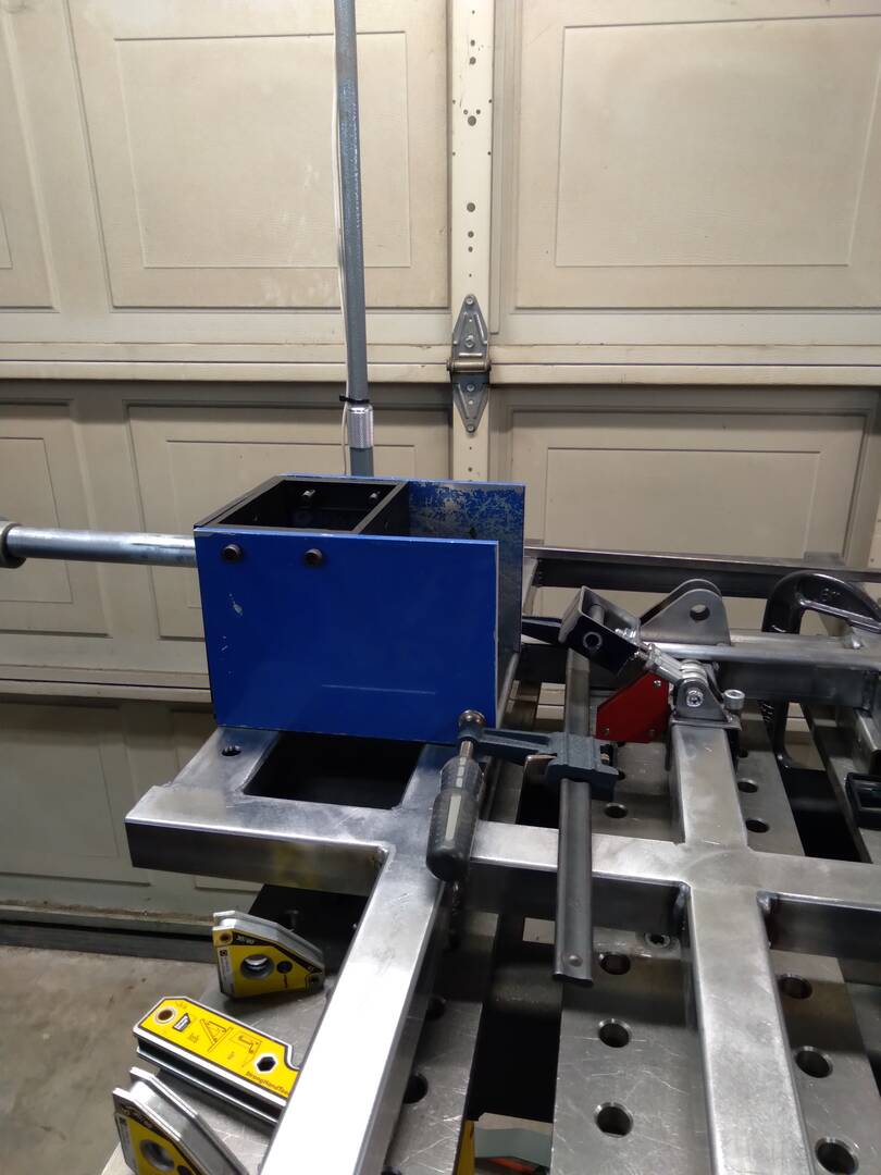

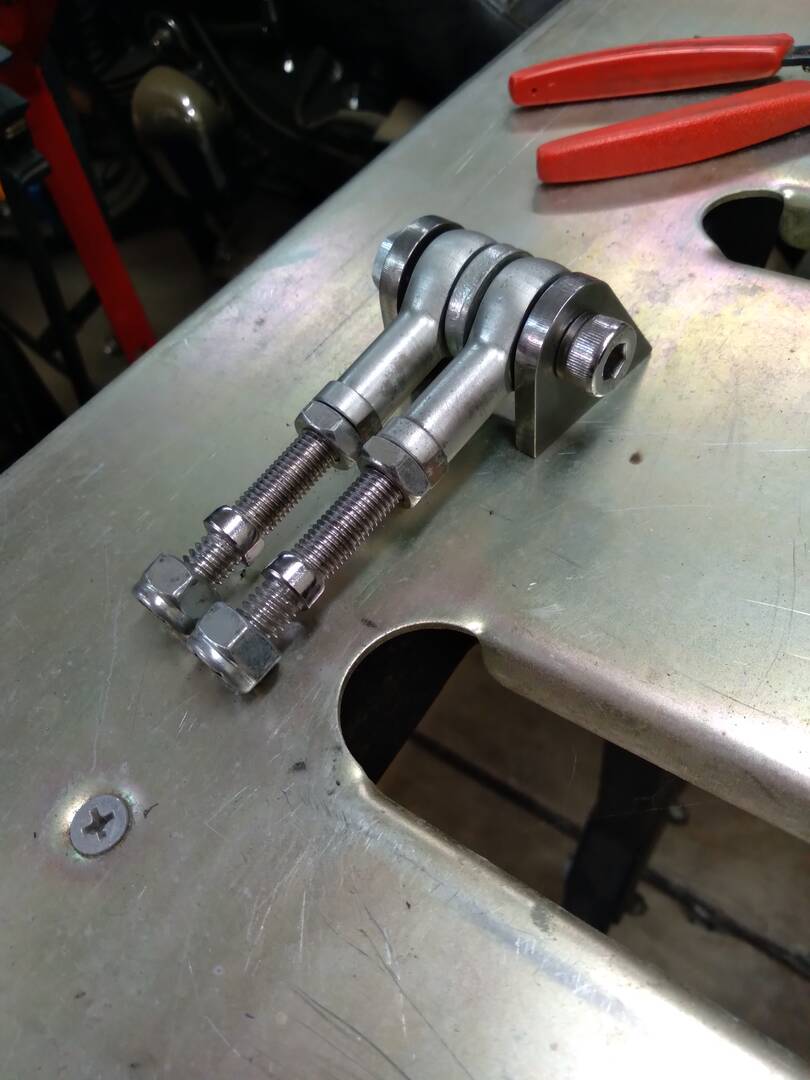

Since there is no suspension on this, I want to spread the loads the axle block will suffer deeper into the chassis. With the fixed lead position on the first chassis this was simply two plates with slotted holes to allow height and camber adjustment of the block.
With three possible lead positions on the new chassis, and clearance requiring a 2" wide mount on the center frame rail, a new system was needed. So I've been building this to accomplish the same goal, no plan, just building as I go out of stuff laying around.
A clamp, a couple rod ends, and a pivot block. Much more cutting. shaping, and sanding to do, but it's to the point that it all bolted together.
