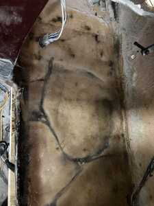

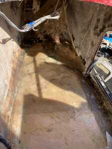

(@chloespop)
Posts: 105

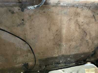

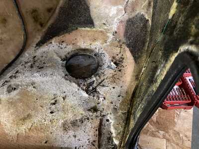

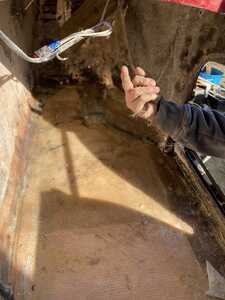

Everything is now stripped of the tub, nothing but fiberglass remaking.
My plan is to repair the two sides and the floor first in order to get some rigidity back in the tub. Once that is complete I’ll work on the entire nose.  The nose will be a significant project all by its self.
The tub is scary and ugly at this point but I keep telling myself that “God hates a coward”.  Tomorrow is the beginning of the end, fiberglass repair.

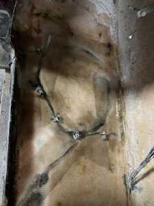

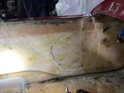

(@chloespop)
Posts: 105

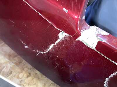

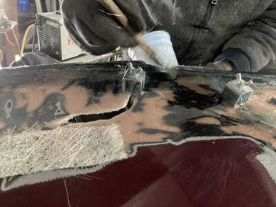

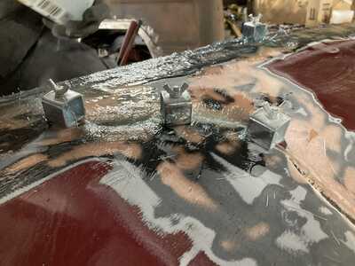

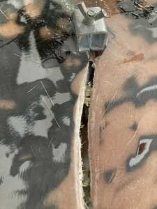

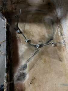

Started the grinding, beveling, realigning and fiberglass work today.  Used welding panel clamps to keep the pieces aligned while the fiberglass is drying.  All of the cracks were stop drilled to eliminate the possibility of further cracking.  The work today was fairly easy but quite messy, as expected.
Should be working on the inside of those repairs tomorrow.  Working in small areas,  with small batches of resin as a learning the process continues.

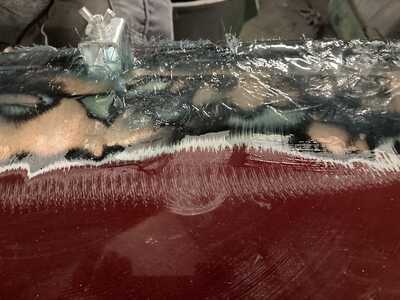

So I’ve discovered that fiberglass work is much like baking.  Exact measurements of ingredients and temperature are critical.  Drying time has been slow due to temperature being lower than optimal.  A propane space heater is now supplementing the wood stove.  Today the inside of the cracks were coated in the initial repair area.

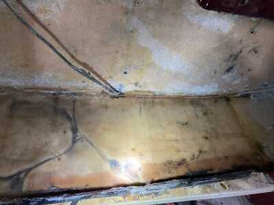

(@chloespop)
Posts: 105
  1.
    IMG 8917
    IMG 8921
    IMG 8915
    The tub repair is now 20-25% complete.  The bike side of the tub is once again in tact and rigid.

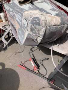

(@chloespop)
Posts: 105

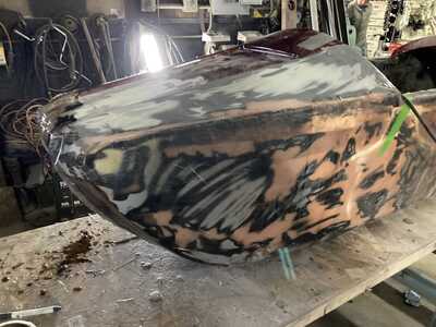

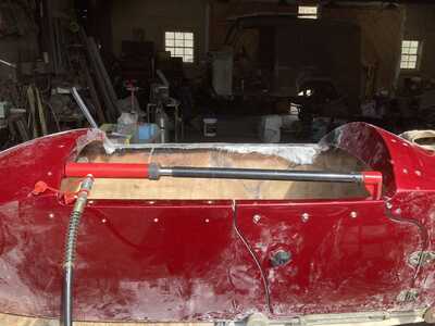

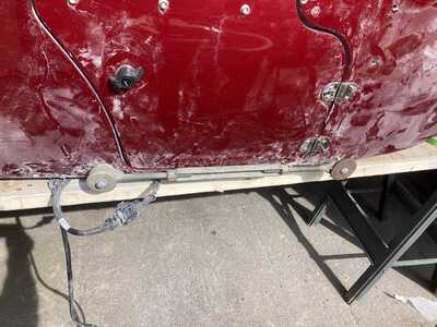

What we did today in sidecar school.
in order to get the door lined up before fixing the fractures in the floor we used several tools around the shop and some that were made.
1. screwed the floor of the tub to the work platform
2. very gently used a port a power to move the right side of the tub forward and then released to get pieces to line up.
3. once that was done and upper door gaps checked, welded bolts on a bar and drilled holes in the tub.  The bar was inserted to hold the tub in place across the upper door area.
4. drilled holes in the tub and bolted a turn buckle across the bottom to pull the tub in place and adjust the lower door area.
Remember the tub was almost broken in half and we are completely rebuilding the front half of the tub.  A lot of time is being spent figuring out how to move, line up and reconnect pieces.
One thing for sure is the advice from from boat repair shops to buy a new tub would have save money if I wasn’t doing it myself with the help of a friend who is an experienced body man.  He is a young 85, has all kinds of ideas and unique solutions to the problems.
Phil asked me today if I thought I could’ve rebuilt the tub without his help.  I confidently told him that I could’ve rebuilt the tub but it would’ve taken me 4 years.  I’m having fun a learning so much.
today we will be repairing the front floor area and the fracture that terminates at the bottom front of the door post.

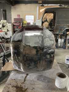

(@chloespop)
Posts: 105

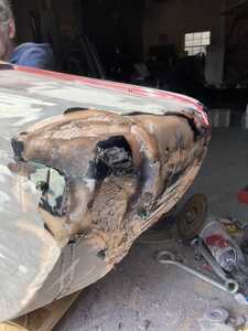

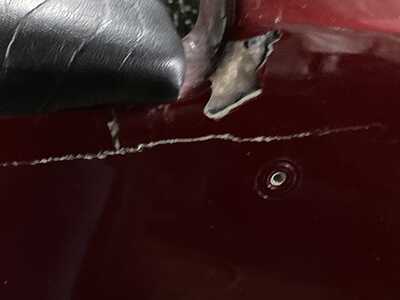

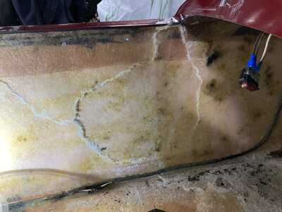

Thank you for your comments and suggestions.  I had not considered reinforcing with the aluminum strips as you mentioned.  I think your suggestion would definitely help me in the floor where the side car mounts to the frame and the area around the floor vent.

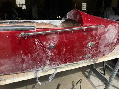

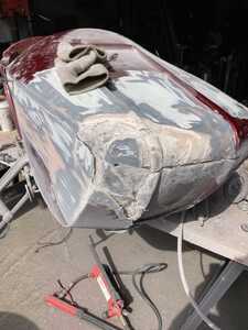

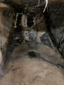

Today we pushed much of the nose back into place, ground away loose material and screwed pieces to wood put on the inside of the tub.  We worked on the floor grinding away damaged fiberglass and applying new fiberglass glass.

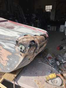

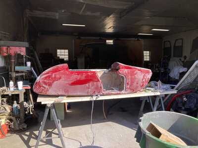

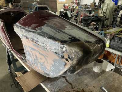

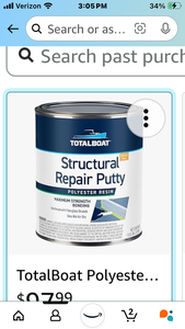

Damp cool day today, resin was slow to dry so we could only do one coat on the outside and inside of the nose.  Tomorrow should be the end of the fiberglass/resin work.  Next phase will be the refinement of the body using “tiger hair”, long strand fiberglass body putty (see photo).
