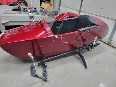

Dave, we have a nice clear pic of the right side of the bike (Post 1).  How about a similar pic of the Avenger's left side, and a pic of the mounts you have?  There are some clever guys on here and you might get some useful suggestions.

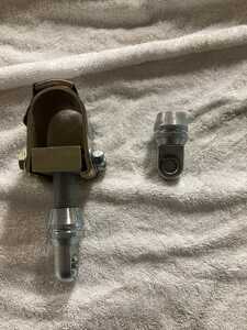

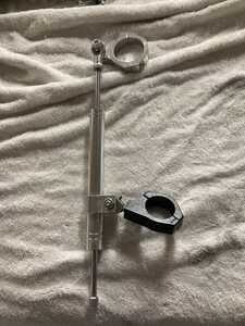

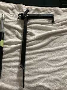

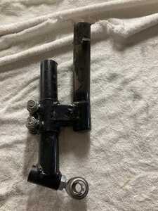

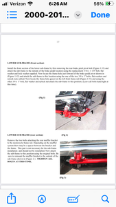

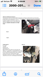

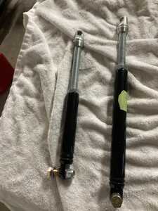

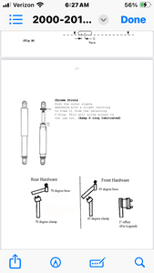

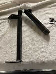

Below I posted pictures of the sidecar that includes the mounts that were on the other bike, photos of my mounts and some from the manual.  There were 4 mounting points, 2 upper and 2 lower.
I have the front upper mount for the bike and the pieces for rear upper mount.  The two lower mounts will be the challenge.

I wish I could be there to pick up those pieces and look at them.  From the pics, it looks like you have two pieces that make up the lower subframe for your bike (IMG 8415 and IMG 8419). But they don't really match up with page 10 from the manual.  Are you sure that manual is specifically for your model and year Harley?  Or that the mounting parts are for your Harley?  If the lower subframe parts are incompatible, seems like a decent welder could knock up what you need without having to buy the entire kit from Champion.
