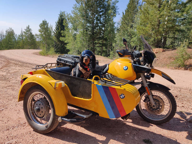

Posts: 1221
Good tires, and full fairing sure makes for a better wet weather ride.  Hard to beat a Goldwing rig when commuting.  Good power, great reliability, low maintenance, enough road presence to be taken seriously by other distracted commuters, but still fun to get on a twisty road.
I've found sidecars are additive and addictive, but not necessarily a replacement for two wheels.  If you can keep both a sidecar and a motorcycle of some type you most likely will enjoy both.  If you can only have one or the other, that's a bit tougher decision.  Maybe leave it up to your dog to decide.  That's what I did, and it has worked out great. 😎
