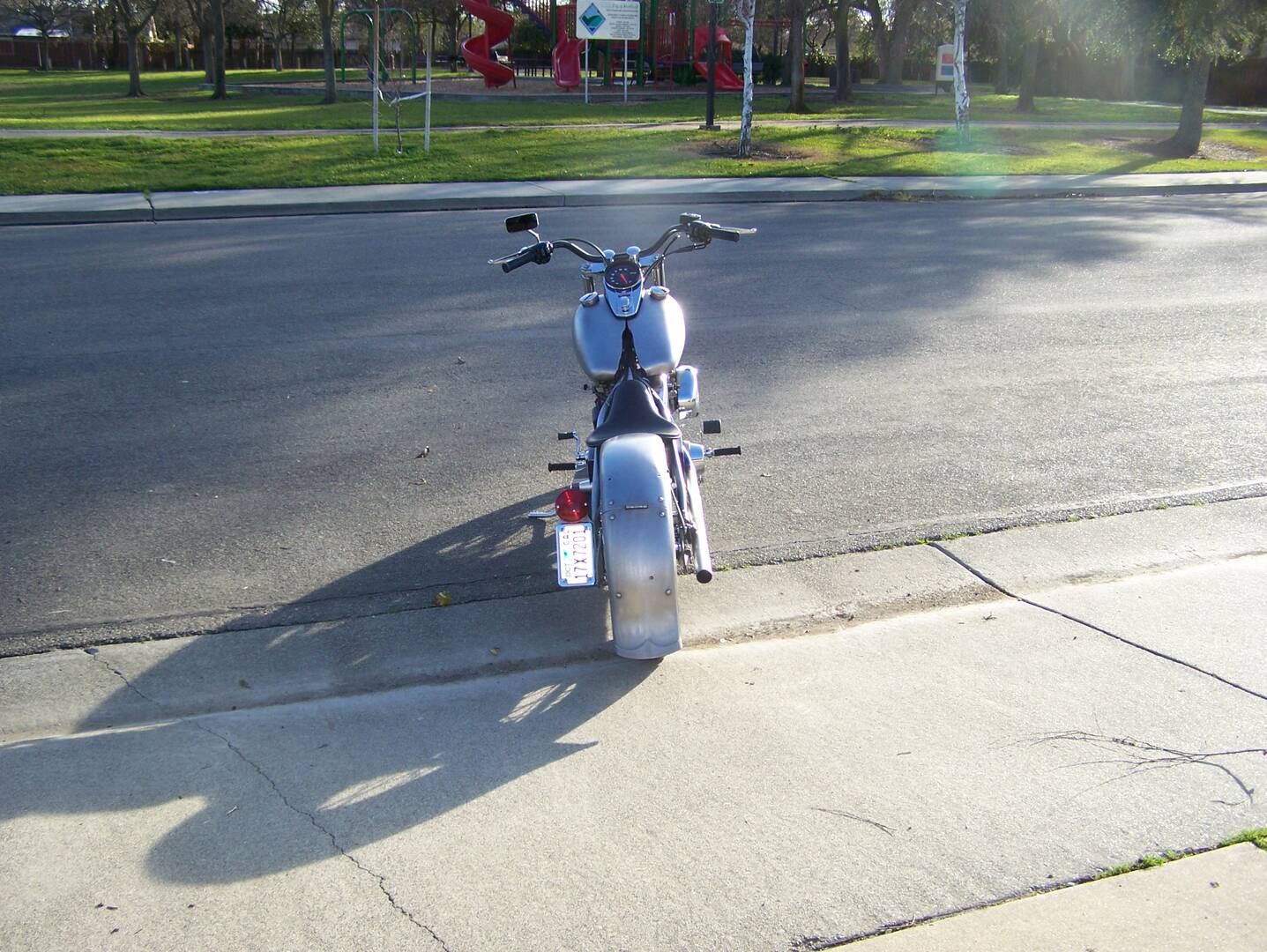

The funny thing is that in order to get a hand built motorcycle registered here in California, the process ends with an inspection by the Highway Patrol. They are really only concerned that you are the rightful owner of the parts used to build it. If it passes. they install a state issued VIN to the bike.
This is the third bike I've been through that process with. It is registered as a 2006 SPCN (special construction). Here is the rear lighting it had back then, one trailer light, also no speedometer, no turn signals, (there were mufflers on it when they inspected it).
I earned a few speeding tickets on other bikes, but I've never been stopped riding this one. I did have giant Yolo County deputy start checking the bike out once when it was parked outside a drinking establishment, but we just talked about motorcycles for ten minutes while I sipped a beer, he was cool with it.

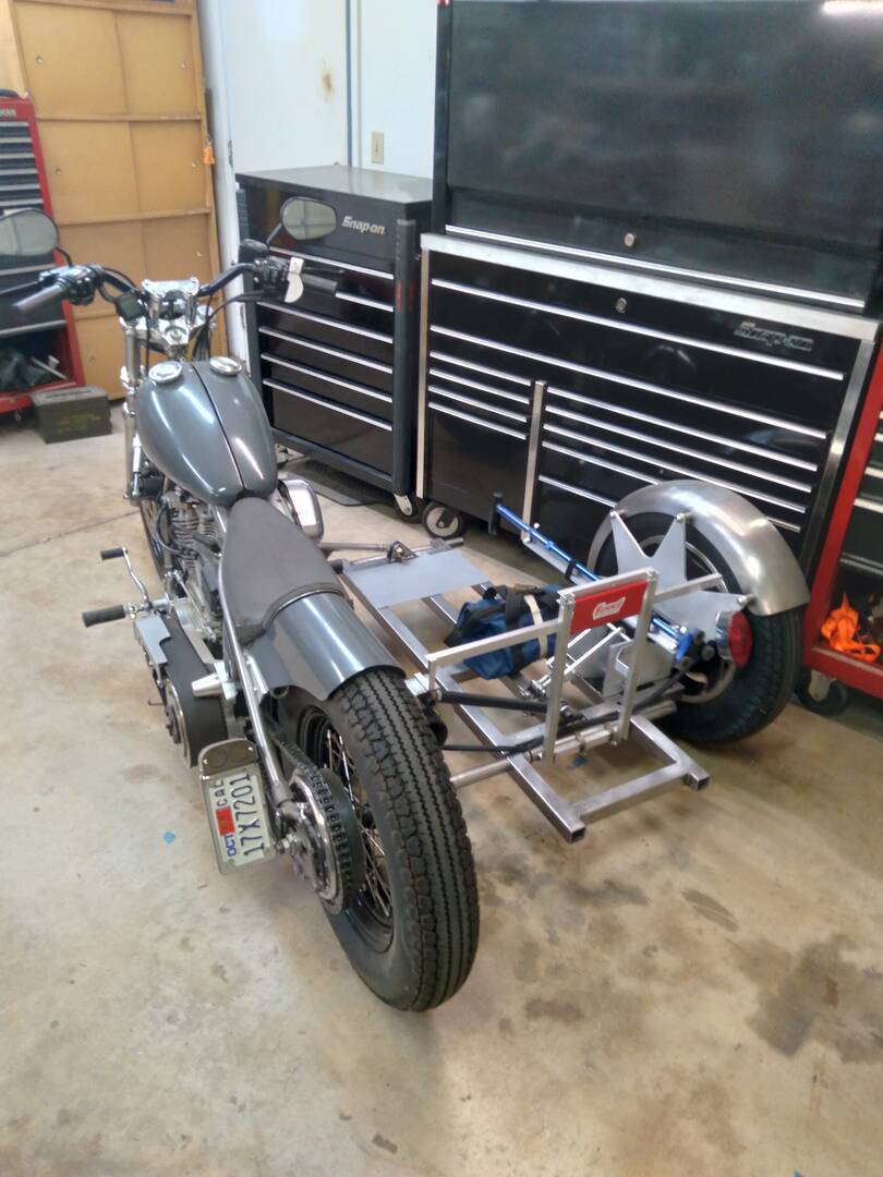

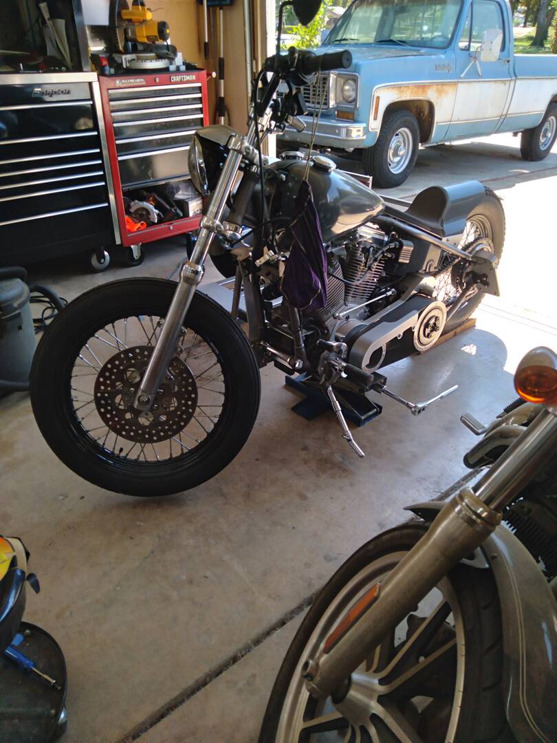

Small update. This Summer was slated to complete many tasks that heretofore I have been unable to physically perform, so this project took a backseat. I have taken a few short jaunts on it when time allows.
A couple things added to it, a 15lb bag of tools, a small platform for my foot because the modified leg needs to move around sometimes, my Hurri-cane and mount, and because of the void between the bike and wheel, a visual space filler for the 5 ft tall people in 8 ft tall pickups, with a red thing that flippity flops to grab the attention of the Jeff Spicoli types.
All the little rides have been right turn only routes, and the wheel has not left earth yet. Almost spooky, as the narrow chassis would lift the wheel just by looking at it. Being that there is a certain physical law named for me, it's hard to believe I nailed the width and weight of this right off the bat. I'll keep trying though.
I did succeed at blowing the other fork seal of my e-bay fork though. So a rebuild with genuine Japanese parts is happening soon.

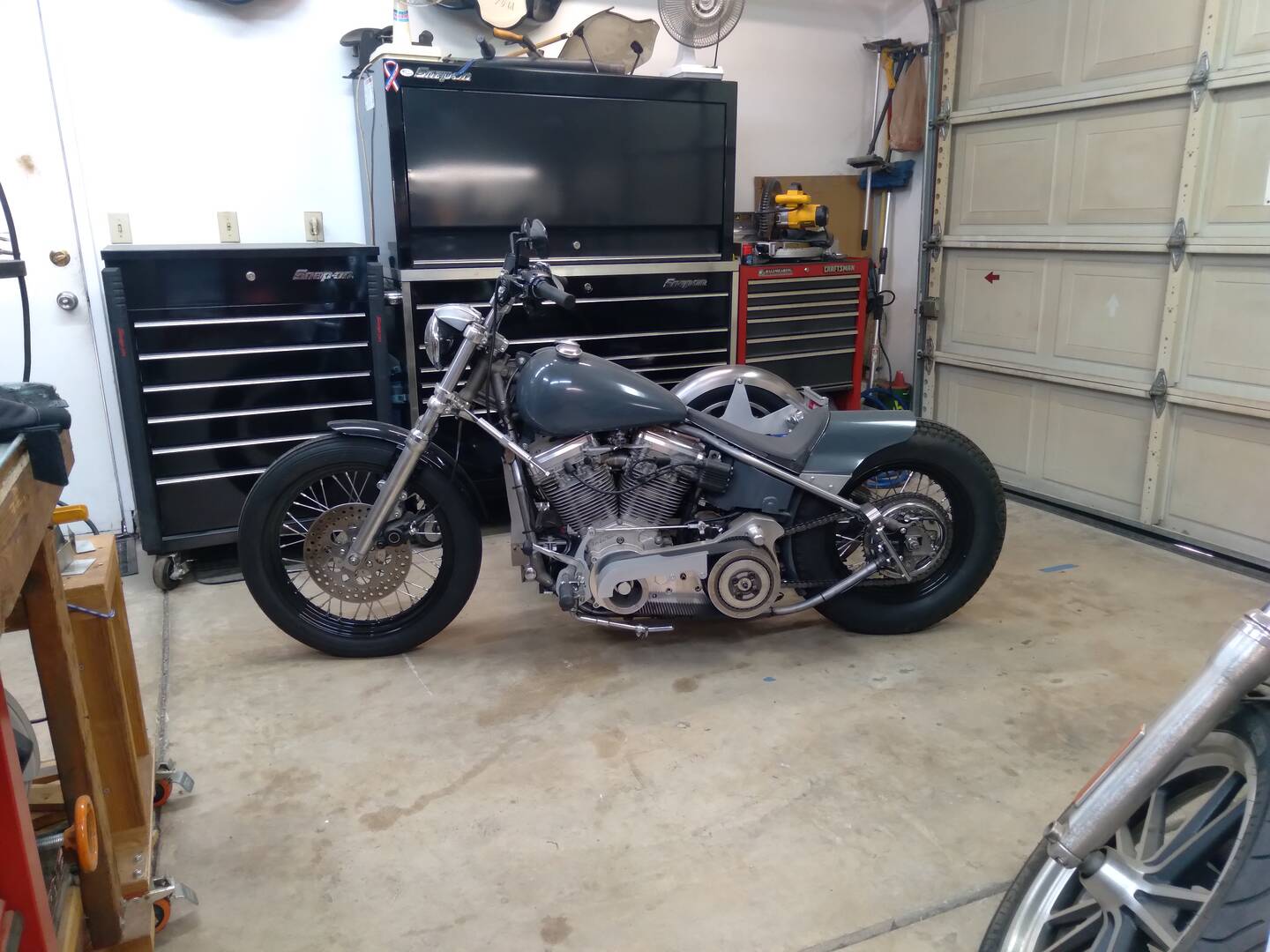

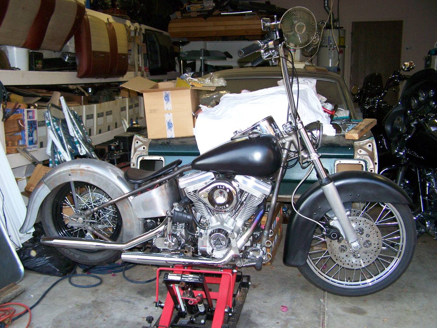

It's actually 20 years since I first built this. Having too much fun, I broke the swingarm frame this engine was in, and tore the spokes out of the hub. So why not at 47 yrs. old, build another rigid. New frame, wheel, and some other stuff. Presto, new bike. Titled as a 2006 SPCN.
Forgive the chaos in the garage at the time, all 4 Sons were still living at home.

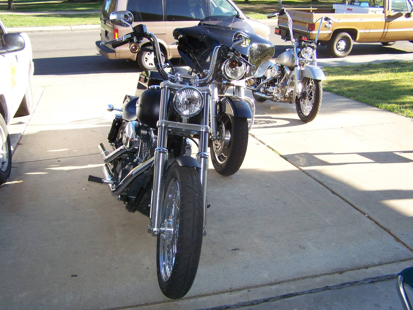

Our line up at the time, all 2006 bikes. My Wife's Dyna that she had to stop riding when MS weakened her too much. It is also the bike I was nearly killed on in 2016. My bagger that was stolen in Jan. 2011 with 80k on it. Parts from both of those bikes are on the current rig. And the first version of my current bike.
My only magazine appearance. I kind of cheated, the mag was based in our town at the time, so we knew the crew. I made it in once, the Wife, about 7 times! She's much better looking though. Happy birthday Little Bike.

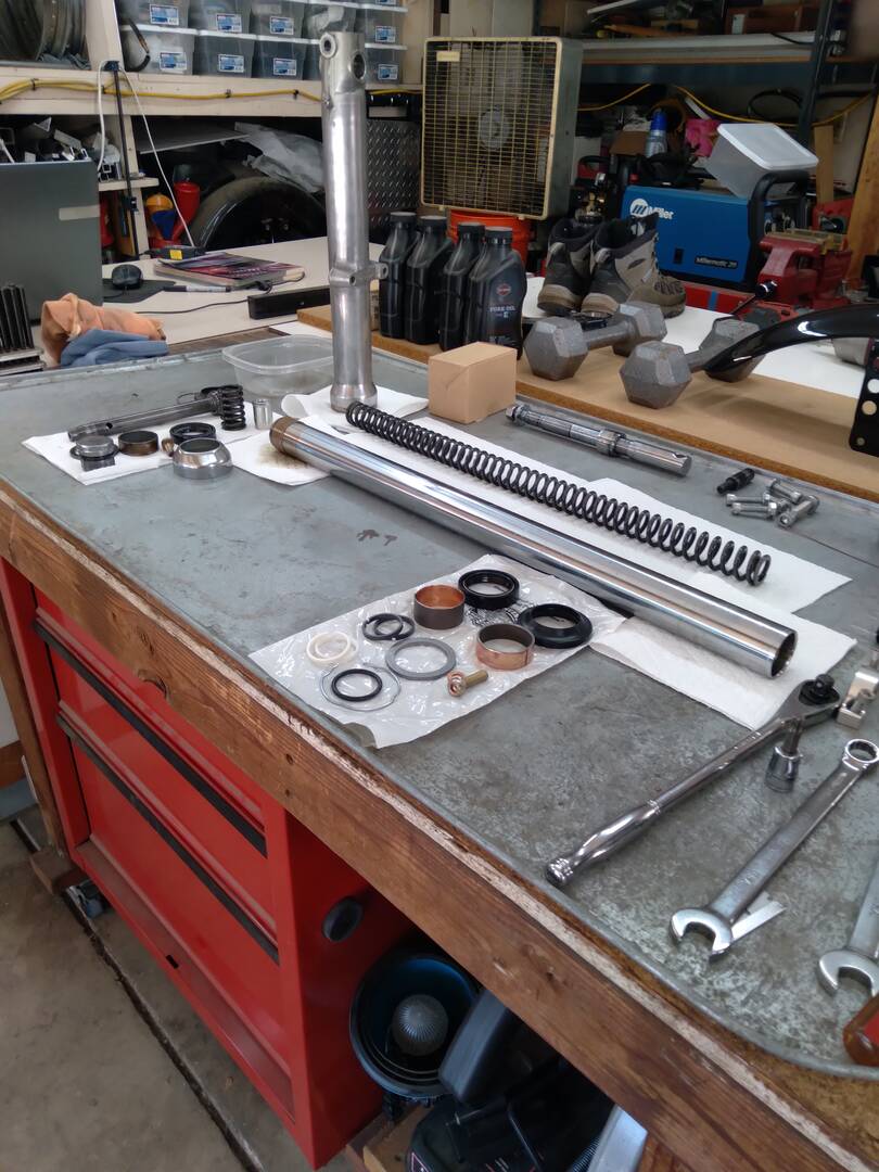

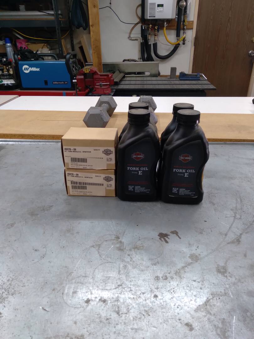

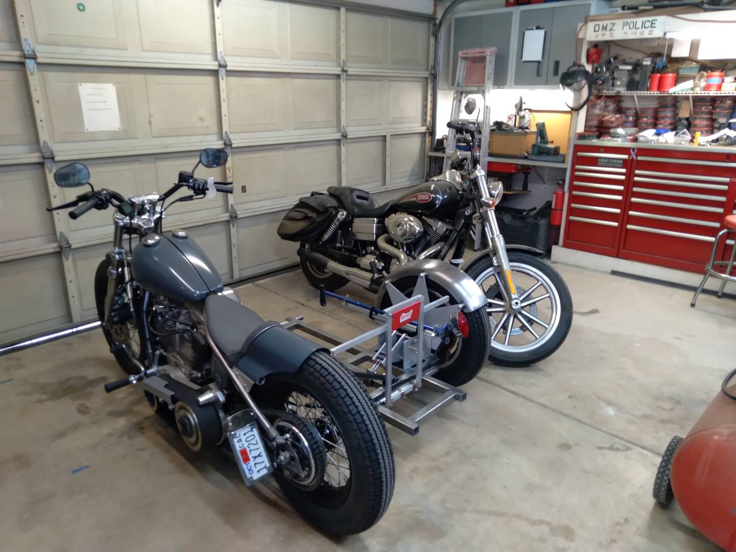

Fork rebuild, three wheels sure make it easy to park on 2x4s and a jack. Checked fall-away, balanced wheel too. Built the wheel years ago, e-bay hub, spokes from my Wife's wheel, and a rim from Germany. Don't remember why I didn't balance it though, all better now.
On to the rebuild. Odd tech tip. Crown Royal pouches are great for hanging calipers in. Had a service manager who drank the stuff like I drink beer, he brought a box full of these in one day for us to use.

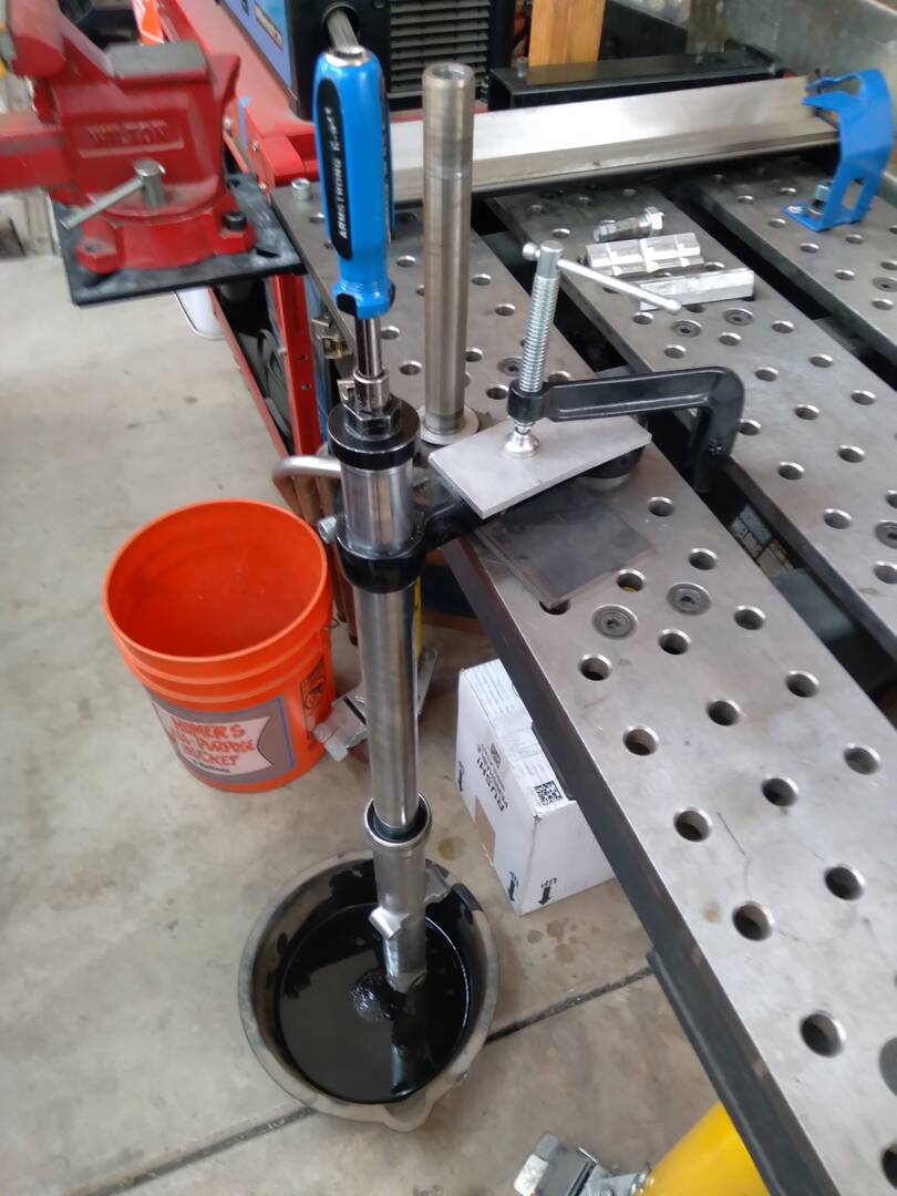

My small victory this morning. I've removed hundreds of fork sliders from Harleys, and uncooperative damper bolts are not uncommon, this one was a bear and got drilled the entire length before it came out. But this was the first time doing this that I wasn't on the clock (especially a flat rate clock), losing money. It was quite satisfying. #thisbudsforme
