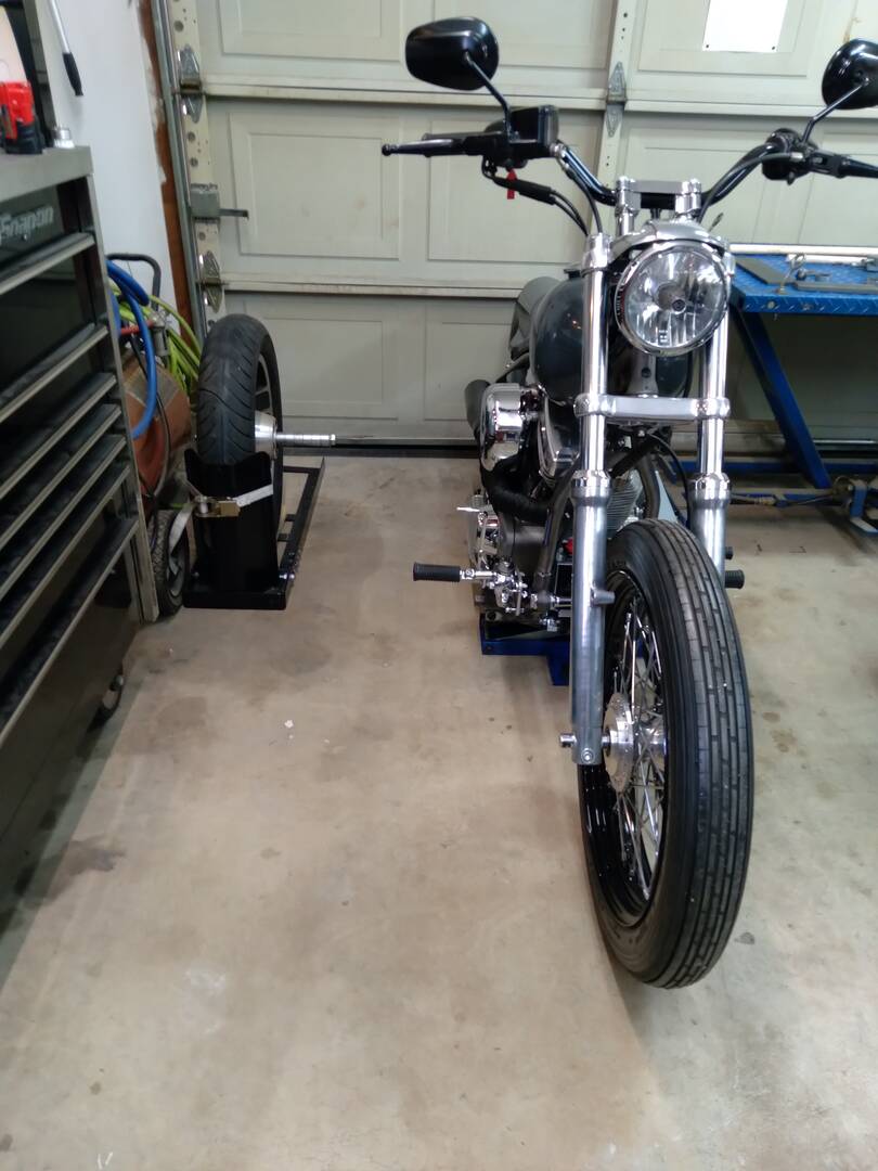

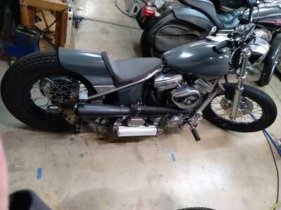

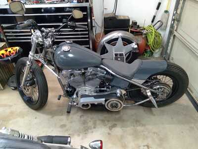

Thank you. This is the bike I mounted it to. It has a 100cu.in. aftermarket engine and a 6 speed transmission. The frame is a stock dimension, reproduction 1948 Harley, so it has factory sidecar mounting lugs. I utilized those, but I didn't mimic the factory mounts. I estimate it weighs about 500 lbs.
It truly is a training wheel, built just for short rides in town to test the foot and hand control mods. The lead measurement I picked out of a hat, I wanted that wheel in my field of vision so I wouldn't forget it was there.
Handling, well I was a bit shocked that it handled so well, no head shake, very easy steering. Although it has only been up to 50 mph so far. When the wheel lifts, it has been very easy to get it to land.
Since it is a rigid, on rough pavement, the rear wheel, (and now the other wheel) will bounce off the road and dance around, but I probably have around 20k miles on it (this has always been a play bike, not one of my commuter bikes) and my first Harley that I had for 12 years, was a rigid. so it seems normal to me.

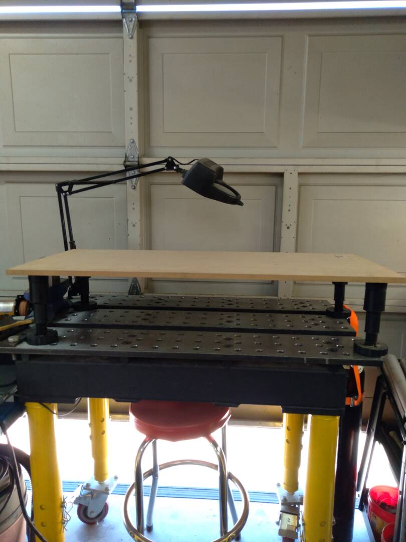

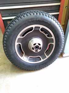

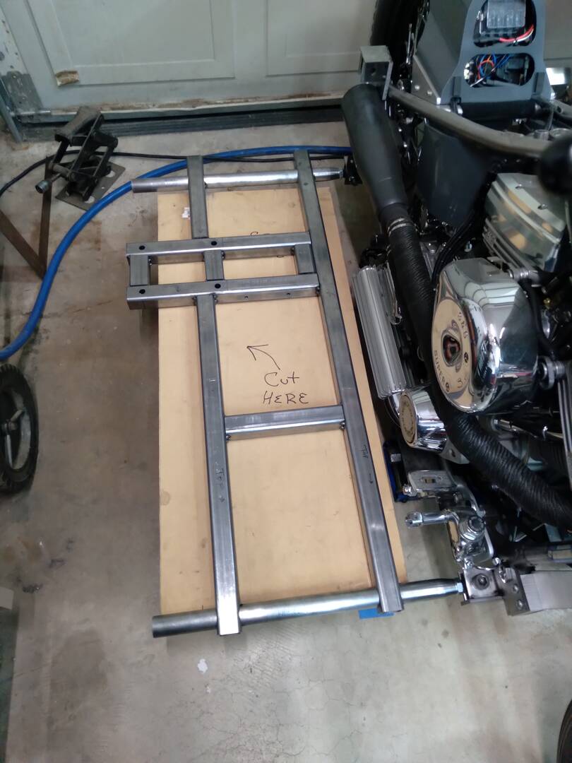

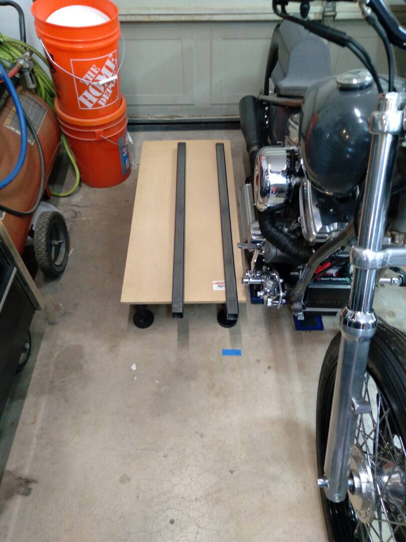

I started with the one inch rear axle from my Wifes Dyna, and the front wheel from my Street Glide. I had done swaps to 25mm wheels on both bikes so these parts were out in my shed. I later installed a tire that matches the bikes rear tire.

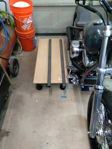

Garage floors are not level, so I built an adjustable height assembly table. Just a piece of MDF, and plastic adjustable feet from Closetmaid.
I didn't build the bike for this, so I had to work around things I didn't want to change. Like the exhaust I had spent many, many hours building.
The table helped to locate where the lower mounts would go, ground clearance was set at 7.5 inches.

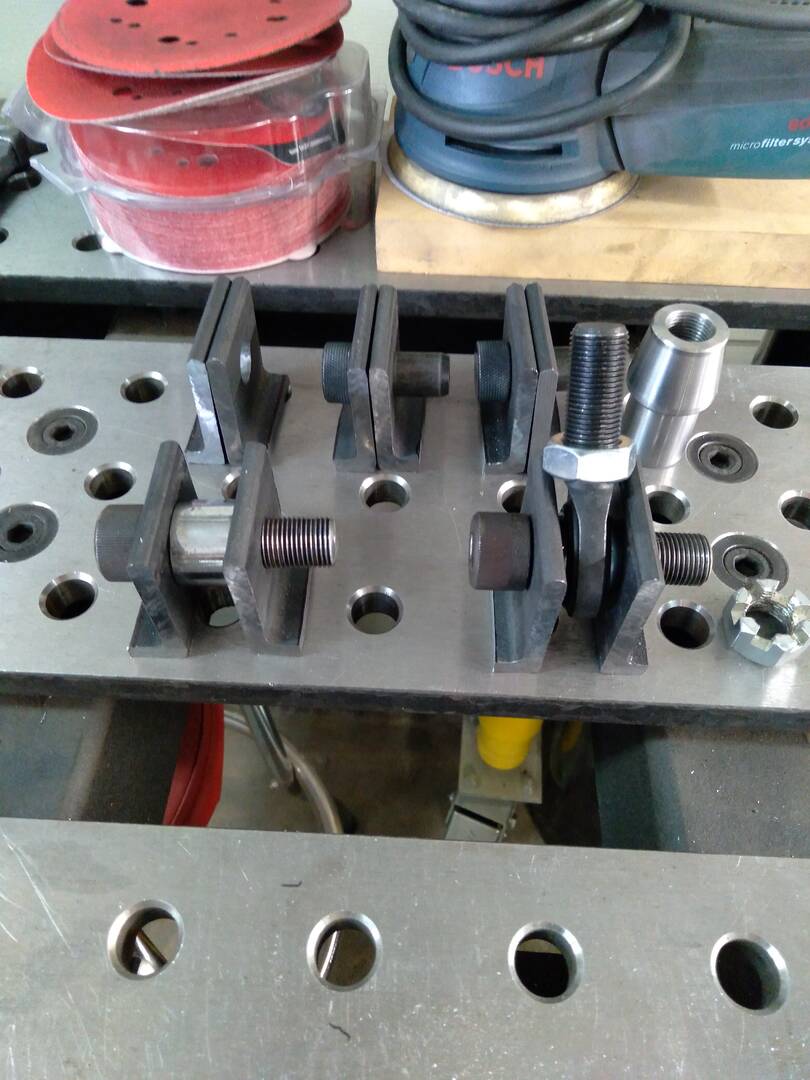

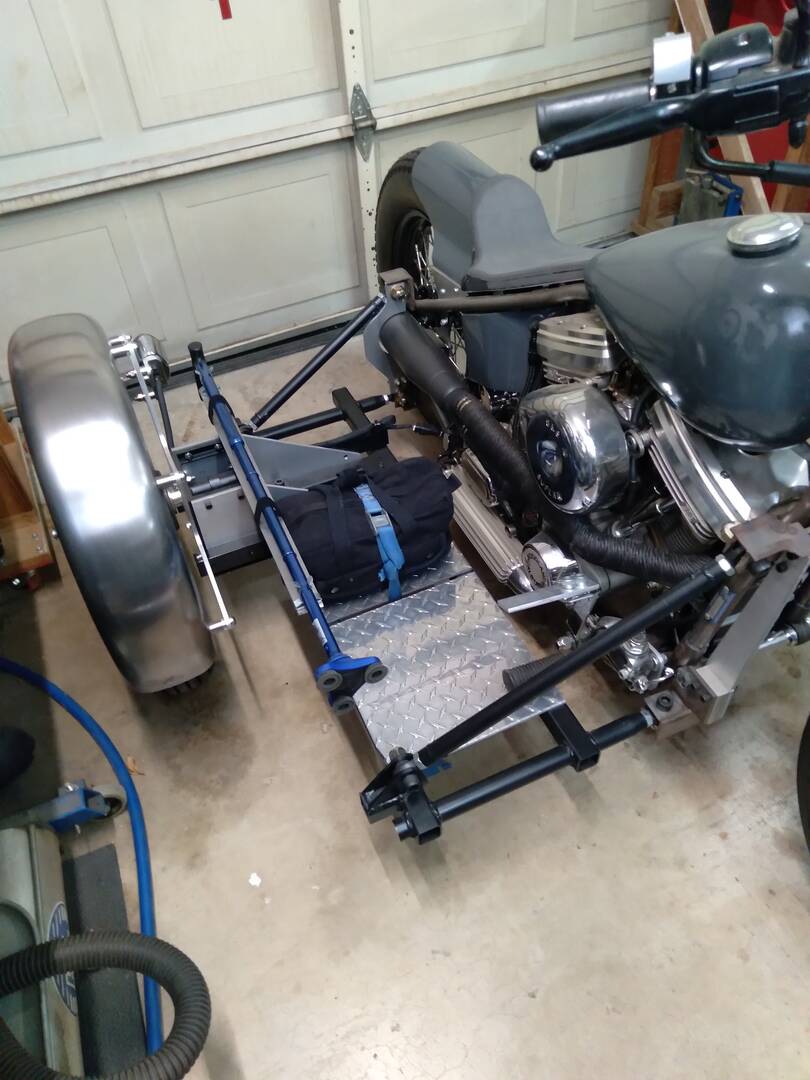

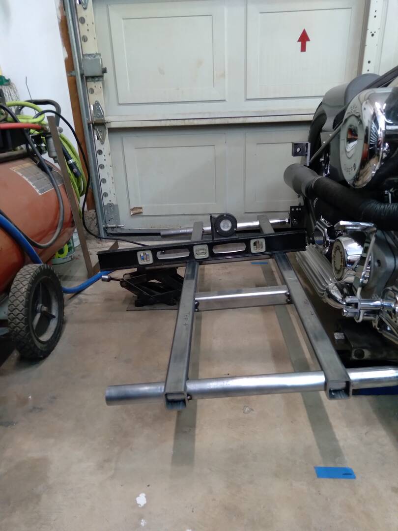

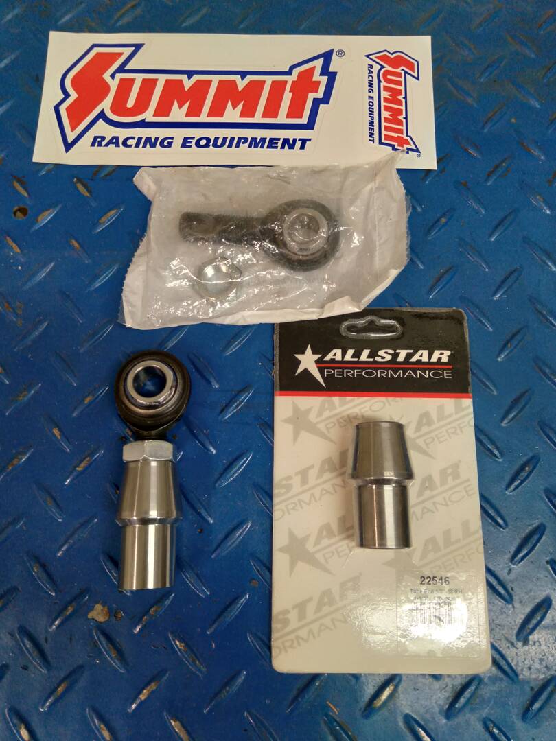

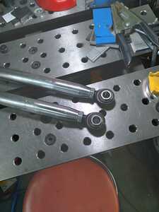

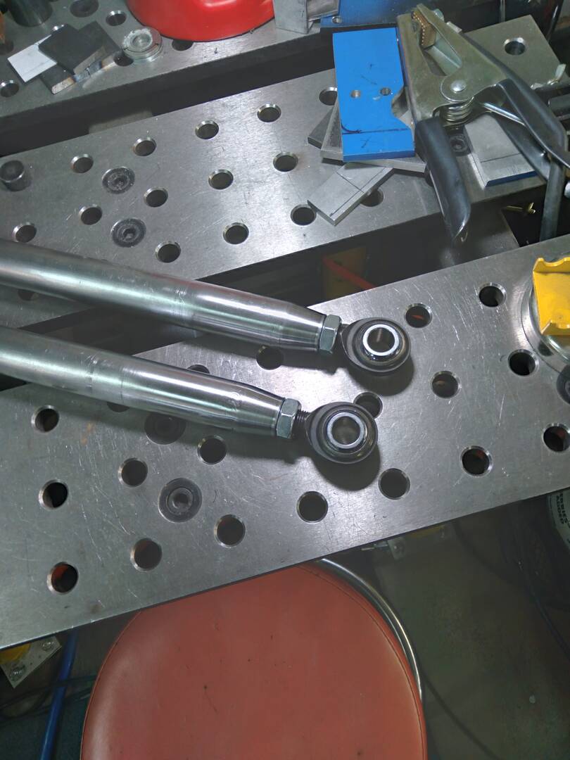

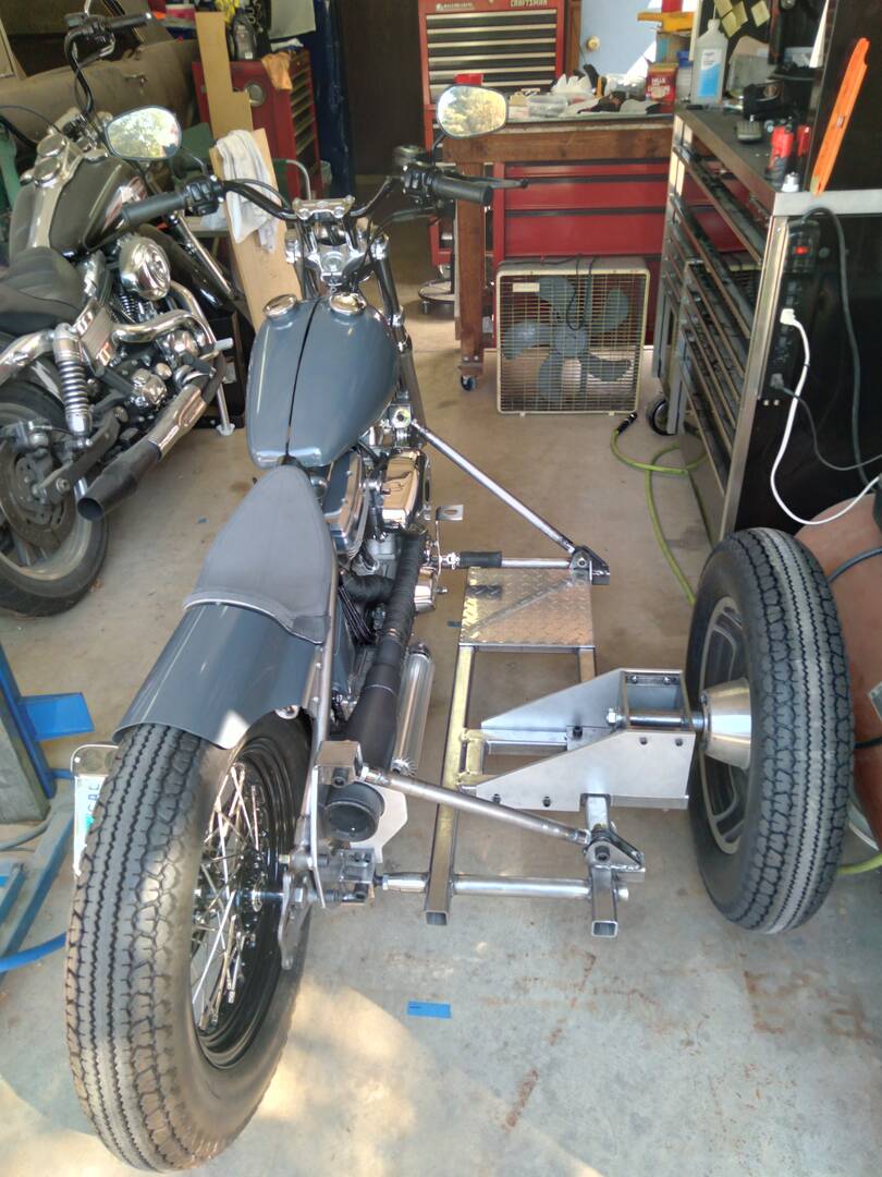

Well, while I was lacking in my knowledge of recommended width and lead length, I was aware for the need of alignment adjustments. So when I rendered this in PAD, I designed it with adjustability for lean out, toe, and the axle block is adjustable for camber and height. I was a Combat Engineer in the past, but never a mechanical engineer, so I did my best imitation. There are six 5/8" spherical rod ends holding this on the bike. Since the basic chassis is one piece, no slip joints, u-bolts, or clamps, and the bottom 2 chassis to frame mount rod ends are clocked 90 degrees from each other, there is 0.0 movement fore and aft. But they do have movement up and down for alignment adjustments.
The link bars from the upper mounts to the chassis are unequal length, at different angles, and triangulate inward to their mounts on the chassis. It all assembles easily, nothing is really bound, they all just work against each other in the mounting, so there is 0.0 play in the chassis when mounted.

Chris, your head was in the right place when you designed and built this. I like what you have done, and that you think 🤔 🧐

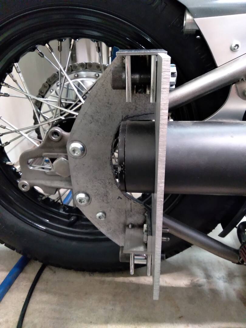

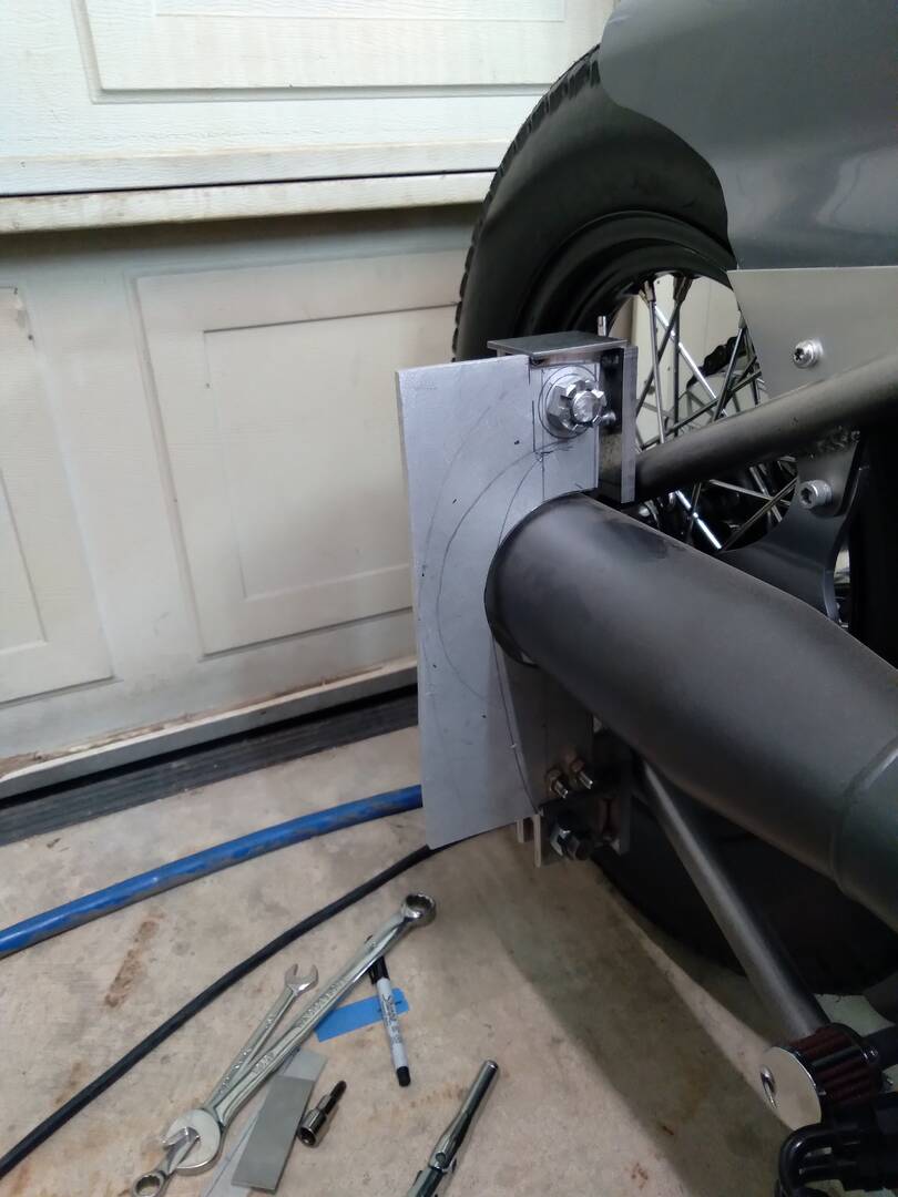

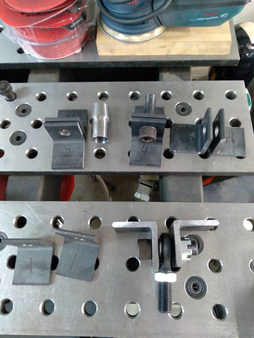

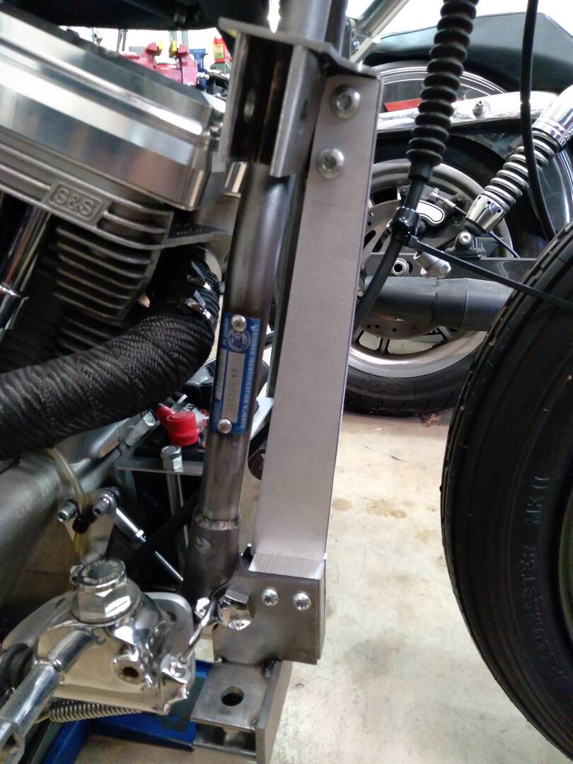

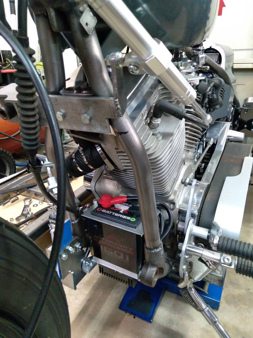

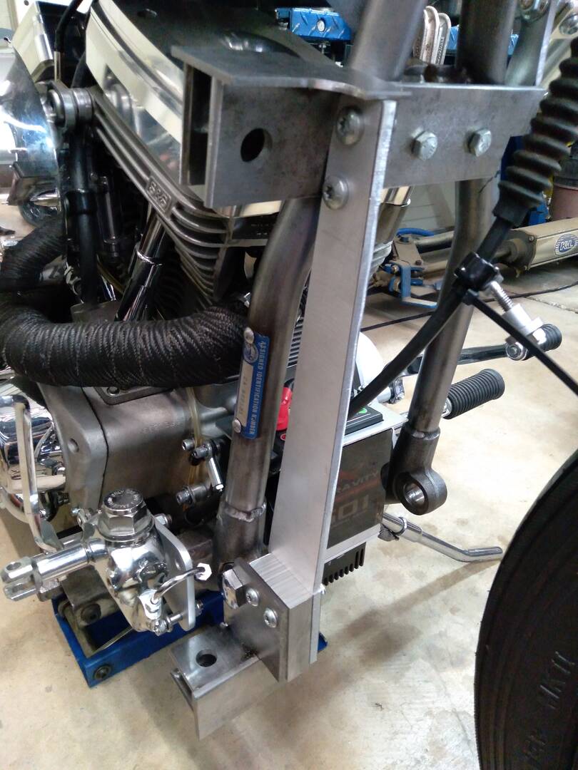

The bike side mounts. The pics were taken during fabrication. Before my involuntary retirement, I made my living working on other peoples motorcycles, I was not a metal fabricator. It is something I got into after losing half the use of my hands, including the MIG and TIG welding. I also have minimal fabrication tooling, so whatever I make is very rudimentary.
All of them bolt on, no mods were done to the bikes frame. The upper and lower mounts are tied together, and the front upper mount includes a steering damper mount.
The rear mounts are pretty straight forward, the plate just needed to dodge the exhaust a bit. The front mounts had to get more elaborate since I wanted to use the factory sidecar mounting locations. All critical fasteners were replaced with socket head cap screws and grade 8 nylock nuts at final assembly.

Kind of like exoskeleton, then?  Since you don’t have a passenger on the side, mounts don’t have to handle the forces associated with that shifting mass altering the center of mass on the right.  Boy does that make it a lot simpler!

(@scott-h) Thanks, the frame is something I started using in 2006 after this engine broke the shovelhead frame I had it in first (the bike is registered as a 2006 SPCN) I've never had the heart to paint it, as it is the only fully tig welded reproduction frame I've ever seen, in fact the bike has spent it's life in bare metal until recently. Just scotchbrite, WD40 and wax.
The side fender is part of my ballast program, it is very thick and with the four threaded bungs for mounting, it weighs over 7lbs. The first test ride with the bare chassis and wheel it weighed 100lbs. I have added 55lbs. of ballast since.
The engine is unique, a 100 inch 4x4 that S&S made to fit in a shovel frame. Much shorter than a standard evo, and tilted 3 degrees forward. I purchased it in 2003. I've done thousands of test rides on customer bikes and this engine is the smoothest v-twin I've ever ridden.
