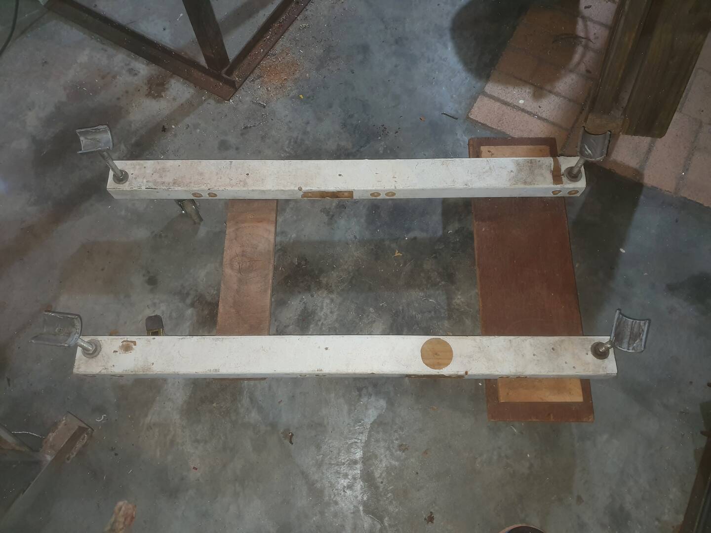

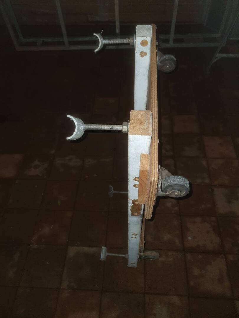

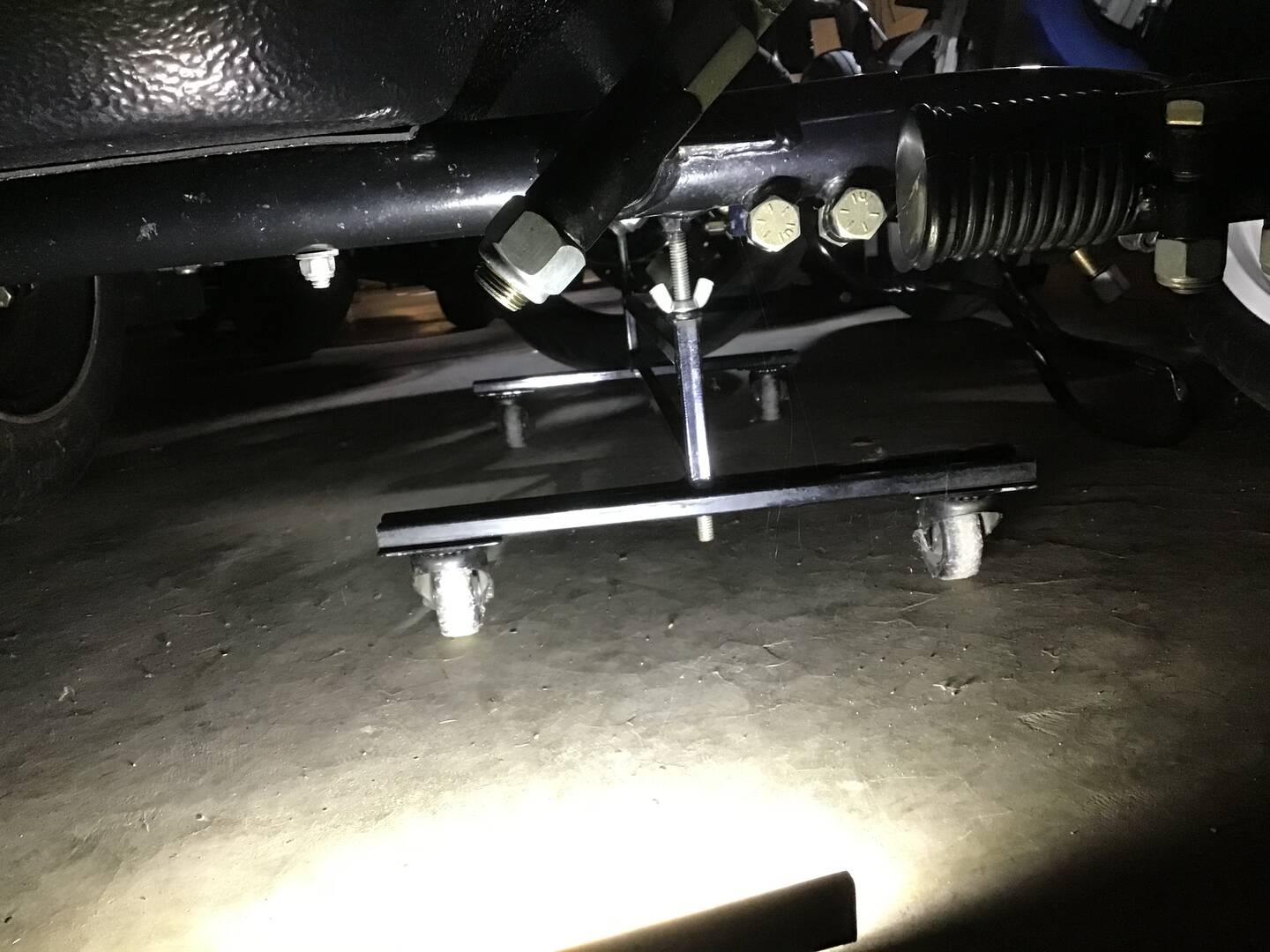

I have a support trolley/dolly i made mainly to aid in setting up the sidecar.
I can adjust height and roll it around as needed.
As Miles was saying though it generally is less than ideal trying to fit/remove a sidecar unless needed for servicing purposes.
My dolly is just 4 pieces of timber in a rectangle with castors under the corners and threaded rods with welded half circle brackets on top to pick up the chair frame.
Simple and cheap to make.
Will see if I can remember to find it and take pictures.

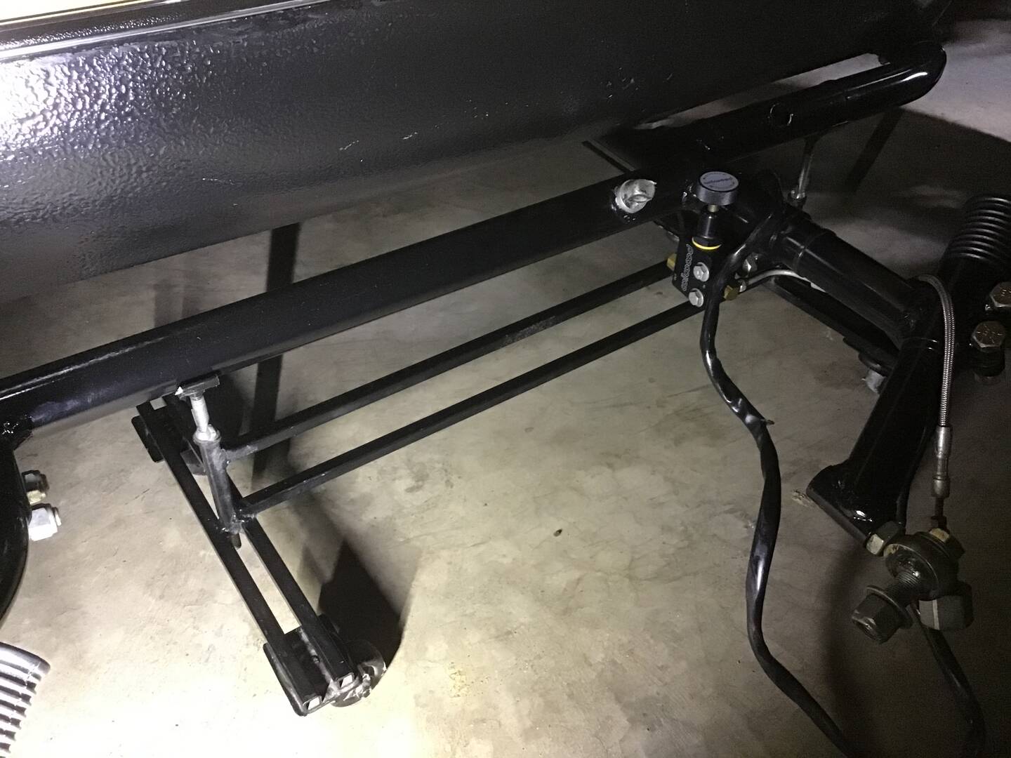

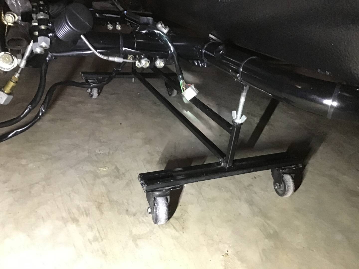

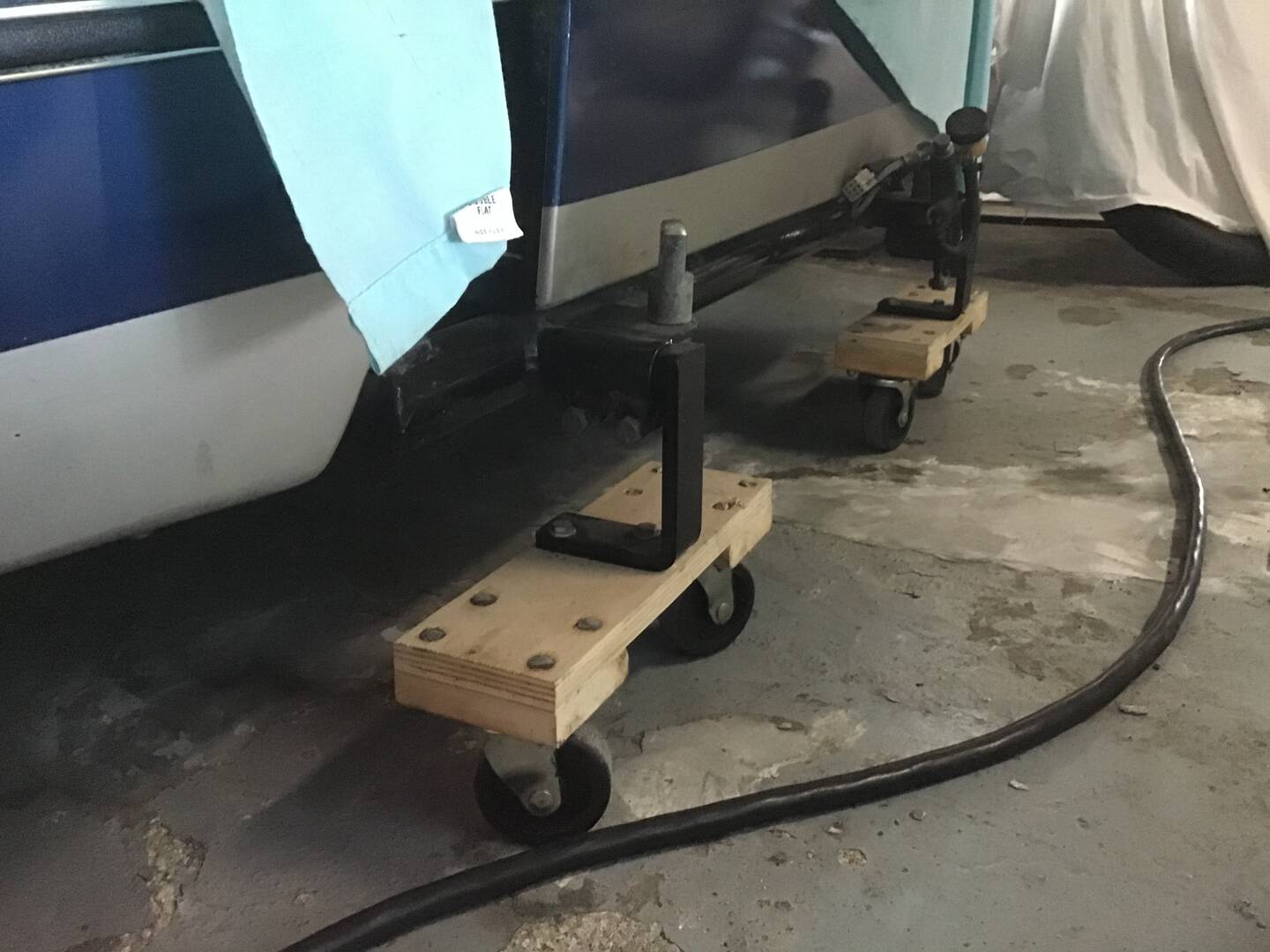

Here a couple set ups I have. One for short term and one for storage. And I drive my bike either 2 or 3 wheels, also ones with 4 wheels. I have no problem driving them either way. I also have matching solo bikes for all the rigs except one. Over the years I drove many different style bikes from stretch-out choppers to sportbikes.
IMG 3198
IMG 3197
IMG 3194
IMG 3195
IMG 3196

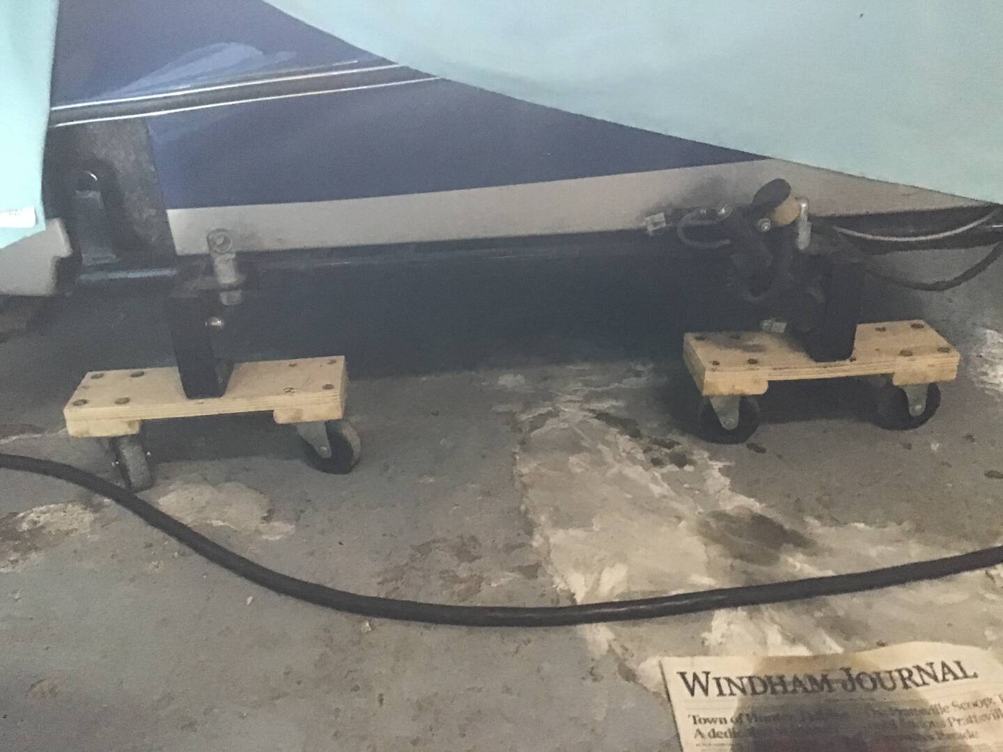

Posts: 730
Bits of timber and ply scrap.
4 castors.
1/2 inch witworth threaded rod with pipe halves welded.
Nuts and washers and there you go.
And a sunset.
Strange how pictures get re shuffled between  me picking them out of my gallery and when they appear on the post.
I clicked on the sunset last.
