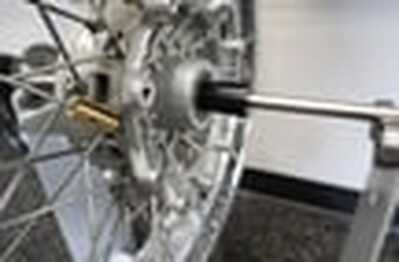

Well, now I suppose I must try some balance beads... for a test at least on my next (of course soon upcoming tire change._
I tend to like the brass weights that have set screw that clamps them on the spokes... have used them for years.
For what it is worth, I have installed quite a few Motoz tires on a couple of friends bikes (BMWs and KTMs), and they always seem to need a couple of ounces+ of weight when done, to get close to perfection.  I just line the dots up with the valve stem.  Maybe that is the heavy spot instead of the light spot?  Who knows.  My friends seem to like them; I would run one if I couldn't get a Mitas E07 Dakar.
The Mitas E07's typically take about 1.5 ounces sometimes a little less.

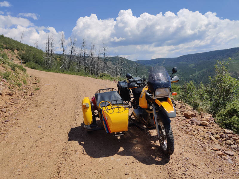

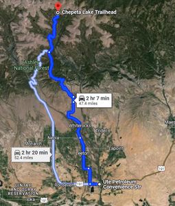

Took a fun ride up the mountain today.  Fort Duchesne to Chepeta Lake in the Ashley National Forest.  About 95 miles of which pretty much half is a beat up forest road, half is nicely paved back country roads.  The forest service road sees a lot of traffic. Cattle trucks & cattle being driven down the trail to trucks waiting below, 4x4s, motor homes, 5th wheel travel trailers & horse trailers, etc..  It gets a lot of use.  Also it hasn't been surfaced in a few years, so there are getting to be some pretty deep tire ruts, along with half exposed rocks.  There is a lot of sharp 1/2" to 1-1/2" loose rock littering the road.  The Forest service road climbs from about 8K' asl, to just over 10.5K' asl in that 20-ish miles.  Plenty of opportunity to put some good power to the rear tire, and braking on the front tire.
Goal for the ride was to see how "tough" the knobs are.  I was looking for two things: front edge wear, and tearing/chunking/slicing on the knobs. So this was a very aggressive off road "romp".
Starting up the off road climb, there is a nice observation point looking south east over the Uinta Basin.  I like to stop here and see what new "progress" is happening in the megatropolis of Roosevelt, UT.  Lots of smoke from the fires hazing up the sky today.

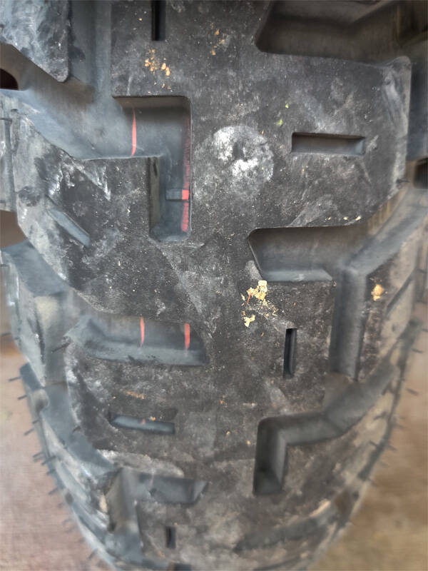

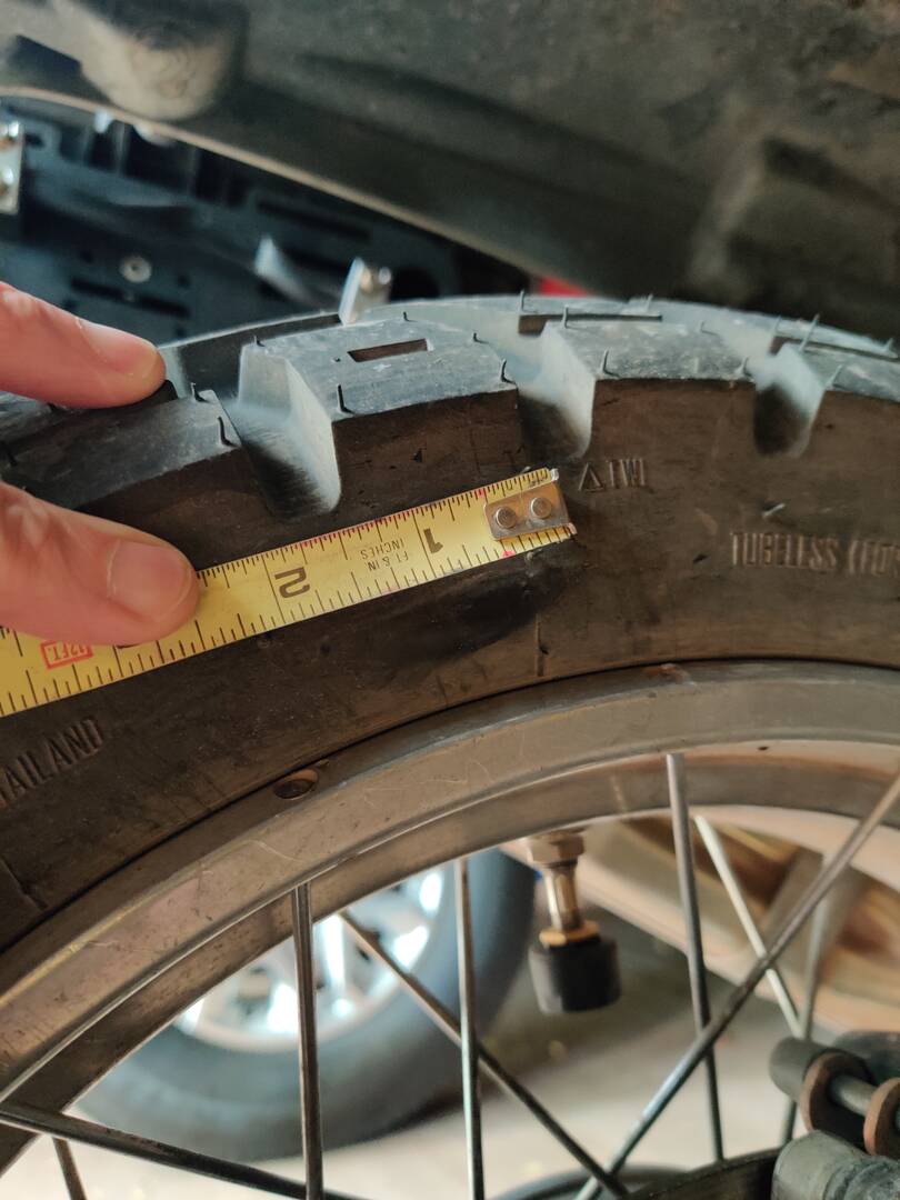

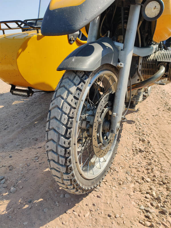

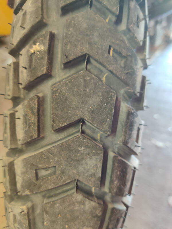

Back in the garage, I got a good look at the tires.  some slight edge rounding on the front and rear, but no slicing, tearing or chunking.  I was pretty aggressive on the ride up with the power.  On the way down I did multiple max front brake deployments in the nasty rock sections.  Well as "max" as I could with ABS (forgot how to turn it off... lol).
Another pleasant note is the lack of front end shimmy.  Managed to run out of gas on the way back right when i was being chased by two very aggressive pooches.  Coasted as far as possible past their "territory" so as not to be eaten (it was lunch time by this point).  From 50mph to zero mph, and the only wobbling was my knees from fear.  Handlebars were rock solid.  Front tire is brand new, so it is happily as expected.  Will see how that works as the tire wears and eventually cups.   Dumped in the reserve can of fuel, fired up the bike and headed home with all body parts intact, and no chunks missing.
Front edge wear
Slight edge wear
Now that the front tire doesn't have the hum of being worn out and cupped, I get a somewhat higher pitched sound.  Due to hearing loss, I can't tell if it is gear whine or coming from the front tire.  Next job for my good friend, neighbor and part time "Monkey" to help figure out.  Rear tire is so darned quiet and smooth, it's a bit spooky.
Noticed the bike doesn't roll around by pushing as easy as it did with the E705/ATR-K Ecoterrorist/Block-K combo.  Not sure why that is.  Will be watching fuel mileage to see what happens there.  On the street, the front end doesn't seem to push as much as it did.  So maybe softer stickier rubber????
Finally, I've noticed the tires do a very nice job of absorbing small harsh hits.  Again, will see as the tires wear how that maintains.  I would expect the rear tire to continue that trait due to the sidewall being 1/2" taller than the old car tire that was removed.  Front tire the knobs are pretty tall, so wear may change.   Tires are too new to talk about grip.  Except to say that they grip as well as expected for new tires.  Maybe the front is a bit of a happy surprise.  I was a bit hesitant as it looks so close to the E705, and that tire even when new, slid around pretty good on the street.

Today's ride was a loop up around Pole Creek lake.  Probably half & half on/off road.  Same trail that leads to Chepeta Lake, except instead of turning right to Chepeta lake, Pole Creek lake is off to the left.  This loops down into Uinta Canyon which is tribal land.  So there is an agreement between the forest service and Ute tribe for a trail easement.  That is only the last mile or so of trail.  The rest is Ashley NF.
Decided to try the short off-road test track loop, and almost flipped the rig.  That was a bit spooky.  Off camber with sidecar up top.  Side car tire hit a rock and bounced up past the tipping point.  Was able to steer off the trail & down the hill, which created some other issues.  But eventually was able to get back on the trail.  This time I got the bike going, and put most my weight in the sidecar tub.  The other leg on the bike seat.  Kind of sketchy, but got me out of the mess.
Forgot I had been crabbing the bike with the old street tire to get through that part of the trail.  Pretty easy when the rear tire has little traction.  But the new Motoz tire is very grippy off road.  That makes for a more advanced maneuver with all the half buried rocks.  I'll need to practice up on some less rocky off camber.  Need to get a balance of front brake, power and body positioning to maintain a good crabbing attitude.  Might wait until the 37/11 final drive is installed.  That would help with a "snappier" power when the back tire is cycling between grabbing and slipping.
Any way, the tires did really good through the downhill ruts and washouts.  Plenty of grip to skirt the edges of the washouts without slipping in, so the rig was able to maintain a faster pace than previous trips through.
After that bit of fun, the rest of the ride was relaxing. Traveling up along the ridge line of the mountain a bit over 10.5K' asl, before descending into Uinta Canyon. Temps were beautiful T-Shirt weather up top.  😎

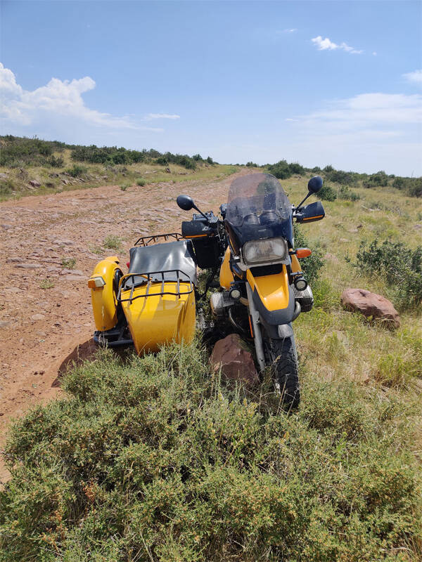

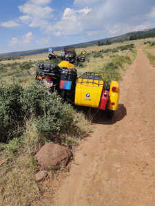

Here's the rock the rig cleared:

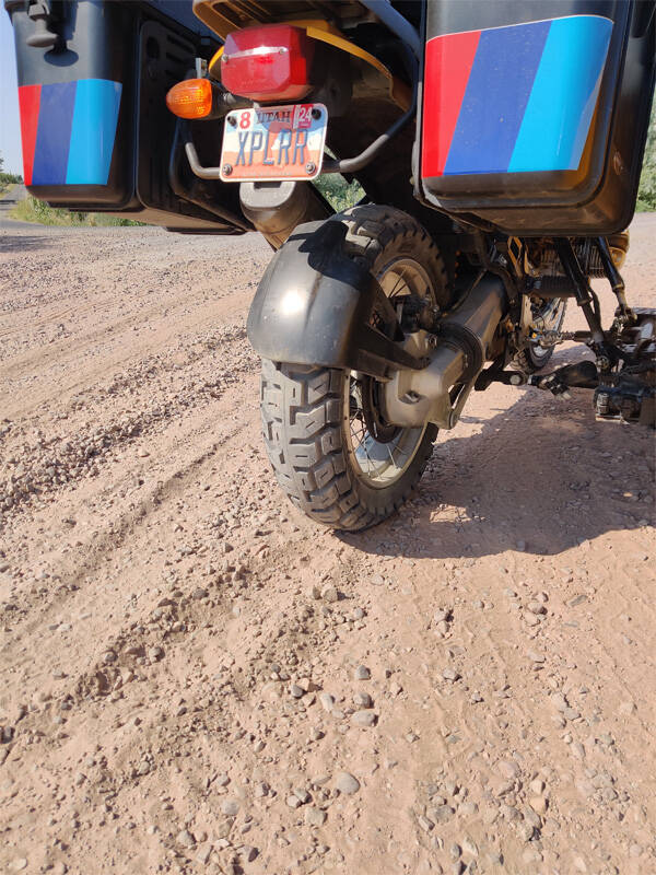

Crash Rear
Here's the one the rig moved about a foot (thankfully the soil is loose sand, or that would have been much worse).  Have to say with ABS turned off the brakes, scrub brush and finally the rock arrested the forward travel very quickly.
Crash front
Rolled the rock out of the way, got back on the track, and did a damage assessment.  No damage at all to the rig.  Some scrub brush was manicured, but that was it.  Back on the trail, come around a corner and see this beautiful gal.  From the size of her head, she's a Mustang, but taller than most I've seen, and looking very healthy.  I stopped shut off the engine to see what she'd do.  Settled back to a mid morning snack-out. Wary, but not interested in investigating.

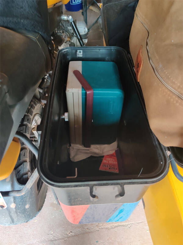

Lunch pale fits perfect on its side.  A couple of Therapy Gell packs out of the freezer to keep things cool without a mess.
