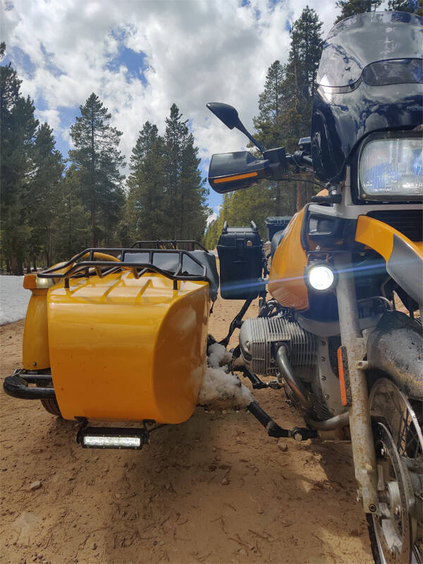

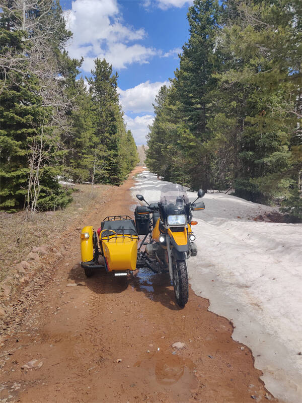

Thought it would be a great day to Head up into the Ashley N.F. via White Rocks Highway (runs north out of Fort Duchesne, UT).  A bit gusty on the road but once in the mountains it calmed down nicely.  Still snow above 10K' ASL, but not bad.  Forest service roads are pretty torn up from all the use last year, but passable.  Managed about 40 miles off-road.
Couple of pucker moments crossing big patches of snow that was covering the whole road, with the sidecar on the top side of the off camber.  After the big Summer Vacation Road Trip, the rig will get some more appropriate tires for off-road.  Thought I took more pictures, but this is all I found on the phone.  Hmmmmm?
Found two great Jeep trails.  One turned into an ATV trail, and I smacked the left side mirror and hand guard pretty good climbing a rocky hill.  Quite a workout steering through all the embedded rocks, and trying to keep the sidecar from flipping over top of the rig on the serious off camber stuff.  Next time I'll start the day with a bowl of Wheaties instead of oatmeal. 😉   Pretty impressed with how good the low end torque of the engine is.
Snow still covering half of main fire road above 10K' ASL.  Some areas in the shade still had about 18" across the entire fire road.  Got the rig pretty sideways a few times blasting through the longer snow covered sections.  😎
Snow Receding
The great Screaming Yellow Slushy Machine
Slushy Machine
Back home without any breakage. A quick wash and it will be good to go for the next exciting adventure.
Back Home

Scott @scott-h,  the one  item that I  recommend  for  your  rig is  to cover  those  two lower driving  lights  with a  YELLOW  film. On Amazon  you can  buy a 4" x 8" piece of  YELLOW  film, that is  made for  covering  lights.
Why ? you ask....
Because  in a sea of  white lights,  other  drivers will  SEE those YELLOW  lights first,  standing  out better than  all those  white lights that  they have  been  ignoring.
Secondly,  the  YELLOW  lens cover will  protect your  driving  lights.  Cost on Amazon  for that  4" x 8" piece of  YELLOW  lens material  all of $ 10 bucks.
'twer it mine, I would  also  cover that  LED light on the  front  of the  sidecar  body.
Posted : May 17, 2024 6:00 pm
davefran and MGV8 reacted
Posts: 1294
@miles-ladue  You had me at "Yellow"!  😍
I've been considering some yellow tinted clip on covers.  Just keep forgetting to see what is available, or if I'd have to make them.  The light bar on the sidecar definitely has me concerned because of how low it sits.
Posted : May 17, 2024 6:38 pm
Scott, I  can't  tell if your  driving lights are  round, or square,  with rounded corners.  Pictures  don't  show  them  well enough.
Look on Amazon for  Rigid Industries  light covers. You can buy them in almost  any color.....but YELLOW is readily available.  They are thick plastic,  clip onto the black housing  of your lights.
The beauty of  these are.....get one pair of YELLOW  lens covers, and one pair of  CLEAR lens covers. Run the  YELLOW  covers 85 % of the  time,  and carry the  CLEAR lens with  you  so that  if you are  out late at night,  just remove the  YELLOW  lens  covers, and snap  on the  CLEAR  lens covers.
Easy to  remove the lens covers to keep clean the light lens, but when in place  these RIGID INDUSTRIES  lens covers  protect your  lights.
https://www.amazon.com/s?k=rigid+industries+light+covers&crid=2J1PIZZDOPQFX&sprefix=Rigid+Industries+light+covers%2Caps%2C943&ref=nb_sb_ss_ts-doa-p_1_29
The also sell them for round lights, and for that LED light that is mounted on the nose of your sidecar body.
And Scott...you want the YELLOW colored lens....NOT any other color except Clear, for night time riding, but YELLOW is the ones you want, as that is the light spectrum that gets other drivers attention.

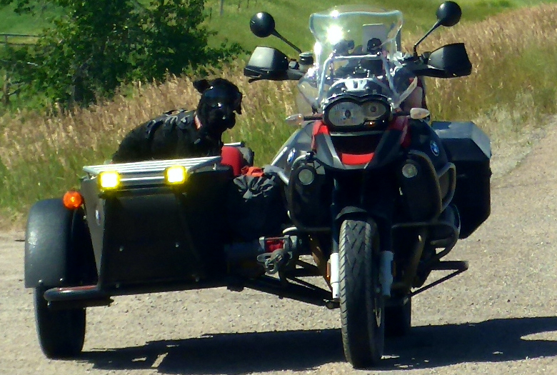

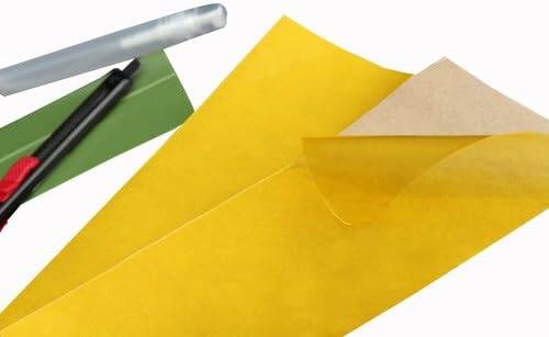

Scott, an alternative, and easier to complete the project quicker is:
https://www.amazon.com/Lamin-x-Universal-Film-Cover-Color/dp/B001P2EZFI?pd_rd_w=UHJnN&content-id=amzn1.sym.80c7e460-81a4-4553-97f2-a042638c4033&pf_rd_p=80c7e460-81a4-4553-97f2-a042638c4033&pf_rd_r=7RMGA7BQWZV3KWNF18FY&pd_rd_wg=XH62G&pd_rd_r=90e4cc94-ccfb-4a91-9910-6ba2da6979f4&psc=1&ref_=pd_bap_d_csi_rtpb_bap_sim_0_t
I have ordered this several times, for application on the lower driving/fog lights of both of my Subaru's, and it works GREAT. Have the same yellow film on both of my current Goldwing sidecar rigs, for the lower driving/fog lights.
You get 1 piece...4" x 8"...so all I did was cut the piece in half, so I ended up with a 4" x 4" piece, then laid it over the lens of the driving/fog light.
416lMi+nfRL. AC

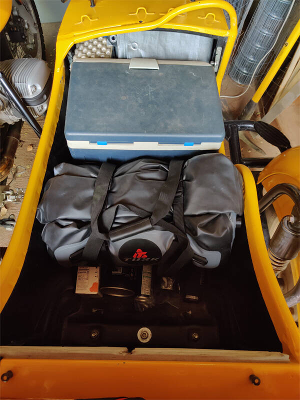

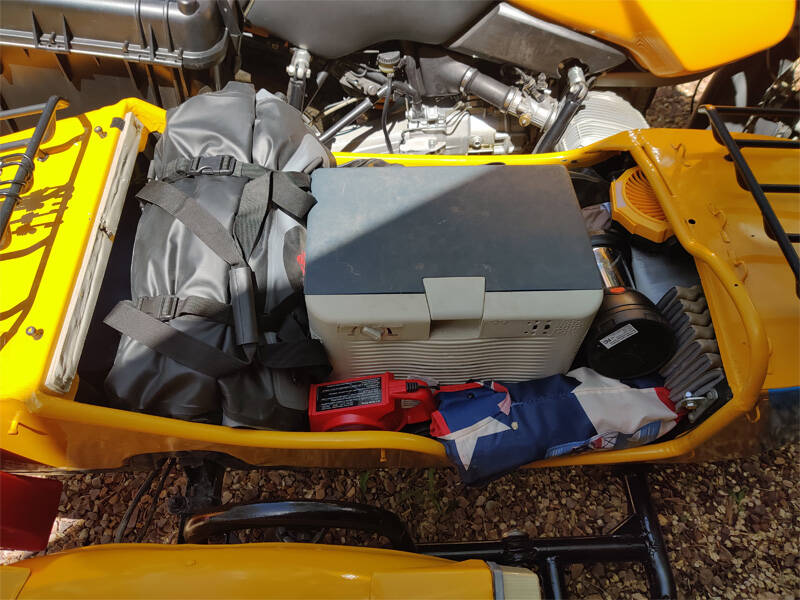

Packed all this "stuff" into the sidecar by removing the seat.
Too Much Stuff
While it all fits, it would not have been fun trying to get everything in and out, especially if it's raining.
Too Much Stuff Packed
Swapped out the two burner camp stove and pots/pans kit, with a Jetboil setup, and decided to leave the full size camping cot at home.
Now it all packs/unpacks much better.  With plenty of room around the cooler.  There is also room for stuff that might get picked up along the way.
Just Right Stuff
Really like the idea of a standing room tent with a full size cot.  During the trip the 2-man tent, full size camp chair and table may get swapped out to a back-pack table and chair,  and a stand up tent with a back-packers cot.  Will have to see how much actual "camping" gets done.
T-3 days and counting to launch.  Oh yeah! clap
Posted : May 29, 2024 5:05 pm

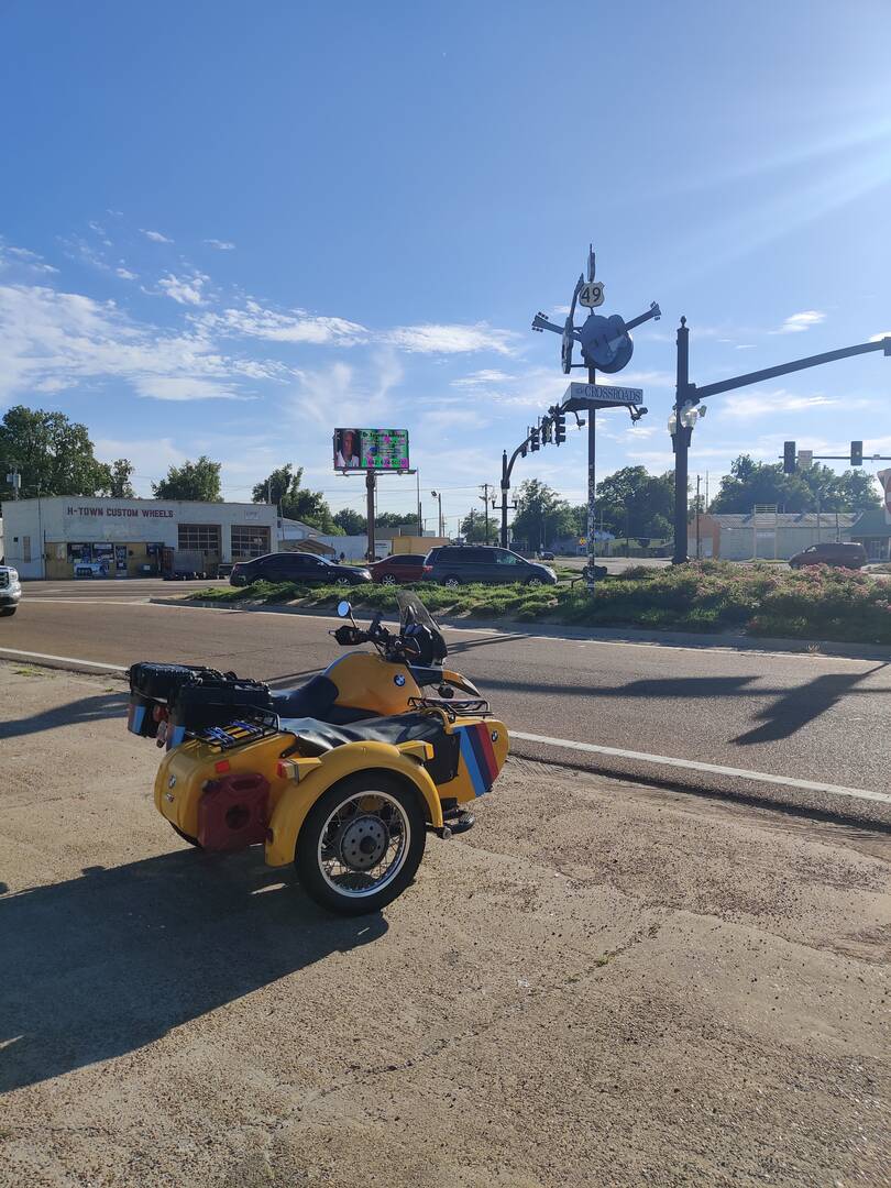

2,300 miles into the "big summer vacation trip."
So far, so good.  Visited the "Crossroads" intersection in Clarksville, MS today.
IMG 20240611 180951
 Was hoping for a 20HP gain and a reverse.  But the devil was on hold with the Comcast tech guys, having internet problems, and didn't have time to chat.  Said something about Miss Piggy holding his laptop for ransom.
Fuel mileage on this trip has been in the high thirties as long as it gets the "good stuff" for gas.  Bike has been handling well, although the front tire is getting badly cupped.  Will probably put a new set on in Indianapolis.

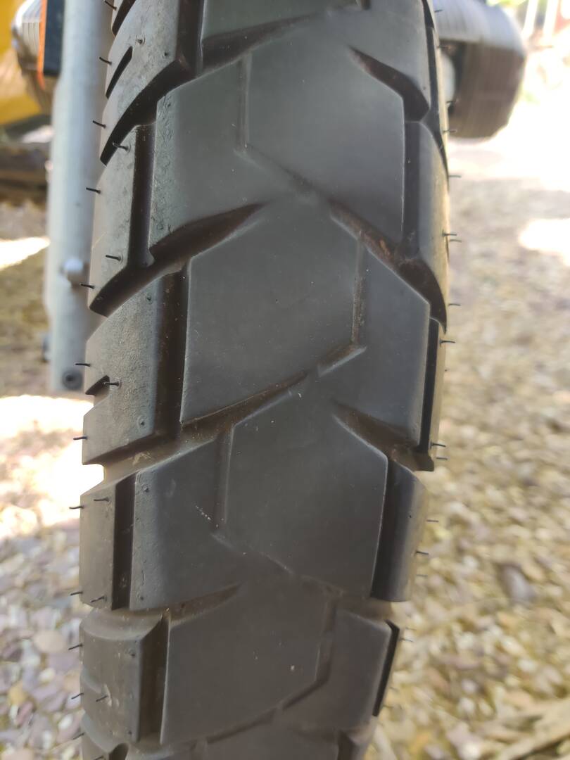

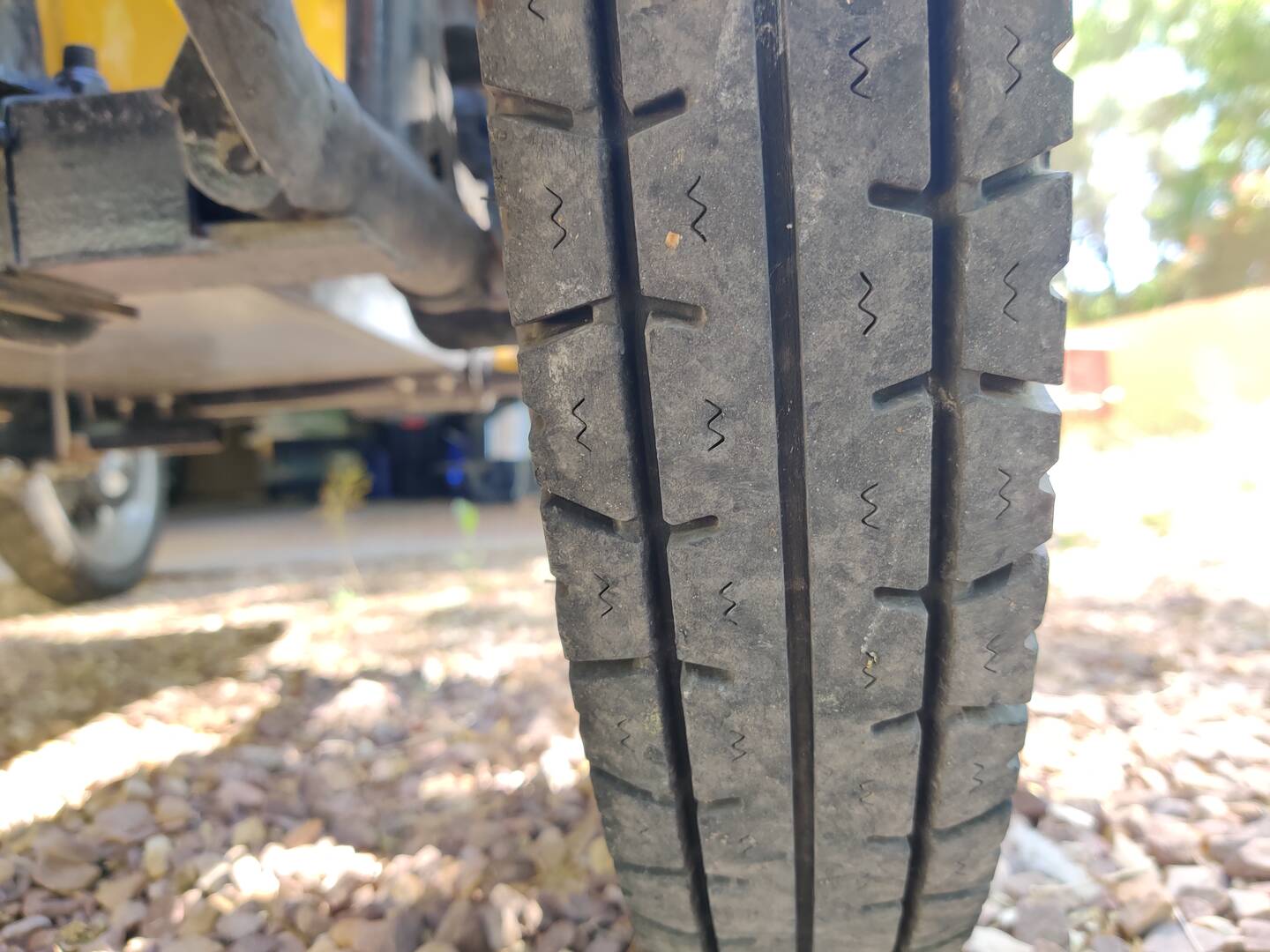

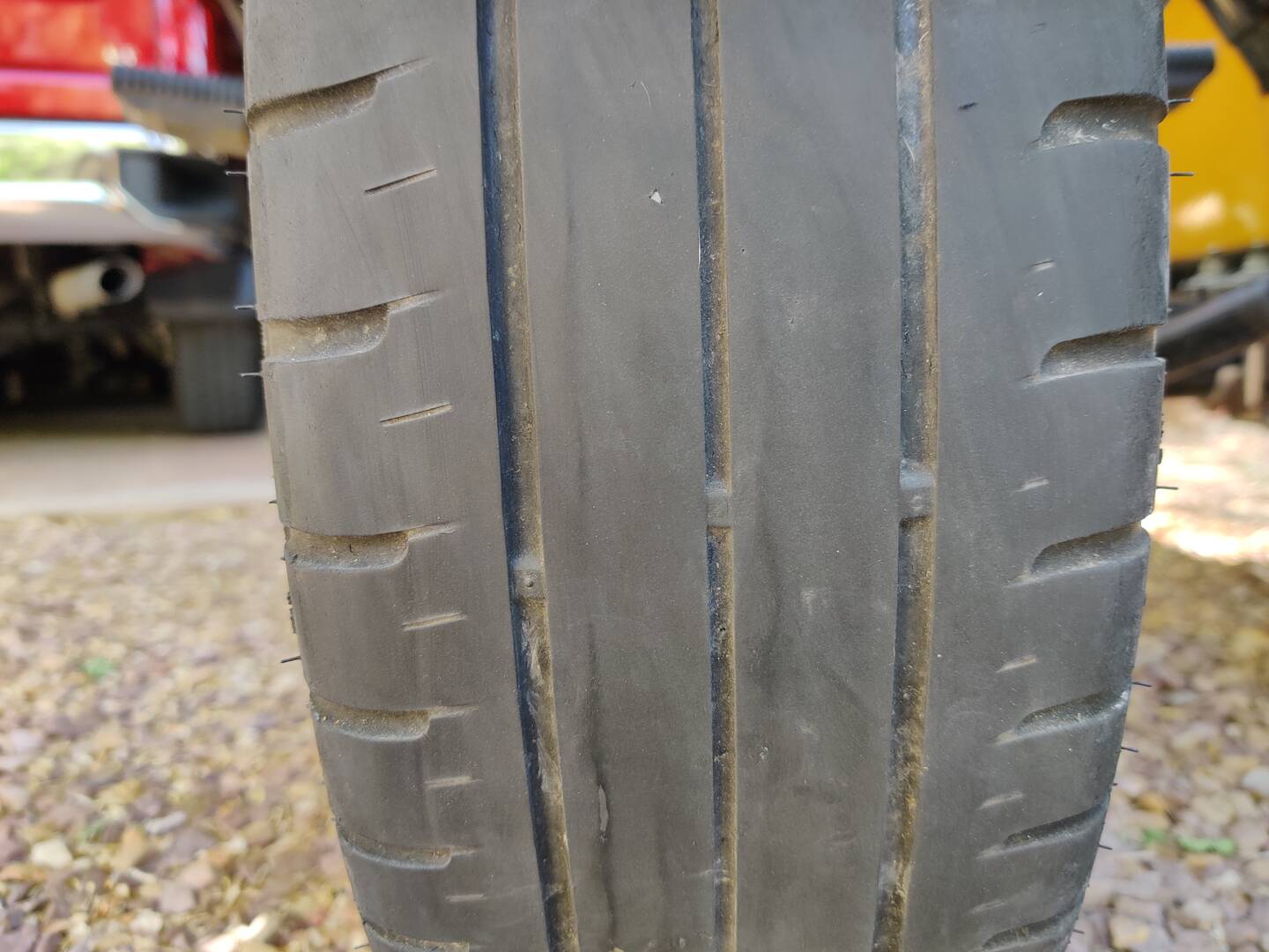

 Rig handled the whole trip with aplomb. So now it's time to do maintenance, and make some improvements.
Going to do a bit of experimenting with alignment. I noticed the inside of the rear tire has a bit more wear than the outside.  The sidecar tire has some feathered wear consistent with toe in (bike rolls easy, so maybe correct).  Front tire is very cupped and bar wobble progressively worsened with that wear. Will also experiment more with air pressure on the new tires.
IMG 20240618 163520
IMG 20240618 163533
IMG 20240618 163616
