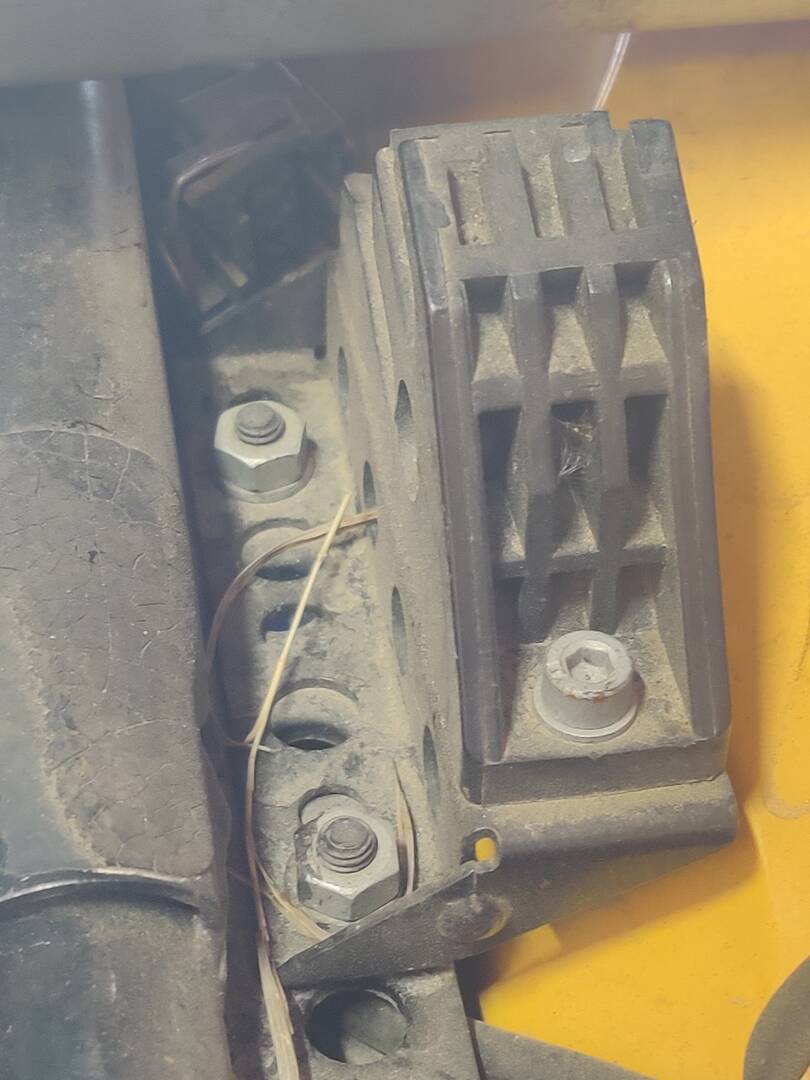

Those two connectors you asked about, on my bike are not connected to anything. They are tucked and zip tied together just behind the right side plastic seat mounting block and to the subframe
17678066970431423458468811432302
This bike has abs as well, so no idea what the connectors are for.
Hope this helps.
Hope this helps.
Scott, thank you so much!
I couldn't remember disconnecting them and was about to go nuts looking for something to plug them into. They don't seem to exist in the wiring diagram for this bike.
Those two connectors shall foever remain a mystery.
Good luck on the engine replacement, and if you ever need to compare anything to my bike, please ask!
Posted : January 7, 2026 12:44 pm

My pleasure Sir!  Maybe they are used on a different sub-model R1100?  When I have the rig apart, if I remember, I might trace them down.  Would be cool if they can be used for something cool.  Like a potato launcher, margarita blender, Stroopwafel maker... 😎  Or something less useful like a heated seat.
