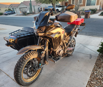

@scott-h Scott, congratulations on having your rig so well adapted to your needs!
I too found a throttle lock to be adequate on my prior Africa Twin.  Toyed with the idea of the McCruise unit, but couldn't work up the enthusiasm for the surgery.  Current AT has factory cruise and I am quite spoiled with it, though.
Isn't it a shame when all of the maintenance is caught up, and you can't think of anything that really needs to be done?  I finally talked myself into rebuilding a couple of leaky toilets, this afternoon, since Black Betty (that sweet girl) is behaving herself so well.
Also took her windshield off for a while, and disassembled the height adjuster.
It has these slidy plastic things that have gotten beaten to death over the course of 40,000 gentle miles and they needed to be replaced, along with some mounting bushings, washers, etc.
Ordered about $100 worth of fiddly bits to rebuild and enhance the adjustable windscreen apparatus to see if I can get it to go a little further on this rebuild.
Look ma, no windshield:
As I have slowly been going deeper on front to rear drive sprocket ratios, I have not noticed much degradation in fuel milage.  For me, I think it stays in 6th gear at freeway speeds more, now, instead of wanting to shift down to 5th on mild inclines.  Acceleration is a little more brisk, but I am really liking the deeper ratio when in 1st gear on rocks and stuff the best.

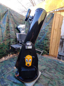

Since there didn't seem to be a winter project worth doing on SYZ, something had to get done.  Decided to train Pluto the Dob how to fetch.
Pluto The Dob
Pluto started life as a regular Apertura AD8 Dobsonian telescope ( https://www.highpointscientific.com/apertura-ad8-8-inch-dobsonian-telescope-ad8).   As a test to see if the light pollution was reasonable enough to spend the big bucks building an observatory, and getting some more premium telescopes.   These are a great way to get into astronomy at a reasonable price.  This being an 8" scope is considered a "life time" purchase.  It has enough aperture to see faint fuzzies, with enough quality to get some great planetary detail.
Unlike the inventor John Dobson who would have been a great person to know/interview ( https://en.wikipedia.org/wiki/John_Dobson_(amateur_astronomer) ), Dobsonian operators tend to be people who enjoy pushing things around.  I'm not a pushy person, and prefer to go along for the ride to see where it goes.
This meant breaking with tradition and adding electronics to semi-automate the process.  Thankfully there are DIY kits for just this purpose.  They all lack finish detailing though.  The kit used here is a Romer Optics EZ Goto setup ( https://romer-optics-llc.myshopify.com/collections/coma-fee-dobsonian).   To which was added a separate electronic focusing system of my design using the R-O focus bracket kit.   Rather than have loose wires running all over, the harness was disassembled wrapped in nylon sheath, and then run through strain reliefs to keep the amps, relay and power board inside a project box.  For power there is a five amp Li-Po battery.  It allows running 20V to the Goto system, and 5/9/12V out through the USB ports.  Perfect since the primary mirror cooling fan is 12V, and the smart phone charging is 5V.
The Pluto mask is just there to cover the Alt motor setup.  As Pluto is the coolest of all the planets, and orbits on it's own path, it just seemed fitting.  He is a bit starry eyed though.

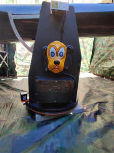

Right Side Base

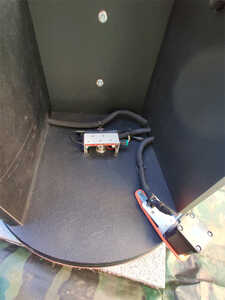

For transport the Optical Tube Assembly (OTA) lifts off the base.  Since the focuser motor and harness is permanently attached to the OTA, the end at the driver/controller is connected via a 4 pin round plug designed for constant connect/disconnect.  Taped to the sheath is a magnet to hold it in place on the base when fully assembled, and to the OTA when transporting that part separately.
Scope Assembly Left side
The  EZ Goto kit includes two encoder units with the Azimuth encoder having a bluetooth chip to connect a tablet or smart phone via the Romer Optics EZ Goto app.  That app has several catalogs of astronomical objects for perusal.  Once the initial setup is done, it's just a matter of calling up an item to view, and the scope will go to that item, and track it for as long as it is in the sky.  Or, the scope can be "pushed to" an object and then set to automatically track that item.  The best of both worlds for those people with multiple personalities.
AZ Encoder
