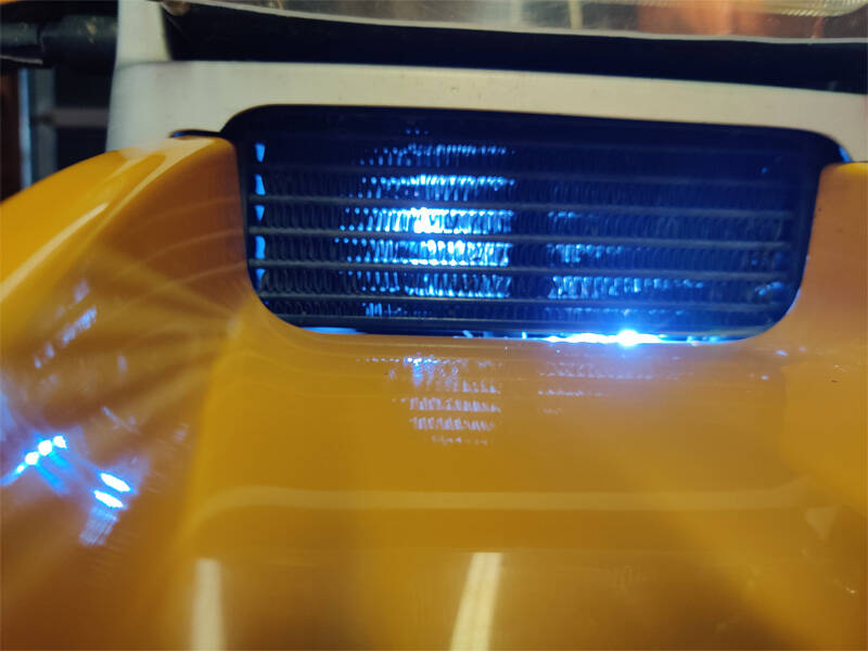

On a separate topic:  Today I gave the rig a good wash and checked the oil cooler fins.  The core only had a few small spots where light would shine through.  It was packed with dead bugs, and other nastiness.  Almost all came out by running some light water pressure from the back to the front.  The rest I was able to remove with a pick.  Straightened up a few bent fins on the front side, and now the light shines through every nook and cranny of the whole core.  😎  Very happy about that.  I'm considering fabricating a removable pre-screen to sit in front.  Something that is easy to service at a gas station stop.  There is a lot of Ag Land out here, and all the bugs that go with that.
Kind of surprised the rig didn't overheat on the more aggressive off road where the engine was under high loads at low rpm for extended periods.  At least I know why it struggled to cool down on faster light load sections of fire roads.  Will be fun to get back out, and give it a good test run.  🙂
Hard to get a good picture of light coming through across the whole core. Where the light shines strong is how the entire core now looks.
Clean Oil Cooler Core 7 22

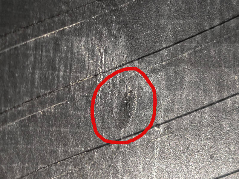

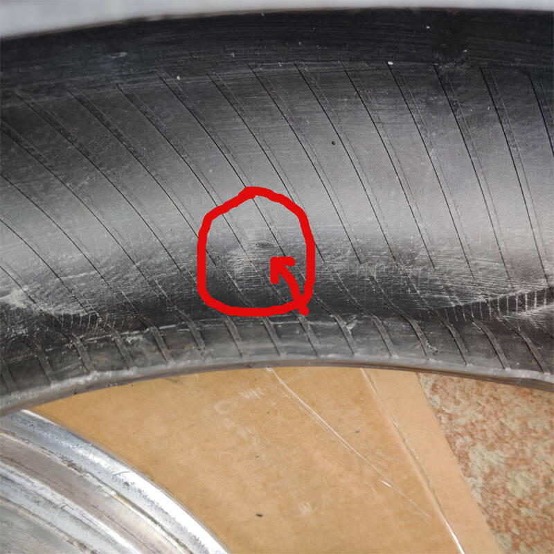

Had some fun yesterday.  Removed the old rear tire, and think I found what caused the blister on the sidewall.  It appears something roughed up a small spot on the inner lining.
Scuff Close Up
Scufff In Liner
Doesn't explain the large amount of weight required to balance, but gives me something to look at on the replacement tire.

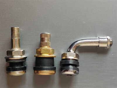

Since the old tire was off the rim, it provided an opportunity to change the long valve stem that was a pita to inflate and check pressure.  Bought a 90 degree bend tire valve, but it is kind of cheesy, so I picked up a short straight version that is of high quality.  Even though it's shorter it's still a bit tight to get a straight inflation nozzle on, and ended up using the 90 degree version.  Original long valve removed on the left.  Will save the straight version (middle of picture) for the front wheel when that tire gets changed next time.
Valve Stem Choices

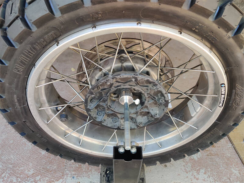

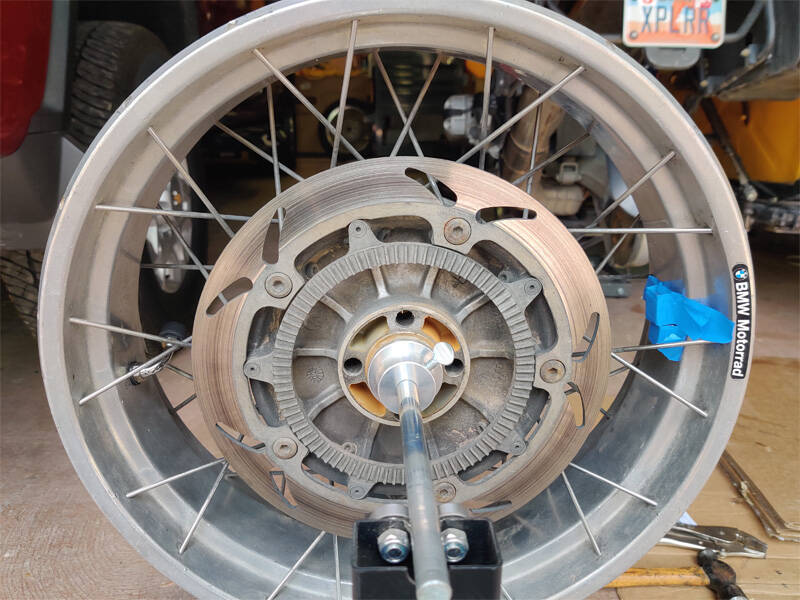

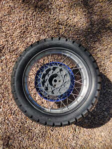

With the new stem installed I thought it would be fun to see how the wheel assembly balances.  Took just over 1-1/2 oz, and an additional 1/4 oz with the TPMS cap to balance nicely.
old weights taped in place for test balance.
Wheel assy Balance check

Will be interesting to see if the tire acts as a counterbalance.  It does have a yellow dot that will get lined up with the valve stem.
Waiting on the sun to work its magic before attempting to install the second side.  First bead about fell on the rim with some WD-40.

Good Day Sunshine!  😎
In the Starring role the Sun was magnificent.  Allowing for an easy install thanks to a supporting cast of WD-40 and Tire Irons.

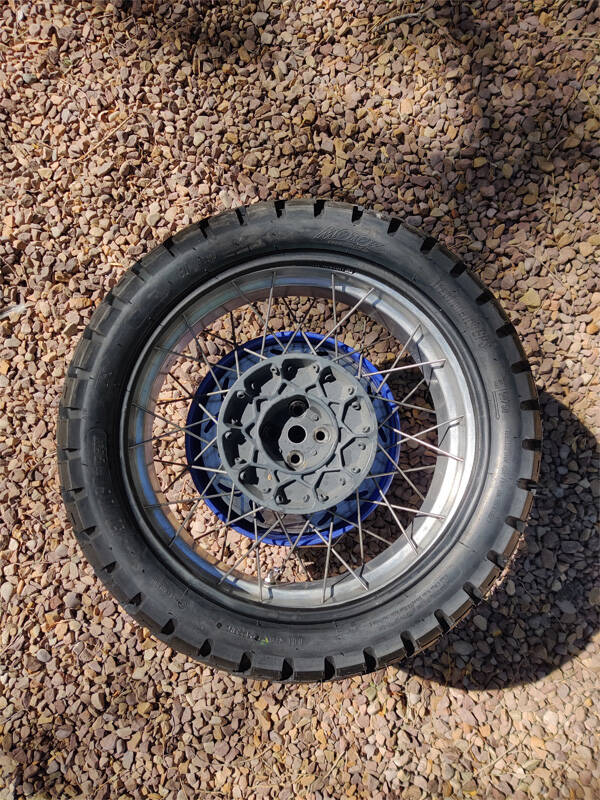

Tire balanced out way better than the first one.  Needing only 1-1/2 oz slightly off set of 180 degrees from the stem.  Now I'm happy.  Sometimes things just work out for the best.  🙂
Rear tire balanced
Will give the tire weight adhesive a good 24 hour opportunity to setup, and then it is time to play around on a dirt road.  Need to practice Power Slides.  With all this grip it isn't nearly as easy as it used to be.  🤠
Posted : July 26, 2024 2:10 pm

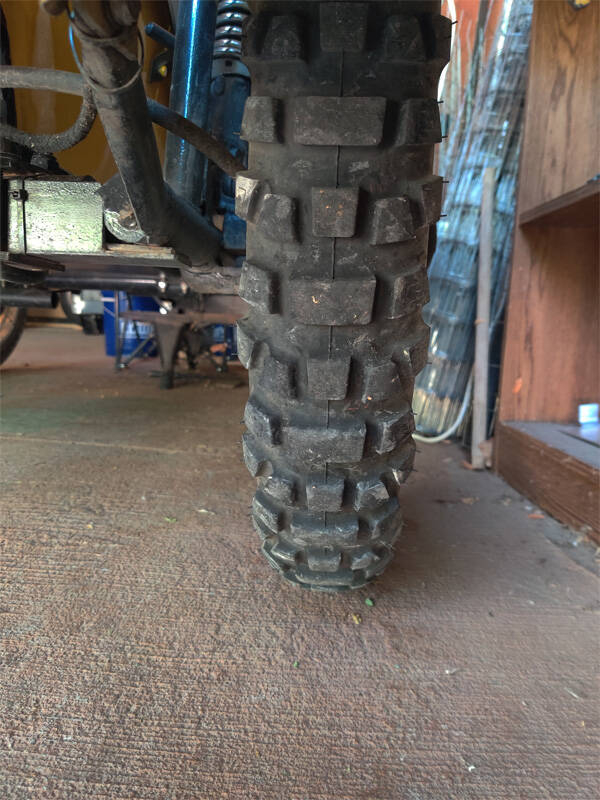

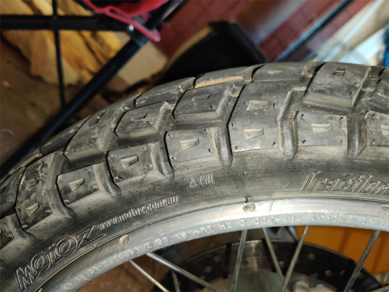

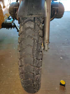

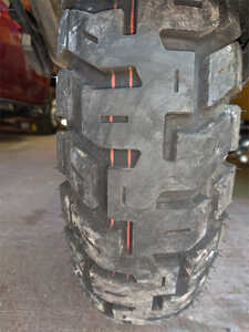

Front tire and sidecar tire now have 700 miles about 70 miles of that in dirt/gravel roads/ATV trails, and continues to perform well.  New rear tire has 360-ish miles with about 40 of that on gravel/dirt roads.
The front Motoz GPS is really pressure sensitive when it comes to steering wobble.  32 psi at 65 degrees F seems to be a very narrow sweet spot.  At that point the bars don't wobble even when heat raises the tire pressure into the 34/35-ish psi range.  But if I start with more than 32 psi cold, it will wobble straight out of the garage.  Wear seems to be pretty even with just slight rounding on the front edge of the blocks.  From the first 700 miles of use, it seems this tire is passable for the street as long as the rig is ridden with moderation.  Front has better grip than the Shinko E-705 but is still more off road focused than a pure street tire.
Bridgestone AX41 on the sidecar is doing well.  It does not have as much lateral traction as the Block-K it replaced, and is slightly louder. It is a smoother riding tire. Probably not the choice for a spirited street rider, but has been working great for off-road traction and provides the monkey with a very comfortable ride.
New (warranty replacement) rear Motoz GPS tire has 360 miles, of which about 40 miles is unpaved county roads.  Noticed the wear was accentuated to the left side of the tire.  I had made a pretty pronounced lean-out change shortly before install.  Readjusted that to bring the tug back to about 1.5 degrees lean out.  Still tracks well, so this should help with a more balanced tread wear.  This tire is about the minimum I'd be comfortable with grip wise on the street.  I can induce a pretty good power slide on the pavement (especially on a right turn), and it isn't too hard to do until the bike runs out of power/rpm.  I couldn't do that with the ATR-K Ecoterrorist tire.  It had substantially more grip on the pavement.  Probably this tire is not the best choice for a more spirited street rider.  It was also pretty "greasy" feeling during the initial 100-ish miles of break-in.  Twice I got off the bike thinking the swing arm or final drive was loose.
Unless something dramatic happens, that is it for tire reporting until after the big trip in September.  If all goes well, the set should have in excess of 2,000 miles (hopefully more in the 3K mile range).  🙂
Pictures are: * New rear tire with 360-ish miles.  *Side profile of front with pretty smooth wear. * Front profile shows a nice wear pattern.  * Sidecar tire wearing as sidecar tires do. 🤣
Rear tire 360 miles wear
Front Tire 700 miles side v
Front tire at 700 miles
AX41 700 miles

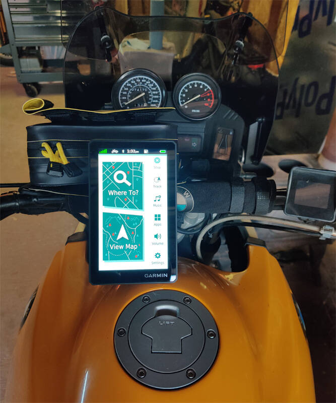

in the category of "telling me where to go" SYZ now has a new-to-me Zumo XT.
I've relied on Google or Waze street navigation, and Back Country Navigator Pro ( https://www.backcountrynavigator.com/backcountry-navigator-pro) off road navigation for about decade.  Has worked awesome, with paper maps and an old army compass for backup.
This last big trip the cell phone bricked up during travel.  It is one of those phones with the battery leads soldered to a board.  To "un-brick" the phone I had to short the LiPo battery so the bms would shut it off. That was sketchy. Thankfully the BMS had an auto reset.   With that experience, I decided to do something different, getting the phone off the bike, and into a pocket that doesn't vibrate so much.
Will be interesting to learn and work with this new device.  I found out MIT offers a two year associates degree in Garmin Navigation products.  🤣
To be honest I'm not sold.  Being able to say "Hey Google, navigate to xxxxxx."  Or "Hey Google, show gas stations on the route." All on the fly through the helmet communicator.  Having to pull over and type things in is so last century (matching the rest of the rig, and driver).   Supposedly this will link up with my InReach SE, so I "guess" that is a good thing?
Need to wire into the bike's Accessory circuit.
Jury is out.  Thankfully there is Summer Vacation v2.0 coming up to give it a good try. 😎
Zumo XT Mounted
