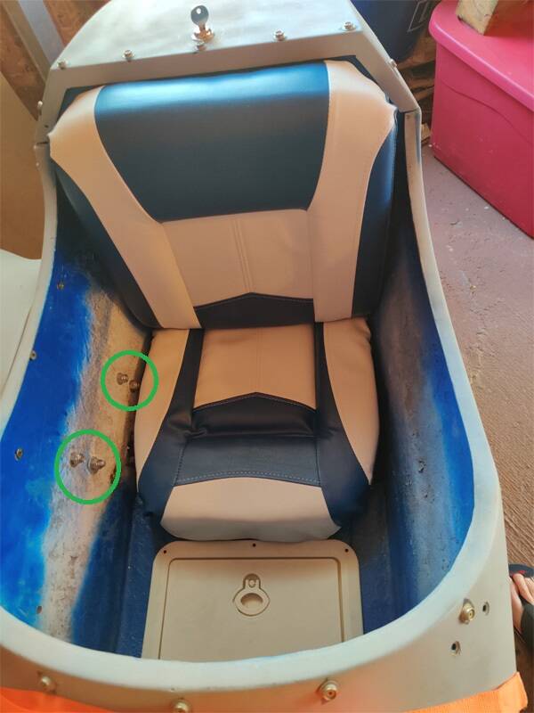

I'm kind of excited about what was found out on the shock. I think it will require new mounts. If so, I'm going to take advantage of creating a new upper mount that allows both mounting points be through the metal embedded in the body. Currently only the bottom bolt goes through the metal.
What this will allow is using flat head bolts through the tub. That eliminates the bolt and nut inside the tub. So the side trim panel can fit tight to the contour of the tub side.
Bolts circled in green are what will get replaced with flat face fasteners, same as the three fasteners above that hold the fender in place.

Scott,  we have received a couple written questions from your viewing audience,  they are....in no particular order:
In picture  #3 above, what is your intended use of the air shock ?

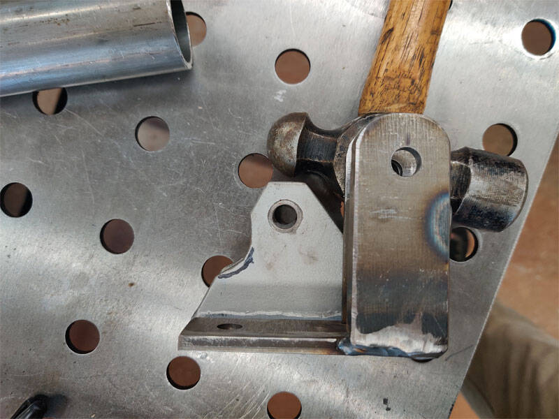

One of the enhancements that will get done is to shape the lower shock mount correctly to fit the web.  Motorvation felt a flat shock mount attached to a sculpted web was okay.  I can't disagree, since there are no reported failures.  But it doesn't look very nice.  The shape is a lazy S.  Debating on whether to do a multi-piece backbone plate, or heat and bend up a piece.  Need a cup or two of coffee to clear the cobwebs.
Lower Shock Mount Gap
Posted : October 3, 2025 8:54 am
Posts: 1239
Mulling over what to do about the lower shock mount that bolts to the hub.  Definitely an afterthought on Motorvation's side of things.  Not sure how the original designer would feel about what was done.  Pretty "hack".  To be fair, and as stated previously, the original mount lasted with no signs of possible failure for over 10,000 miles (if I understand the original owner's info correctly).  I'm just not comfortable putting my name to that.  So it will get enhanced, one way or another.
* ETA:  after a couple cups of coffee to ruminate over this,  I started thinking about using a two part metal epoxy to build up the area.  Learned this is something done in the aerospace industry.  They call it "liquid shim".   Did a bit of research, and found a few choices.  Now to see if any of them are available locally. *
In any case, this is what will be dealt with.  Where the shock mount mates to the hub, is pretty curvy. The lower hole is right at the edge of the skeleton.
Hub curves
Hub shock mount holes
Think it will start with a piece of 1/4" plate.  That thickness provides plenty of meat to thin out as needed.  Like around the bottom corner where the hole is.  I don't currently have a press, or oxy/acet torches.  So I might try cutting separate pieces, shaping each piece then weld them together to create the back plate.
Oh yeah, found out this tub was built with an aluminum structure embedded into the fiberglass.  That matches the brochure.  I'm guessing Motorvation switched to using steel at a later date (total WAG on my part).  I'm looking forward to see what this sidecar weighs.  Paws crossed it is less than the reported 190 lbs.

Fillet Made
Fillet Making Materials
I'm feeling better now.  Funny how something so trivial can really chafe my hide.  Motorvation should have done this during the build. Set the original bracket in place to make sure the fillet was correct.  After lunch the holes can get re-drilled, then it will be time to start hanging stuff up to paint.

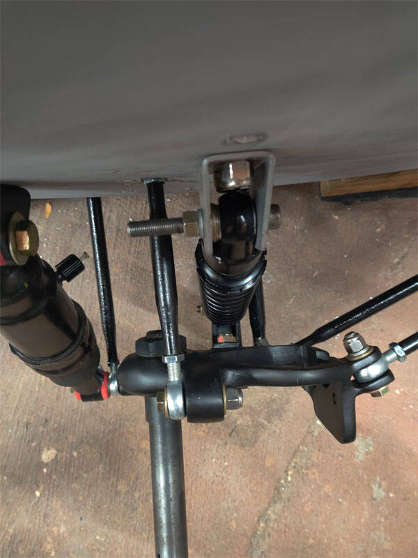

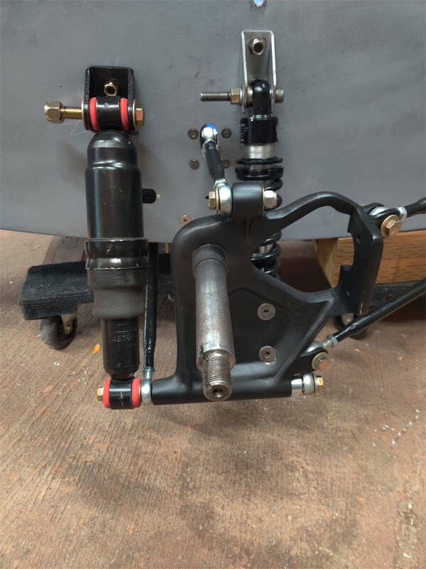

Getting close.  😎 Need to shorten the two top shock mount bolts, add some medium strength thread lock to the lower link bolts, check/balance the sidecar wheel.  Then it will be time to start the mating process.  Have an emergency call in to David Attenborough to find out if there is any special mating calls, or nesting materials required for a Triumph/Spyder mating ritual.  Just in case he doesn't return the call, I've got Spike Jones ready to spin up on the Victrola.  😉
Took quite a bit of work to get things right.  The way the coil over shock was setup it was in a bind, causing stiction.  I used the opportunity to lower the shock 1-1/2" with a new lower mount.  Along with lowering the shock via the new bottom mount, it was moved in about 5/8".
Coil Over Shock Mount Compa
Lowering the coil over shock allowed remounting the upper bracket an inch and a half lower, so now both bolts go through the reinforced portion of the tub.  Also able to countersink the holes and use flat face fasteners.   The tub is fairly narrow, so that extra inch could be the difference of Jenifer Lopez being able to get in and out, or having to call the fire department to pry her back out.  😮
Nuts eliminated
Flat Face Shock Mount Bolts

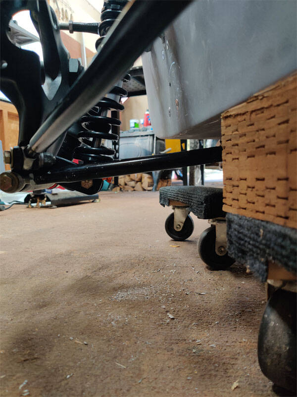

In order to get the lower mount properly aligned for a correct shock stroke, it required a spacer added to the front lateral link.  Interestingly that now makes the lateral links parallel with each other.  I might put all the measurements into my four link calculator on a snowy winter day.  Air shock lower bushing is about 1/4" short inside the polyurethane, so I added a spacer to properly locate the shock without it squishing into the Heim joint.
Suspension Side On
Suspension Top Down
Suspension From Front
Any of the Heim joints that aren't captured, have a safety washer, so that if the socket comes off the ball, the link can't fall off.   Overall happy with how this is coming out.
