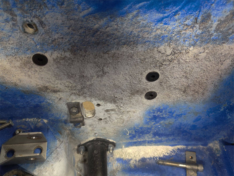

I'm kind of excited about what was found out on the shock. I think it will require new mounts. If so, I'm going to take advantage of creating a new upper mount that allows both mounting points be through the metal embedded in the body. Currently only the bottom bolt goes through the metal.
What this will allow is using flat head bolts through the tub. That eliminates the bolt and nut inside the tub. So the side trim panel can fit tight to the contour of the tub side.
Bolts circled in green are what will get replaced with flat face fasteners, same as the three fasteners above that hold the fender in place.

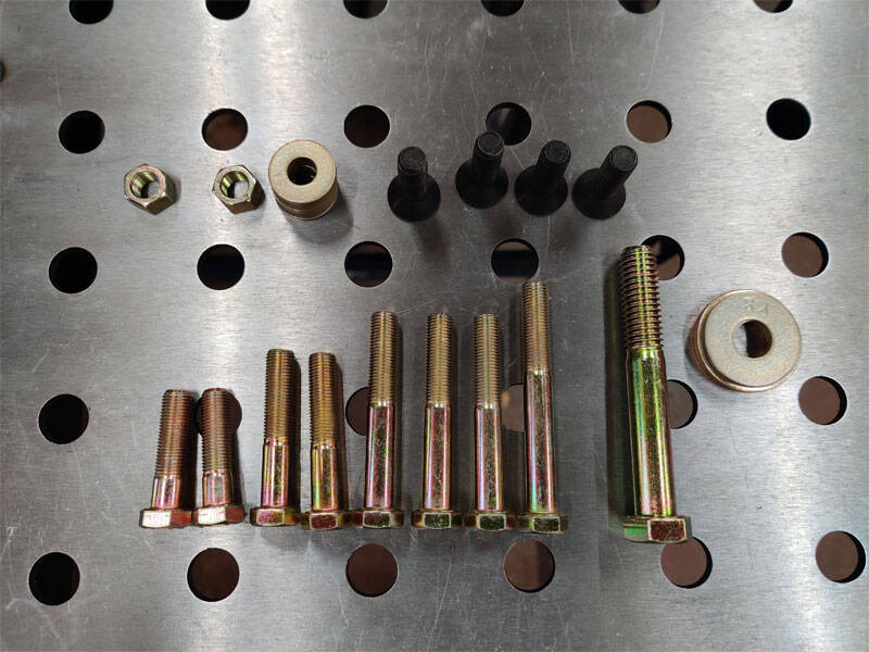

I'm going to have to get more bolts.  Motorvation didn't use the correct bolts for the hub.  Good example of what happens when the bolt grip is too short.  Thankfully this lug doesn't need to be drilled and sleeved, but it is close.  The threads of the bolt cut into the aluminum.  Wouldn't have happened if they used the right product.
Bad Grip

Round 2 of bolt changing.  Getting as close as possible to proper grip lengths, but it's still going to require one more try.  Thinking a web order through Fastenal.  All five bolts required shortening, but at least the grip on each goes clear through the aluminum hub.  So that will get by until the tub is stripped for paint.
Bolts Round 2
