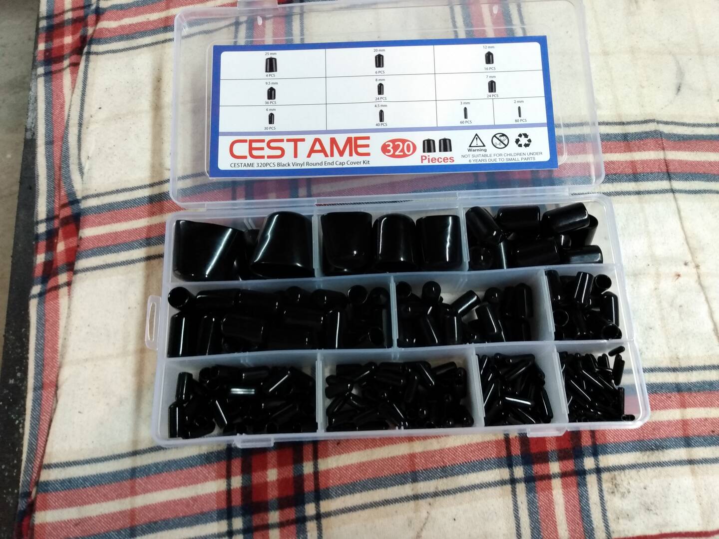

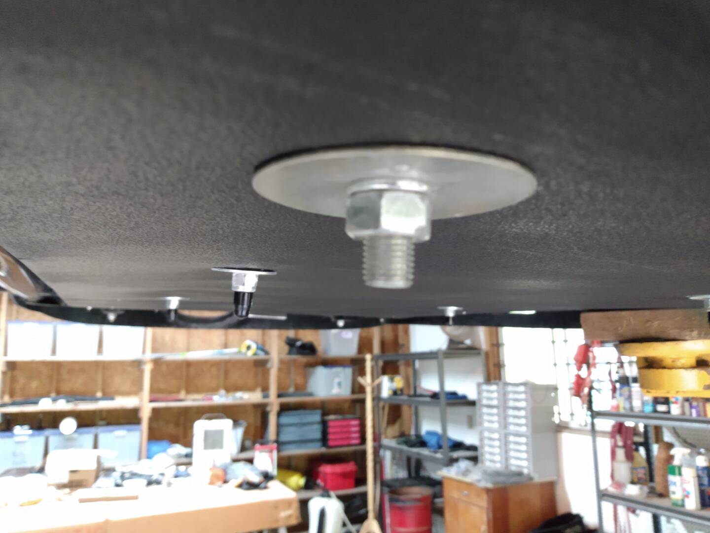

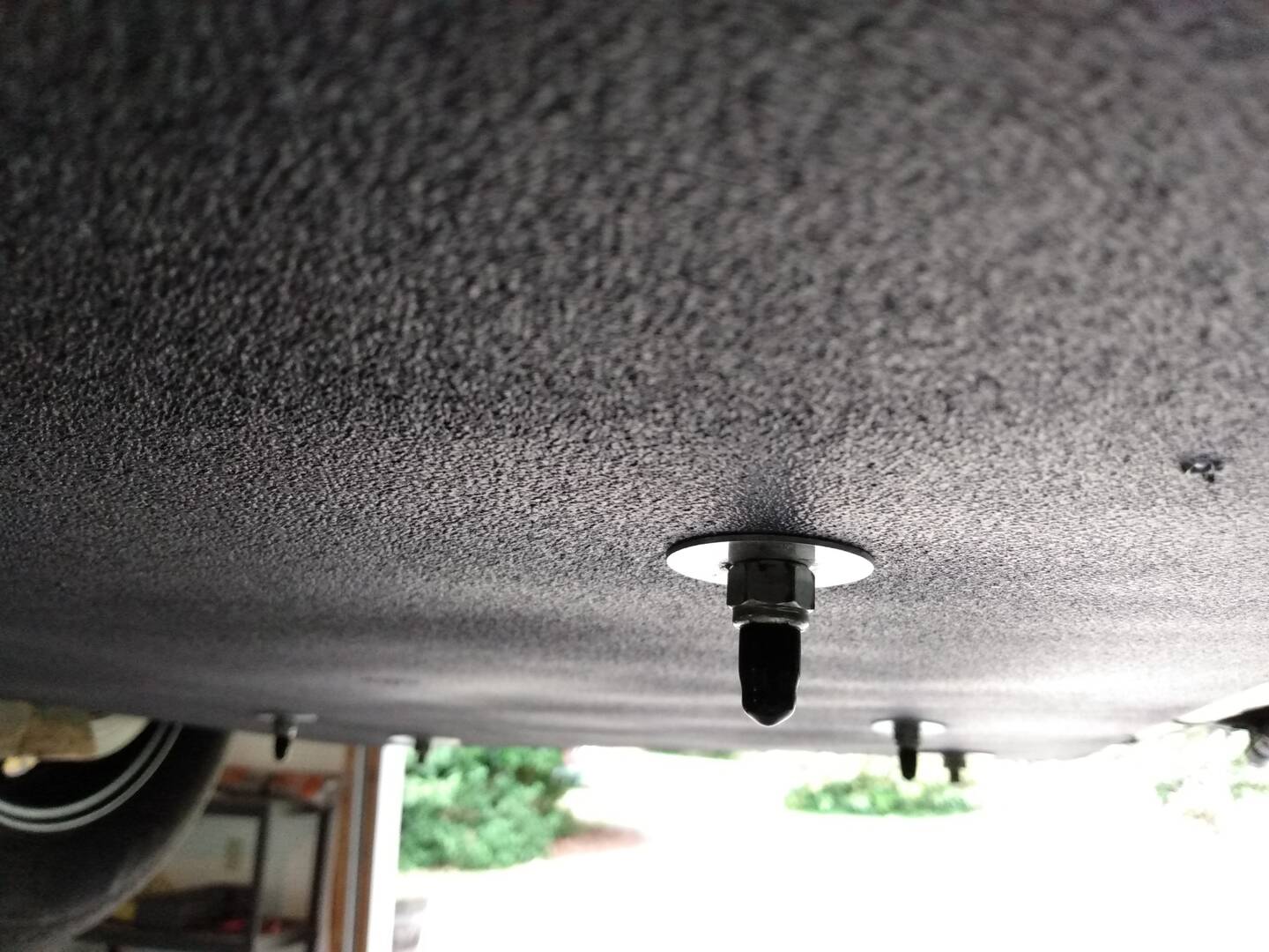

Scott, order on Amazon:
https://www.amazon.com/Pieces-Rubber-Covers-Thread-Protector/dp/B0B4G1F84B/ref=sims_dp_d_dex_ai_rank_model_1_d_v1_d_sccl_1_5/138-2740898-1419733?pd_rd_w=sdqGM&content-id=amzn1.sym.da0b205c-8cc7-4a8d-9d0a-8ed3705890a2&pf_rd_p=da0b205c-8cc7-4a8d-9d0a-8ed3705890a2&pf_rd_r=1NWVX9WZVE4T30Z69M94&pd_rd_wg=C6I5J&pd_rd_r=33130fdb-460e-4f00-add6-9fec8cd9d595&pd_rd_i=B0B4G1F84B&th=1
These are the Black Rubber caps that comes in a large assortment of different sizes, to place onto the exposed threads of any bolts, or the nuts, to keep corrosion off the nuts or threads.
I have done this to my last 3 sidecar rigs, and I used ONE drop of Super Glue inside each Black Rubber Cap to hold the rubber cap on, and make it stay on, until I need to remove it with a simple twist of the rubber cap.

Looks very clean!  Thanks for sharing the kit info.  👍

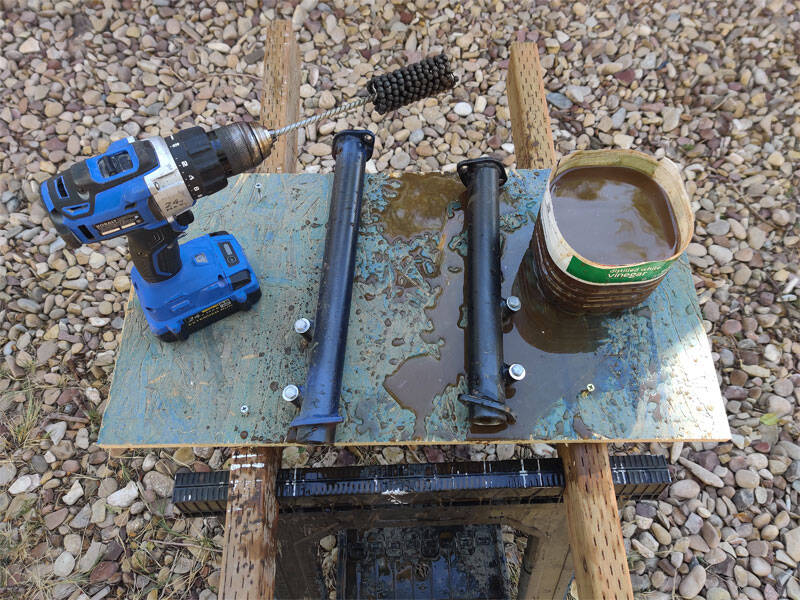

Pulled the frame tubes out of the tub.  Honed out the rust with white vinegar and a 120 grit ball hone.  Thanks to the work done by the previous owner the honing went quick.  A bit messy.  Think I might be permanently pickled.  Used the same vinegar to sand the rust off the connecting tubes.  Will go together pretty easy, and should hold adjustment well.  😎

Long day with a hone and sand paper.  Now they slide in like they should. Took all day, but happy with the results.

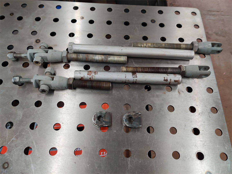

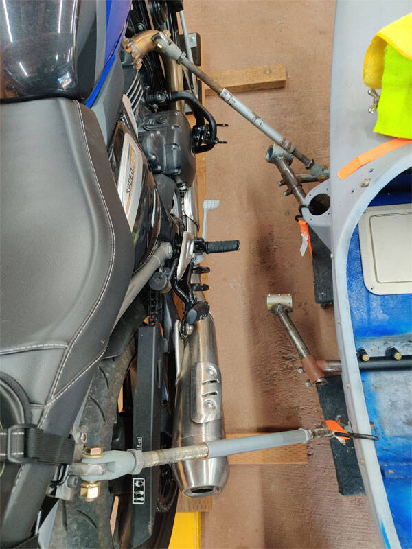

Almost forgot about the struts. Disassembly of the short strut took a bit of heat, penetrating oil and persuasion.  All threads and nuts are in great shape, with just a bit of cleaning needed.
Hoping to be able to re-use both of the original struts.  They each have right and left hand thread clevis ends, with a large adjustment range.  If they can be re-used, I'll weld a nut in the middle of the shorter tube to ease adjustments.  The long tube has a nut already welded to the one end.
Struts Disassembled
The key will be the rear strut clearance around the exhaust muffler of the motorcycle.

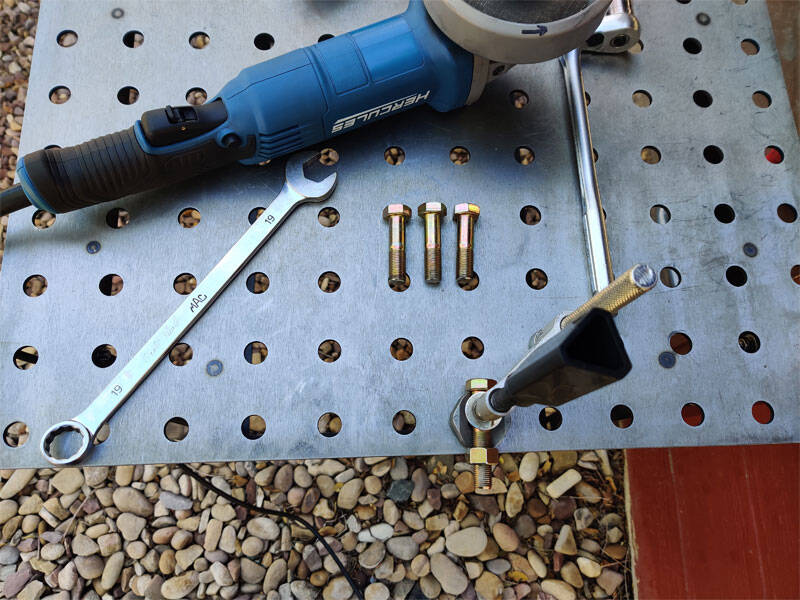

Small projects getting completed while waiting on the tubing to finish the final lower links.

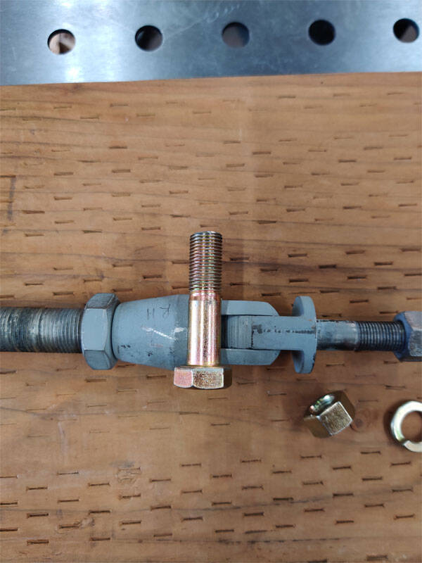

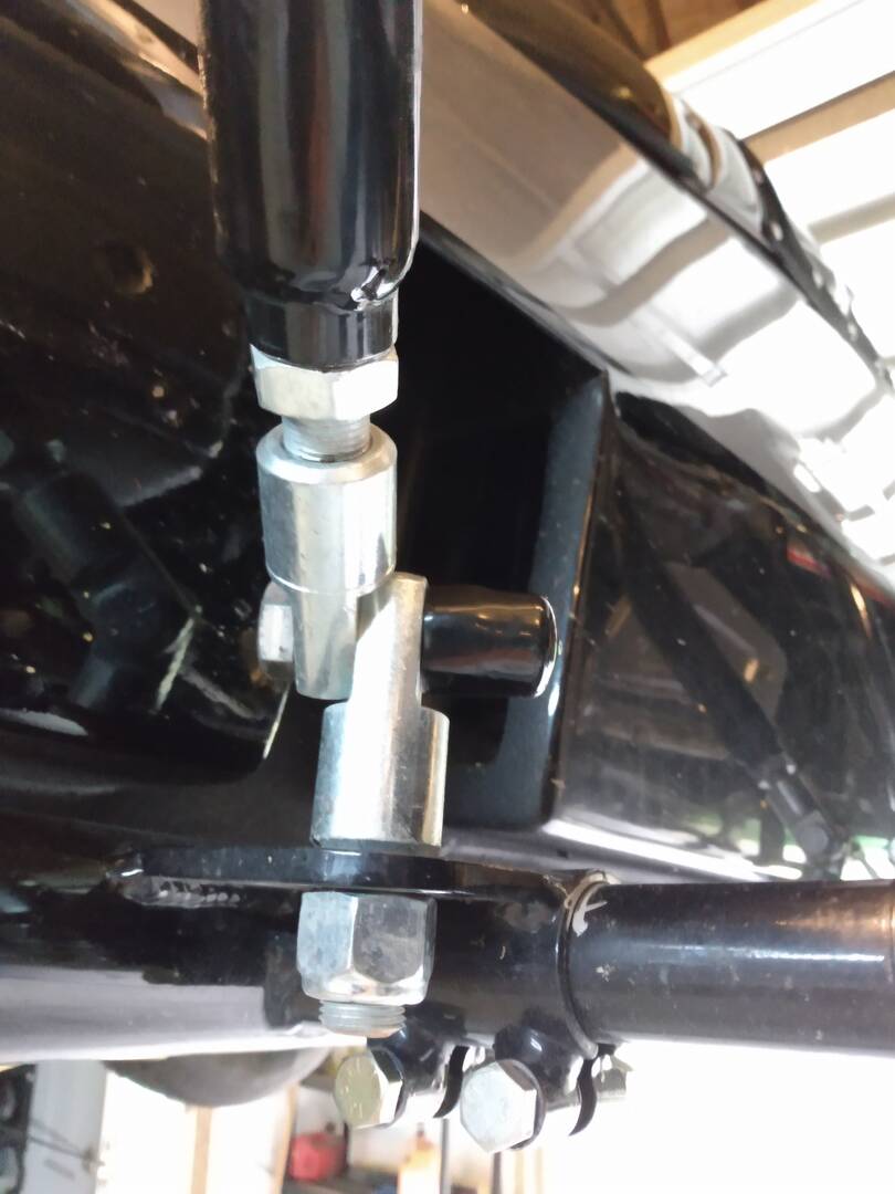

Noticed that the original clevis joint bolts were fully threaded.  That's not the correct way to do things.   The clevis should have a bolt with the grip just slightly longer than the clevis width (same as what I did for the lower joints).  On these units it means finding a half inch diameter bolt with a grip slightly over 1" long.  Closest I could find were 2-1/2" long bolts to get a 1" grip.  I'm getting pretty good at shortening bolts, but miss not having a local Fastenal shop.  So that was the morning project.
Clevis Bolt Shortening
Clevis Bolt Grip Length

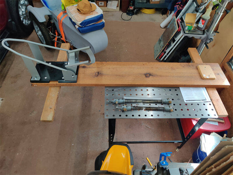

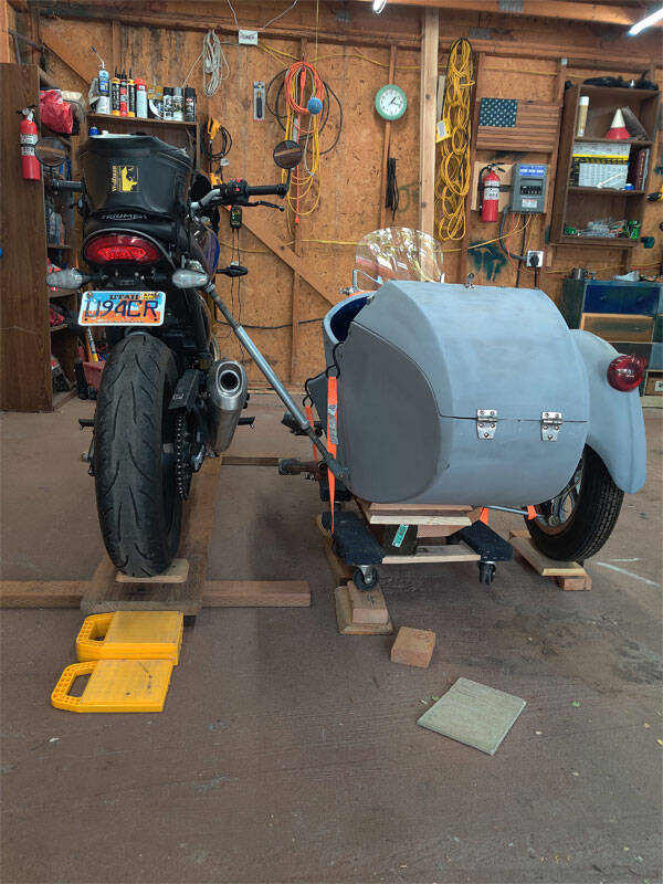

After lunch it was time to start work on the setup jig.  This is the start of the bike side of the jig.  2x4s are centered under the wheel base of the bike.  The garage floor isn't too level, so this allows shimming under the 2x4s for the bike and sidecar jig to get a level working plane.  Also makes it easier to strap the bike into "rider sag", condition.
Bike Jig Start

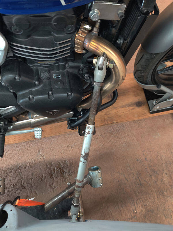

First the good news:  Two concerns I had were:
  • The ability to get enough longitudinal adjustment between the lower bike mounts and sidecar mounts.
  • Rear strut clearing the mufffler without resorting to a curved strut tube.
Looks like there won't be an issue with either concern.  😀
Lower Struts Align
Rear Strut Works

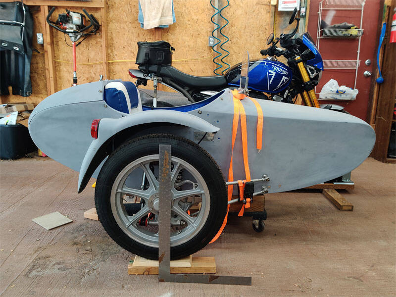

Will require a longer front strut.  The rear strut in the pictures will do well on the front, and a new longer Strut tube will be obtained for the rear.   Or maybe just get two new tubes thinking optimistically that this is going to be a good pairing.  🤔
Front strut short
The initial setup will be done with the bottom of the sidecar tire 1.5" lower than the bottom of the bike tire.  At a 48" track width, that creates an approximate 1.8 degree lean out.  Still need to complete the sidecar side of the setup jig.  Going to setup the car with a slight nose down attitude.  This will match the angle at the bottom of the tank, and the bikes overall nose down slope.
Slope Nose Matches Tank
