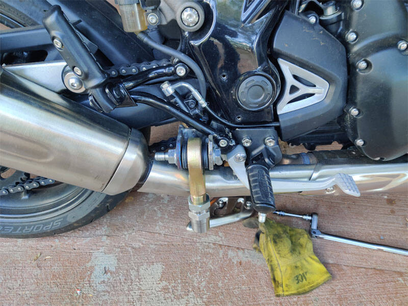

Finally done with this mounting point. 😎
In order to get an un-threaded bolt shank long enough to go all the way through the bolt is longer than required. Shortened to fit correctly.
Only three more mounts to go. lol

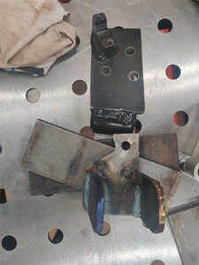

Back to work on the front lower mount.  This will have a sub-bracket that stays with the sidecar (unpainted piece), and bolts to the bracket that stays on the bike (painted piece).
Joint Bracket Roughed Out

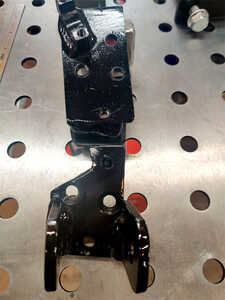

Finished up the front lower bracket.  Just letting the paint cure. drilled and tapped the bracket at the bottom center for one more mounting point.  Will do final mounting tomorrow.
FLB Brackets Ready
Two more flat plates to cut & drill for the upper mounting points, then it will be time to make the setup jig for the bike and sidecar.  Getting excited to see how this is going to work 🙂 ... or not. 🤔

Ah.....you missed a spot.
Lower bracket,  about 2 o'clock position,  looks like YELLOW  paint got on it.
Or, is that how you identify all parts in the SYZ barn ?

A little SYZ goes into everything!  😍  The stripe and dots in the picture are a reflection.  I may do a top coat on this in a satin black to match the engine case and crashbars.  Might help it blend in better.
This is a Krylon paint I use for touching up the hitches on the truck to stave off rust.  Very tough, and durable.  Tractor Supply (TSC) carries some good farm implement paint, and paints like this.  🤩
