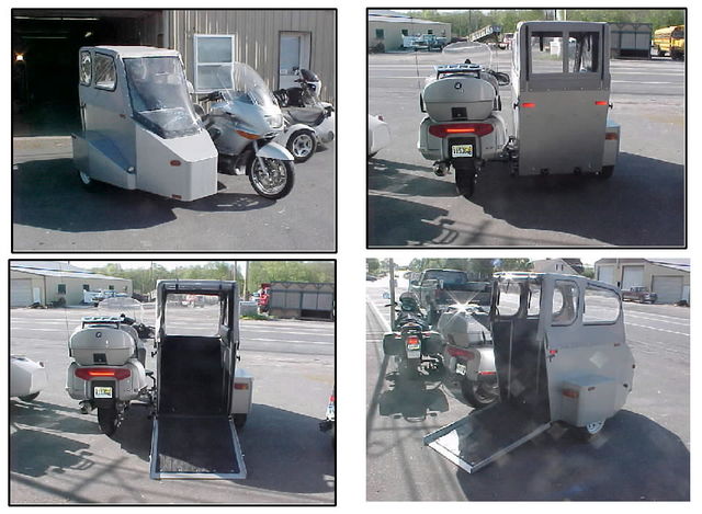

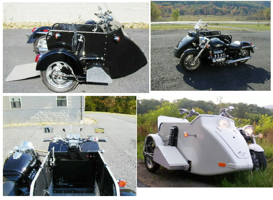

Operating a rig from a wheelchair in th esidecar is nothing new. In the states a company named Tomko built quite a few of these but is not defunct. The company that now does th emost of these is called Life Motors and is located in Pa.
Google 'Life Motors' to see some pictures.
We have done wheel chair accessable sidecars but none with the controls in the sidecar YET. I would recomend that the sidecar be a left mount if one of these type rigs is built.
Steering from th esidecar is typically done with linkages from sidecar to bike using stock type forks.

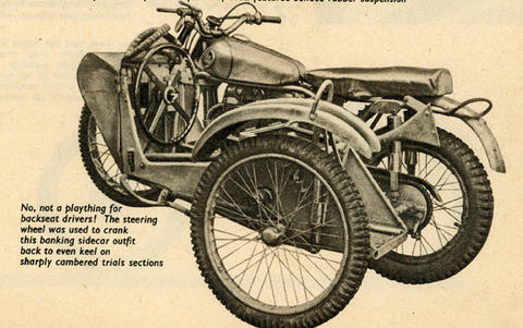

The rig in the video has an automobile type steering box on it. Some have used just a conventional motorcycle steering stem with a pimany arm off of th etriple trees connected to a drag link running over to the bike,
The attached picture with the steering wheel in the sidecar was one of a leaner rig that allowed th epassenger to vary the lean angle while the driver did the actually steering from the bike. Pretty wild concept. These type rigs were also raced at one time.
In the states a left mount sidecar, if it was to be driven from the sidecar, woudl really be the better way to go.
Also, rigs driven from th esidecar like a lot of whel lead for stability in turns away from th esidecar. Tire wear can be an issue on them.
