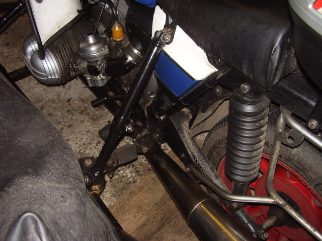

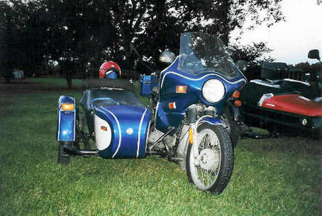

Yes, it is best to use a subframe on any BMW built since the /2. The /7 will do fine for you but add a subframe. See atatched:

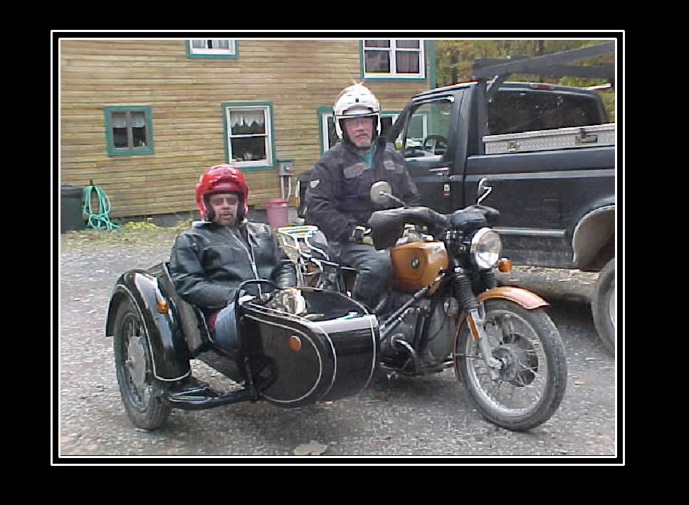

the R80 works well mine has no subframe but be careful where you put the upper rear fitting make sure it on the main frame. here's mine.
Hank
Posted : December 13, 2008 6:52 am
Like Hank said DO NO try and put a mount on the small diameter structure that holds the seat. Running the upper rear mount up to the main bike frame is essential. Even with that being done we have still seen instances of main frame failures on the post /2 BMWs. A subframe is really the better way to go for peace of mind.

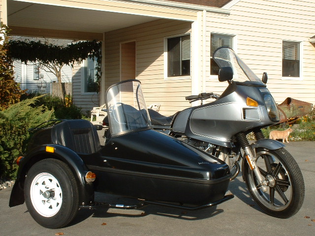

Here's a couple options.

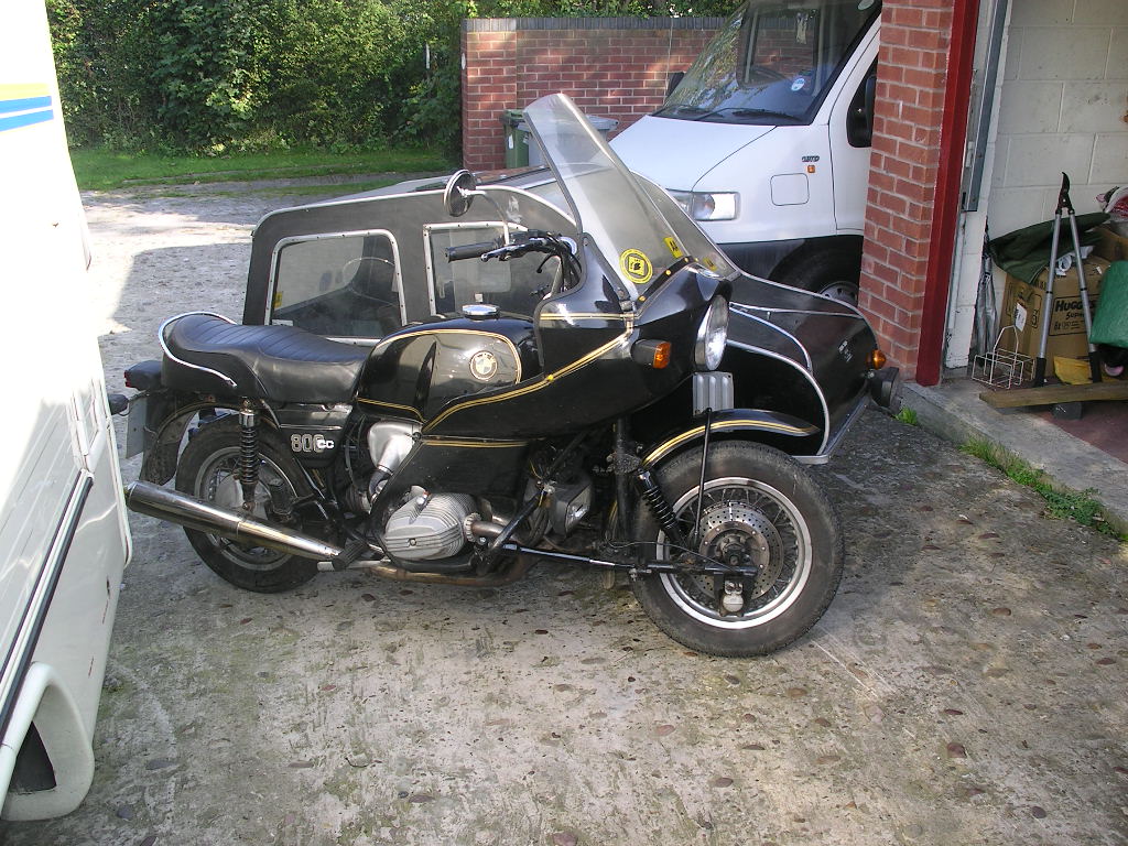

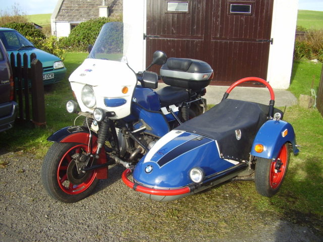

Here's mine. I hav'nt used a sub-frame and it's been ok for 18 yrs. Just dont hang on the rear sub-frame or the rear foot rest hanger's. Keep all fitting's on main frame.
Safe riding Karl.

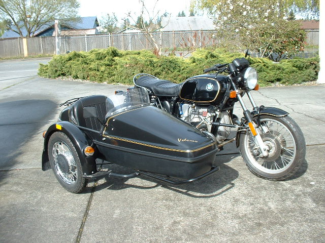

I like all 3 of them but really like the looks of that first one best. I think it's a Velorex or at least that's what the script looks like. I don't recall if you're a dealer for them so Is that rig one your own or one you're selling for someone?

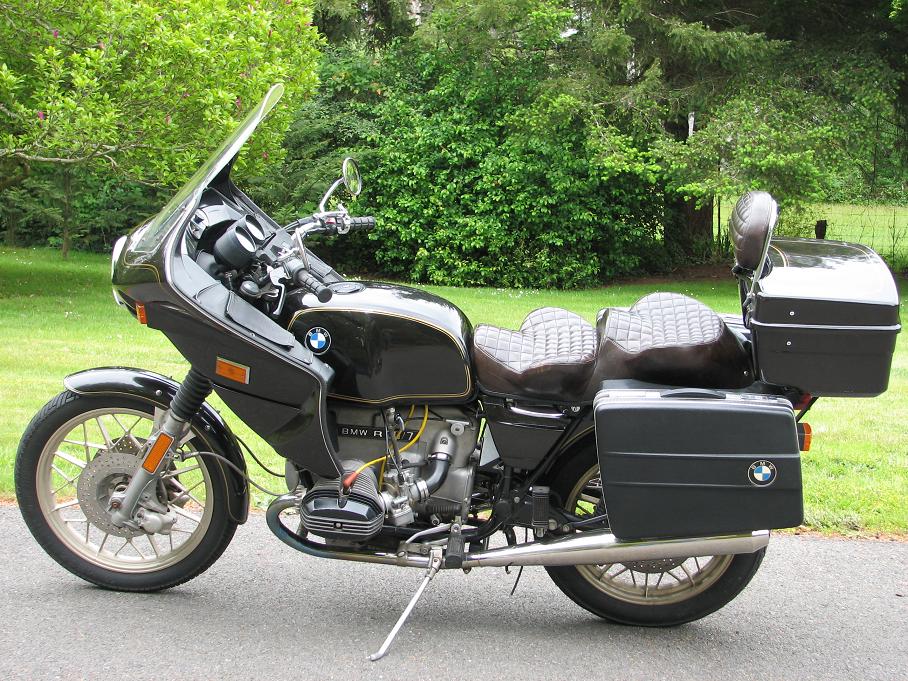

Here she is last spring. Wotta doll...
LL

That particular hack is one of the last Velorex 562E (Euro) models. It is a client's bike.
The 562E's were the more spartan model of the 562 Standard. Both were replaced with the improved 562 Cruiser in 2005 and 563 Tour models which share a similar body but are designed for use on heavier bikes than the early models.
My Avatar pic shows my personal 2008 FXDL/563 Tour combo.

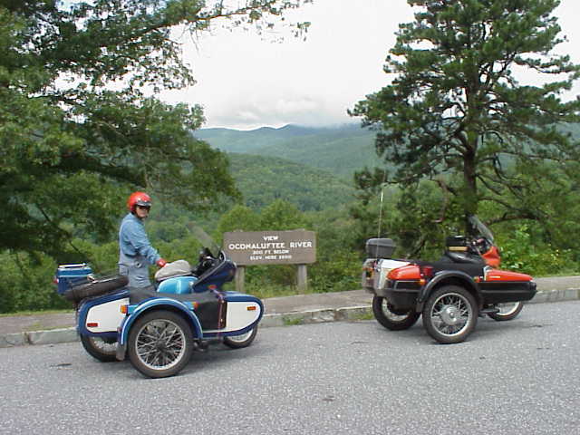

Nice looking rig Dennis, noticed the rig in front of you is the twin to my Sputinik. Both great rigs.
LL
