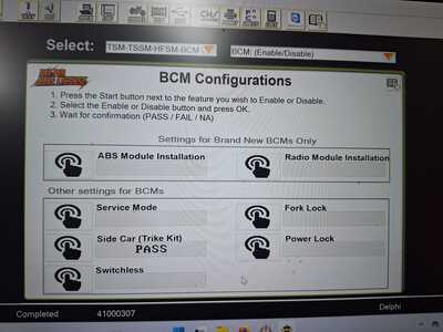

(@smitty901)
Posts: 801
20240725 114447
Think I can help you with this. Main reason is I have messed with it a lot.
HD no longer offers the kit to move BAS. Not a big deal. The sidecar/trike setting is a simple on off . Many dealers will not do it.
Who did the install ?
When was install Done ?
Posted : December 28, 2024 12:46 pm

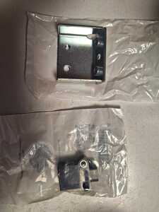

(@smitty901)
Posts: 801
This is the relocation bracket and the proper BAS V switch type.
20230919 184301
Posted : December 29, 2024 4:22 pm
1bmwmc, FlyingMonkeys, Thane Lewis and 1 people reacted
