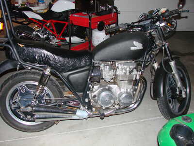

My buddy and I did that to his son’s CB650 redo – worked great.
DSC08419
DSC08838

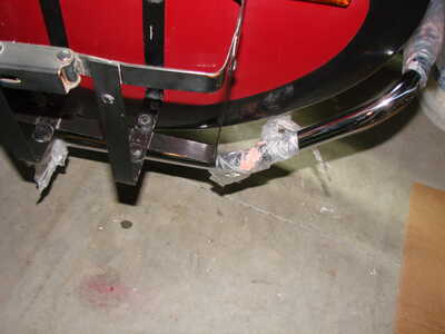

Also works on paint.
My old front bumper was chrome the PO painted red.
DSC09537
DSC09995
