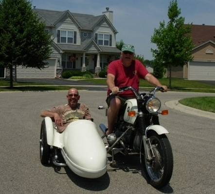

I want to install a steering damper on this bike. It is a 70-R75/5. After doing some research it seems like the damper should not be attached to the lower part of the front fork below the rubber boot. Is anybody familiar with how this could or should be attached? Does anybody make a clamp that will fit the /5 above the rubber boot. I was going to use a VW damper which seems to be a common selection by many.
I was also wondering if it is advisable to install a small windshiled on the front that is not frame mounted. I know that a /5 is known for tank slap but if attached to a car and damper installed it may be ok. If anybody has experience with this please let me know. The /5 is attached to a spirit of america side car. I would post a picture if I knew how. Will try but no guarantees.
Thanks
Eric
