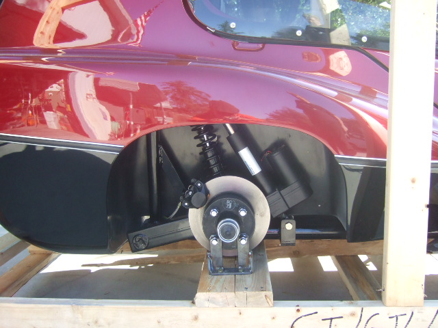

The electric trim is on my 2010 Hannigan GTL. It works quite well. At highway speeds the adjustment of the trim will actually take the bike through gentle curve. The trim motor is the same motor used to lift the blade on my snowplow.

Sassicat,
Yours is the four point mounting with an actuator that raises and lowers the suspension to adjust for road crown and load.
Johns' setup is a three point mounting where the actuator is the only upper mount which changes the angle between the bike and the sidecar, leaning the bike toward or away from the car.
The trim adjusters aren't really designed to be a steering device and shouldn't be depended upon for this service. The handlebars offer less chance of a surprise in a decreasing radius turn.
