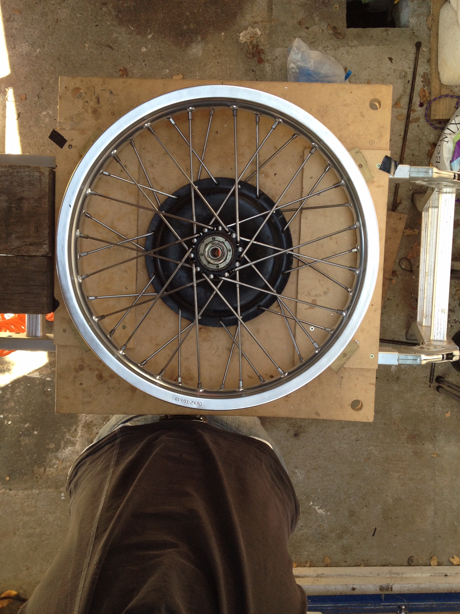

These wheels are Ural M72 type. I’ll include a photo.
I’ve built the wheels myself, and if I ccant get a spoke out easily, I disassemble the rim to swap them.
The original Chinese rims were way out of round. I’ve got 6 steel chromed wheels that came with the bike And all of them had a huge depression where the rim is welded. About 6mm deflection.
So I brought 4 new alloy rims, and stainless spokes from a reputable Chinese dealer (I know..) and asked a local vintage bike genius and long time Sidecar owner to show me how to build the wheels.
I built a jig to lace them while holding everything in the correct place, and a truing stand.
Unfortunately the rims supplied, were for a different style hub, so I had to, by hand and by eye, drill the holes to the correct angle. Then had help to make a cutting tool to cut the seats for the nippels at the correct angle.
Then laced and trued the wheels.
I think the spokes are good quality. I think that a simple test is to put one in a vise and bend it back and forth till it snaps. The spokes I’ve been using seem pretty tough on that test. I can bend them right over 4 or 5 times before they snap.
I’ve also tried a different type of spoke from a didpfferent supplier. I tried a couple of sets of yellow galvanised spokes from Oldtimer garage in Poland. Thinking that galvanised spokes might be slightly springier-less brittle. But they seem to be snapping the same, and seem to be about the same on the ‘bend till it breaks’ test.

Here’s a pic.

Not an expert here. But years on MZ, Jawa and Ural rigs have taught me that equal tightness of spokes is much more important then center and roundness.
When one gets loose soon 3 will break. Stainless steel does not help much, they are pure cosmetic and much softer then well hardened and unhanealed spokes and nipples. Threads must be rolled never cut!!! observe with the magnifier glass the thead surface and you can tell by the appearance. Tensile strength of rolled thread is with the same ground material factor 2 - 2,5. Thicker spokes are needed for rig use then solo use.
spokes may never be obligated and bow each other, small variations in drill axis and any error when lacing the spokes will cause great unwanted extra load.
Each time i lube my spoke nipples the wrench sound test is done. normally every 2500km. on a slow rig out of roundness does not affect much, 1 loose spoke will weaken and overload the neighbour ones.
2 cent out of a 3 rd world country with very bad roads.
Posted : December 29, 2017 6:17 am
you have bent spokes ( not straight headed spokes like mine ) that put the load on a bend ( like on bycicles) and on top 2 different lenght with half drum break.+s/c on the wrong side that puts even more load onto the weak long spokes.
outch not much I can suggest on this particular case.
drive cautious like a porcupine makes love.
Very cautious!!!!
