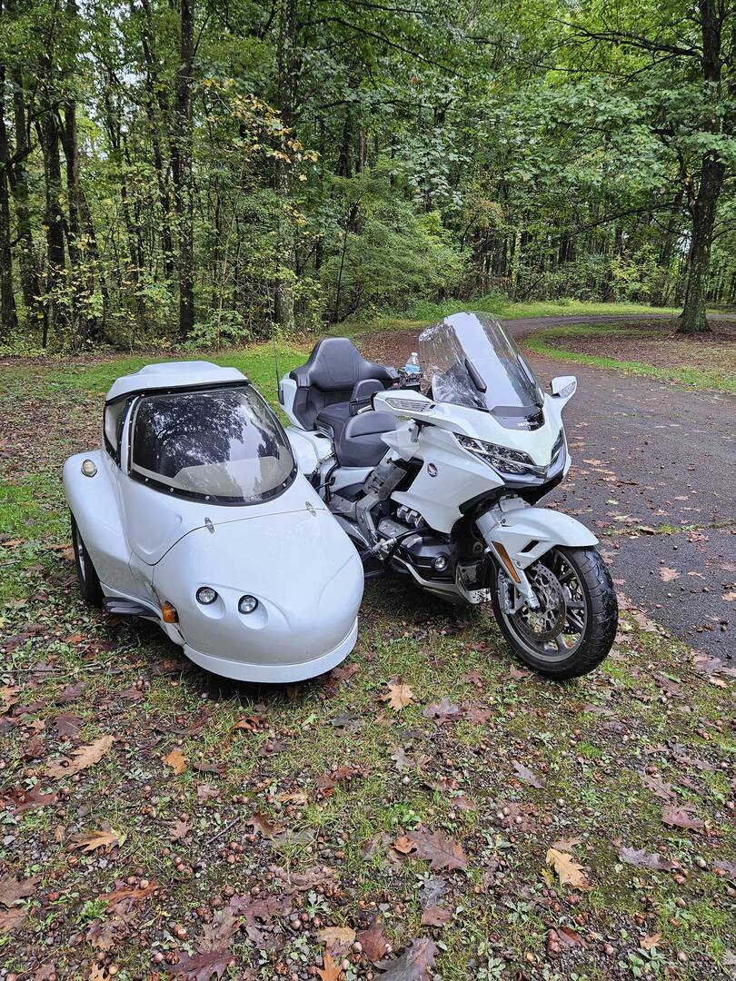

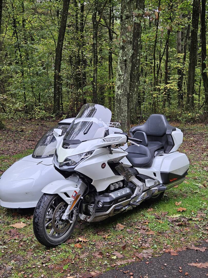

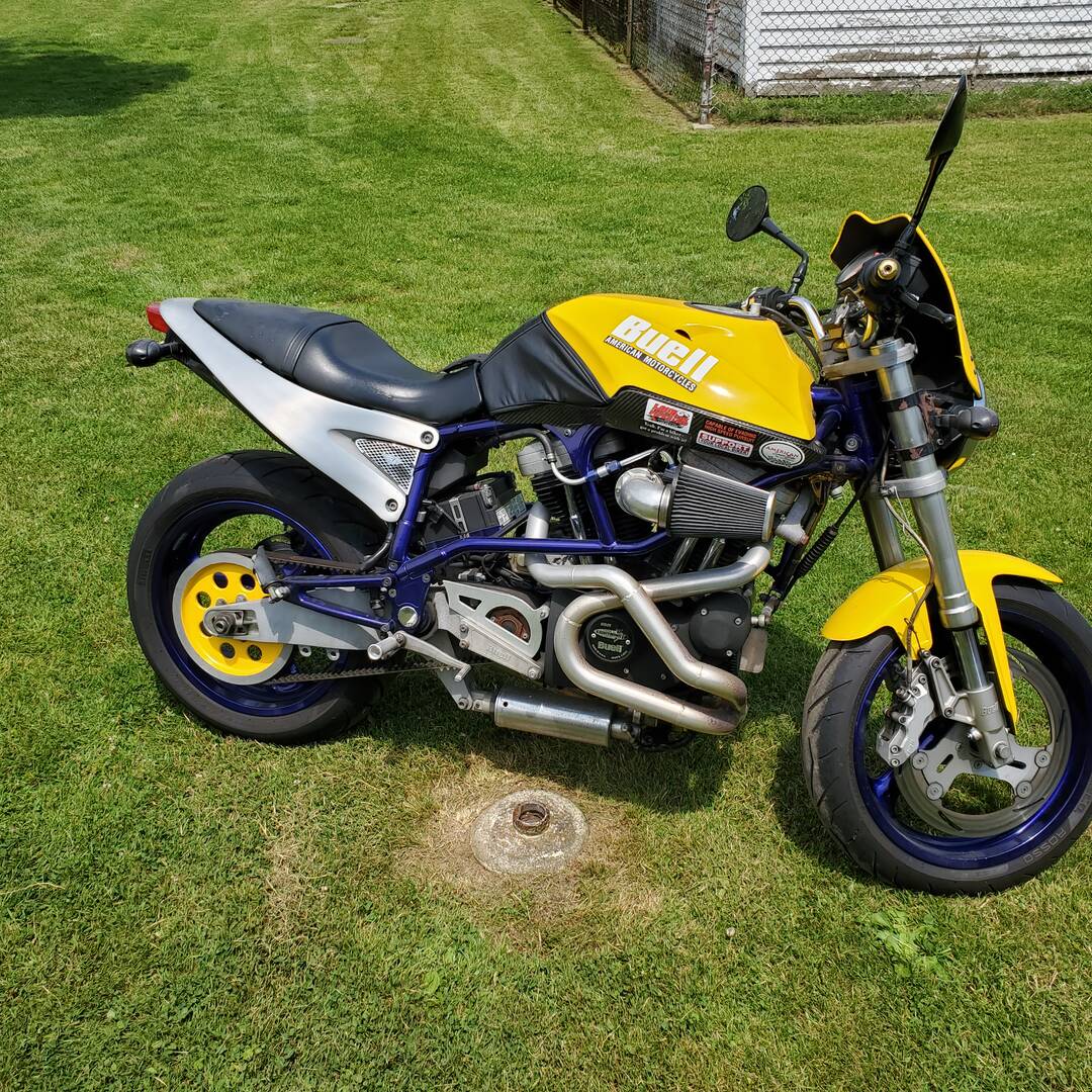

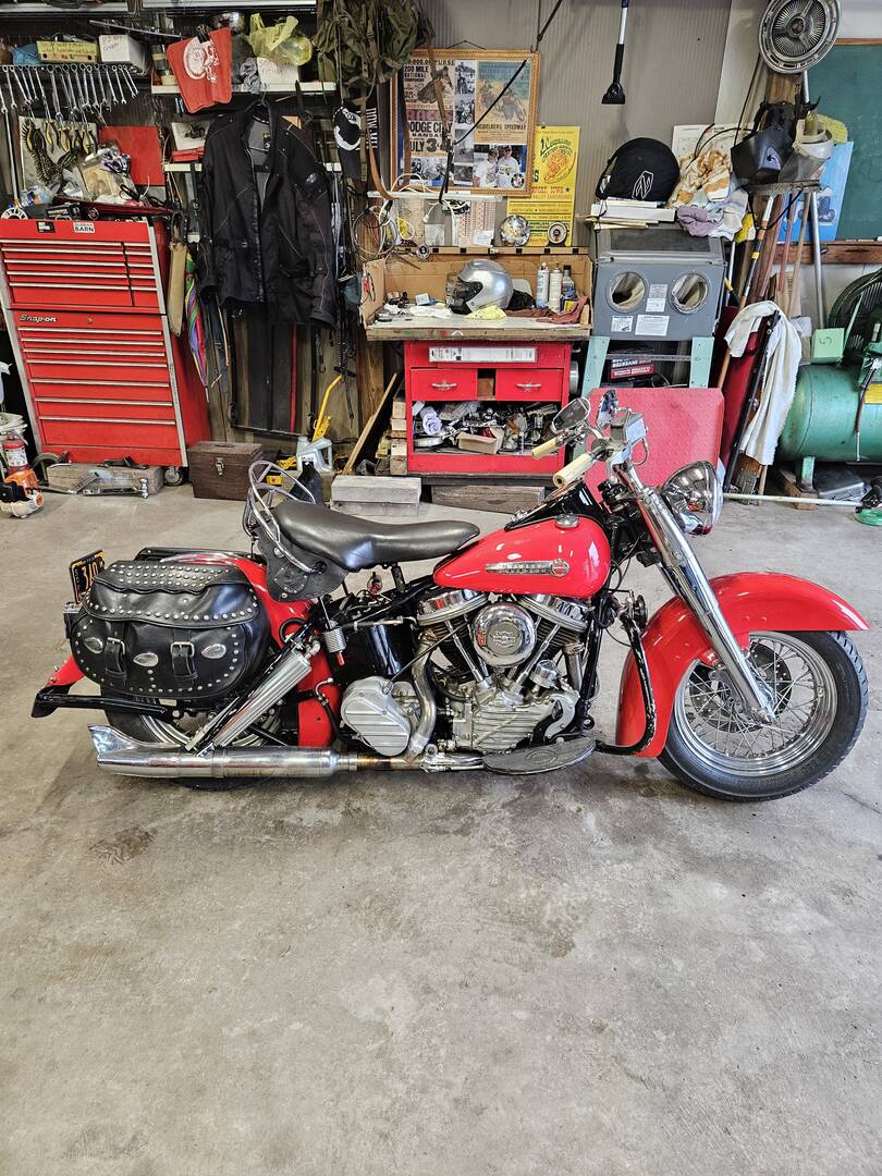

Here is my rig and my other rides for your viewing pleasure

Posted : September 17, 2026 1:03 am
SwampFox, MJ, Chris Murphy and 3 people reacted
Robert, the Red Panhead is nice... really nice.

Nice selection Robert.
The Buell is as close to a Harley as I would like to get.
it would produce a huge grin factor.

Oh my, the Pan...I had to download the pic so I could zoom in to better see the details. Outstanding.
