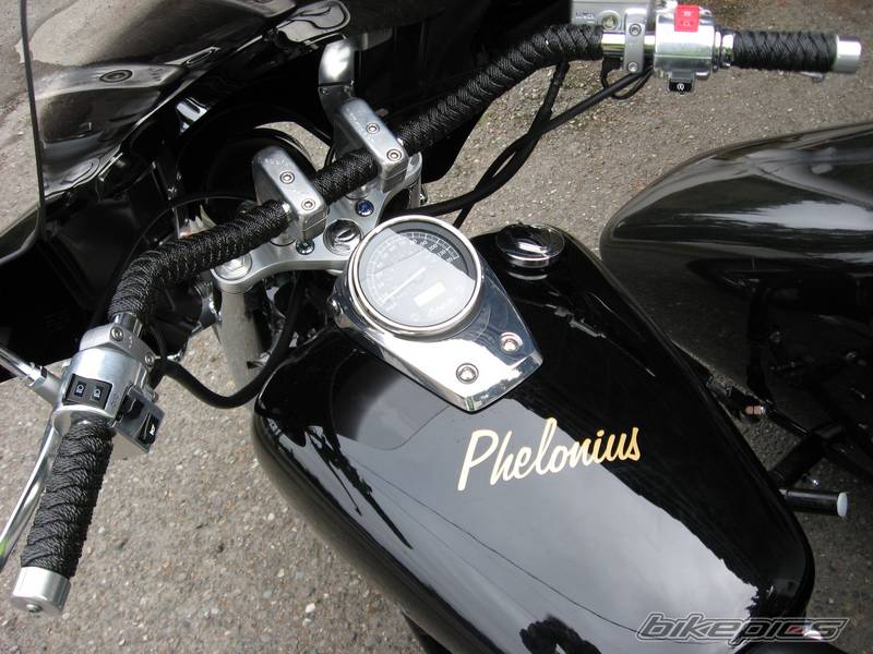

Whew!! Sure glad you weren't injured. I suspect the weld on the handlebars was weakened during the prior incident and finally broke over time - I also suspect this was the source of the extra wobble. Remember, sidecar rigs put lots more pressure on the bars than a 2-wheeler. Also, the riser likely added some leverage/flex as well.
As for replacement, I suggest avoiding welded handlebars if you can - try to find some "clamps" and tubular bars, such as on these rigs (photos from Hack'n albums):

On a solo those bars should last a long time. On a rig I would stay away from welded or tall bars. Just my .02. I even went from pullbacks to straighter shorter bars on both my rigs.

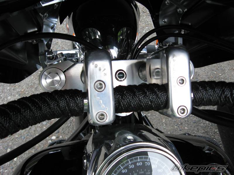

I made my own risers from blocks of aircraft grade aluminum I bought at Boing surplus years ago. I use a set of super bars I bought on the internet.
They have the right height and set back for me and clear the batwing fairing nicely. Notice that I also ride a Honda Aero. I fitted it with a steering damper from old VW supplies.
