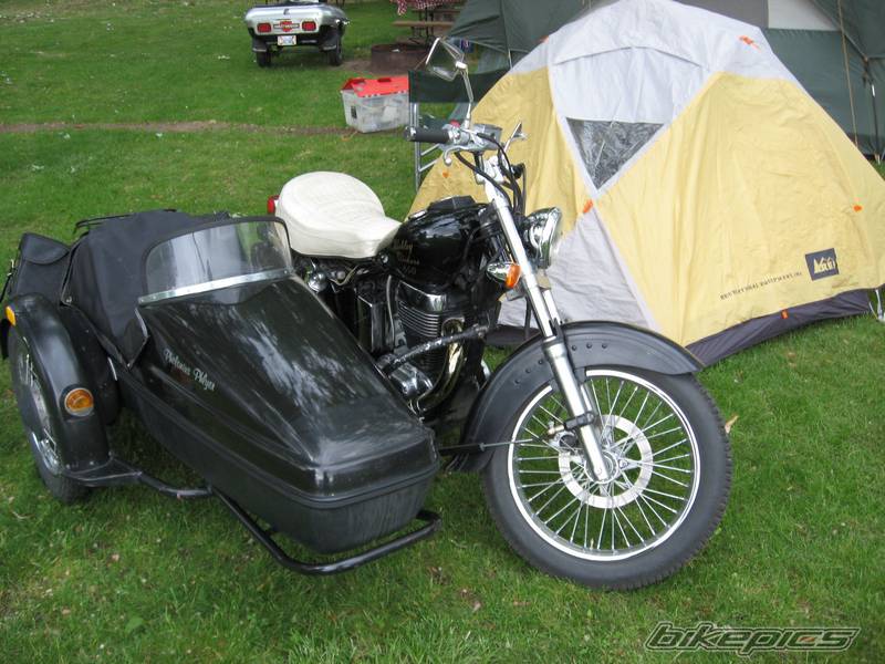

When fitting a special sidecar tire from Avon to a 19 " rim on a Suzuki S-40, I had to lift the front fender to gain clearance.
You may have the same problem.

19 inch X350 stock I believe it was the same for the Avon sidecar special.
Shown here with a Harley sportster front fender which gave much better rain protection.
Also note the comfort to be had from the 1965 Harley buddy saddle

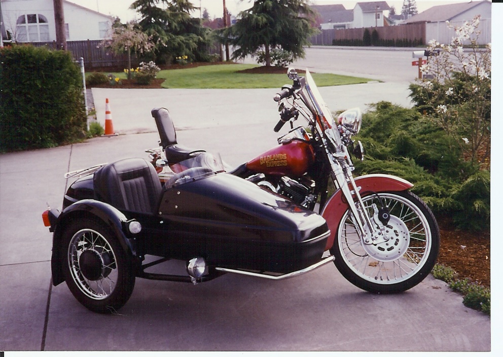

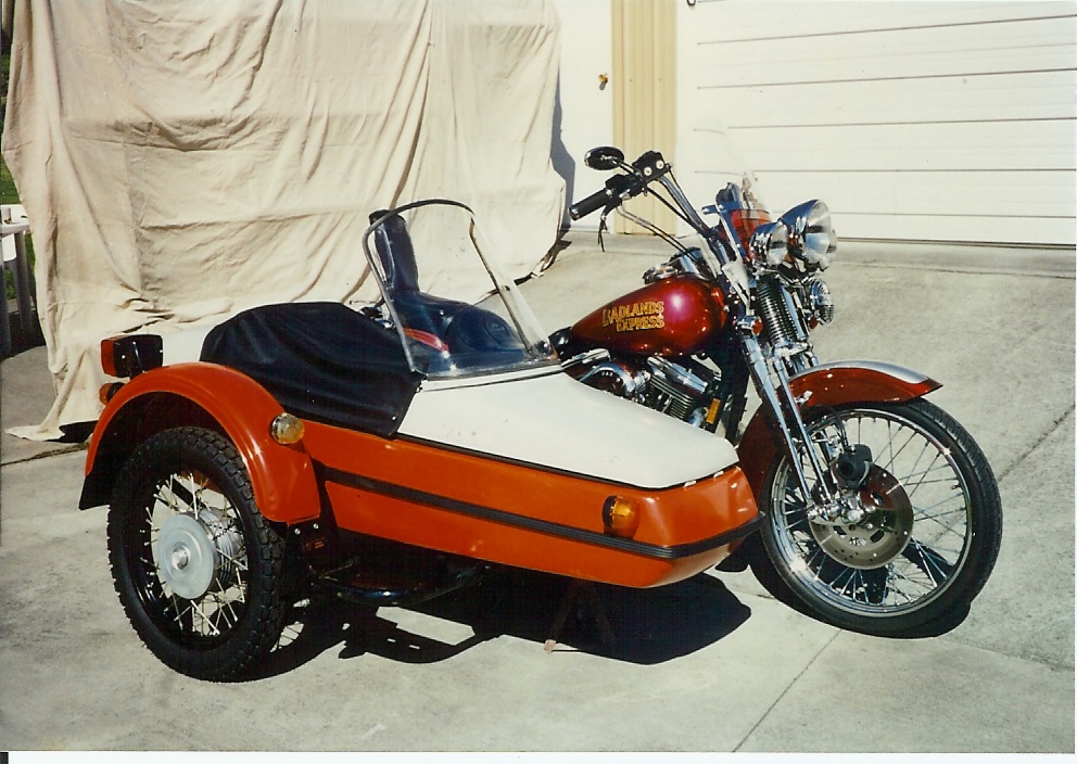

Had one of those Custom Chrome front fenders on my '87 FXLR/Springer conversion. Sure kept the crotch dry in the rain.
Later I dumped the primitive poorly made Sputnik for a more comfortable Velorex 562.
Posted : September 3, 2014 7:12 am
