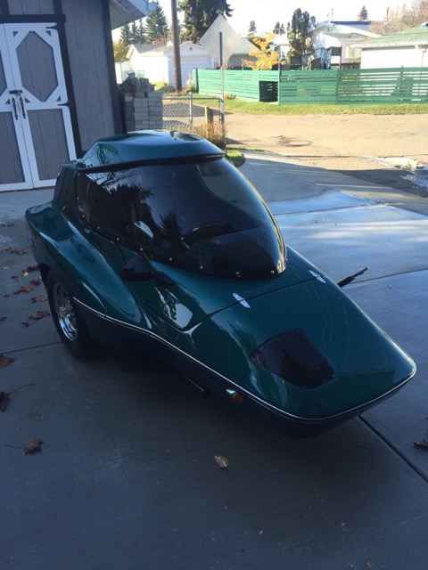

Hello I ride a Honda GL1800A and after riding from Edmonton AB to San Antonio via El Paso I came to realize that after a long day on the road trying to ride 2 up with a trailer in traffic is not fun. A friend had an older Hannigan Astro GT sidecar he was not using so he gave it to me. I have decided to try the sidecar route and ordered and installed the mounting system for the 1800. While the body is in getting painted I have installed the brackets on the bike and aligned the sidecar according to Hannigan's specs. The side car is equipped with an ECC. My wife likes to ride behind me so the sidecar will be used for stability and her shopping 🙂
My questions are;
1. Is ballast required in the sidecar and if so how heavy?
2. Hannigan says that there should be a 6 degree lean in the bike away from the side car. What position should the ECC be in when setting the degree?
Thanks
