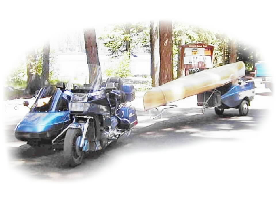

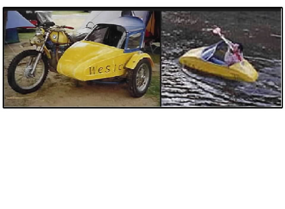

see attached
Posted : March 26, 2008 3:37 pm
Hello Claude,
The first foto is perhaps about how I must have looked like when I pulled the bed.
The last one is very neat - Congratulations to the owner!
Sven Peter
Posted : March 27, 2008 3:20 pm

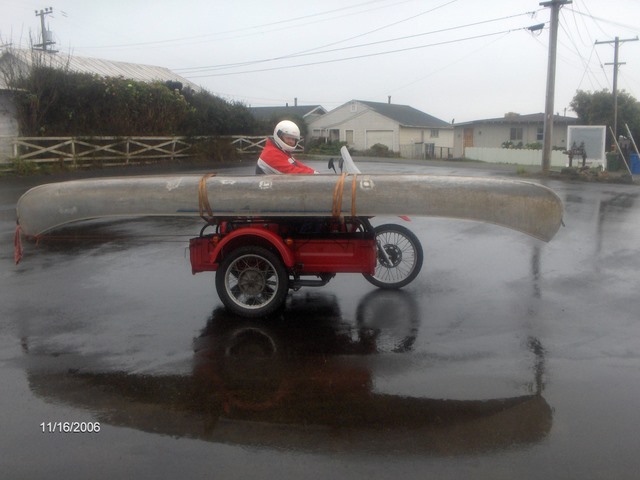

You talking about something like this?

Or you could go the route OLD SPOKE took. :0)Photobucket
Posted : April 2, 2008 4:24 am

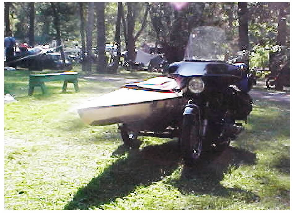

I was wondering if anyone had a pic of that one that was at the Finger Lakes rally a few years ago. It certainly got a lot of attention!
scott
Originally written by claude #3563 on 3/26/2008 10:37 PM
see attached
Posted : April 2, 2008 6:22 am
Now this thread has really got me thinking! Where does one buy something like ed pels moturist sidecars.jpg ?
Or how about the dog seated in the tub? It's a regular canoe conversion I assume. Would it be legal with the motor department though? Theoritcally just a differnt tub (no pun intended) i.e. a body on frame.
Carring the canoe/boat seems like a good idea. I do wonder how it effects handling etc. especially at higher speeds.
Posted : April 5, 2008 11:34 am
I would think crosswinds would pose more of a threat than road speed in handling. Canoes being hydrodynamic are pretty aerodynamic.
Posted : April 5, 2008 3:14 pm
(@Ivan-Rider)
Posts: 20
Originally written by Hack'n on 4/5/2008 6:14 PM
You got that right. The day the photo of my Canoe was taken I hauled it down Coast Hwy 1 about 5 miles before turning inland. The side winds and curvy highway was a little tricky but not uncontrolable. Had it been on a heavier rig then a KLR it might not have been too bad.
Posted : April 5, 2008 6:23 pm
Originally written by sdpc2 on 4/2/2008 12:22 PM
HI Claude;
scott
see attached
The last picture I posted was from the Finger Lakes Rally
Posted : April 5, 2008 9:11 pm
