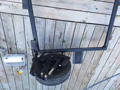

Frame back together. Friend coming over tomorrow to help lift tube on.
