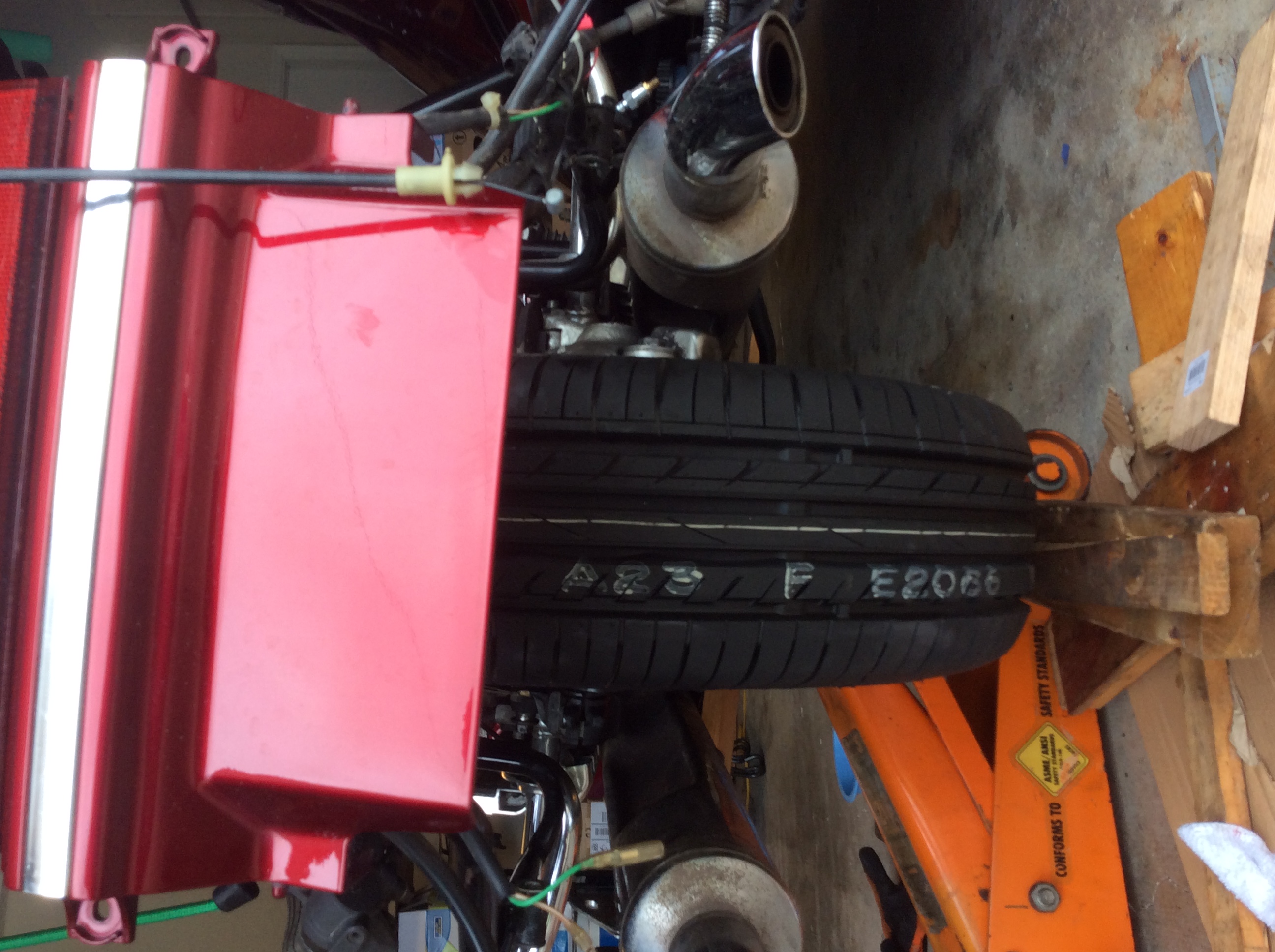

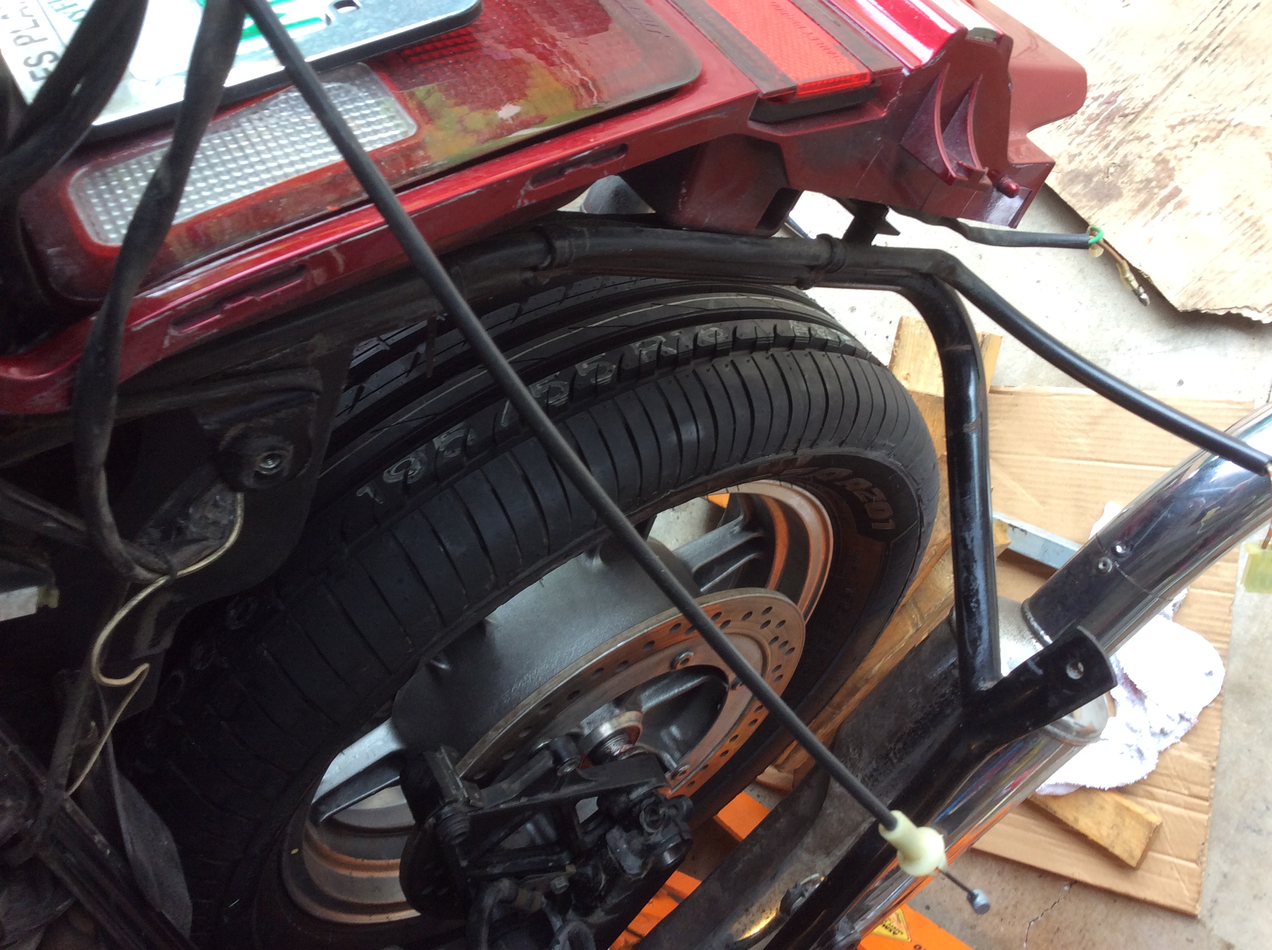

I have a Federal Formosa 195/55/16 on the rear of my GL1500 , 1995 with a Hannigan Astro 2+2. I bought another one to use when this one wears out . Got it from Easy Tires $65.00 delivered to my front door. ImthI think I have about 9400 miles on it with plenty of tread left.

How in the heck did you manage to get a 195 to fit in a gl1500.? A number of years ago I had a 1993 Aspy. and I couldn't get a Austone taxi tire to fit without rubbing on everything under there. I took it off and sold it. What did you have to modify ?

Hello Bone, NO modifications at all. I installed tire on rim and inflated it, then deflated the tire......sprayed some windex on the rubber and slid it in. I had the bike jacked up some and used a piece of cardboard and some 2x4s and pieces of plywood to get the tire up a little and wiggled it in. The cardboard on the cement floor makes it easy to maneuver into place. Does NOT rub on anything. I went to Wisoconsin and back with myi wife and out to the Arkansas Rally and back with her and no problems. It really fits in there pretty easy, and plenty of room left. The tire is smaller by about 1 1/2 inches. Revs are up but not that much and the quicker Acceleration due to the smaller diameter is pretty neat.

Yes it has basically the same dimensions as the federal. I was looking at that tire at the same tire. I went with the Federal because I read the article on mounting it to a Goldwing .. Let me know how it goes and how you like that tire.

Federal Formosa 195/55/16 will be lower then OEM tire. (not sure if 195 mm tire will fit in swing arm) You will lose some road clearance. Austone Taxi 175R16 tire little taller. Make sure you readjust your rig after you install new tire. Otherwise your new tire will be eaten fast.

Austone taxi tire will fit. Clearance will be about 1/2 - 3/4" on each side of swing arm. You will have to remove only small shield on front part of rear fender( if you don't it will be taken off by tire itself)
