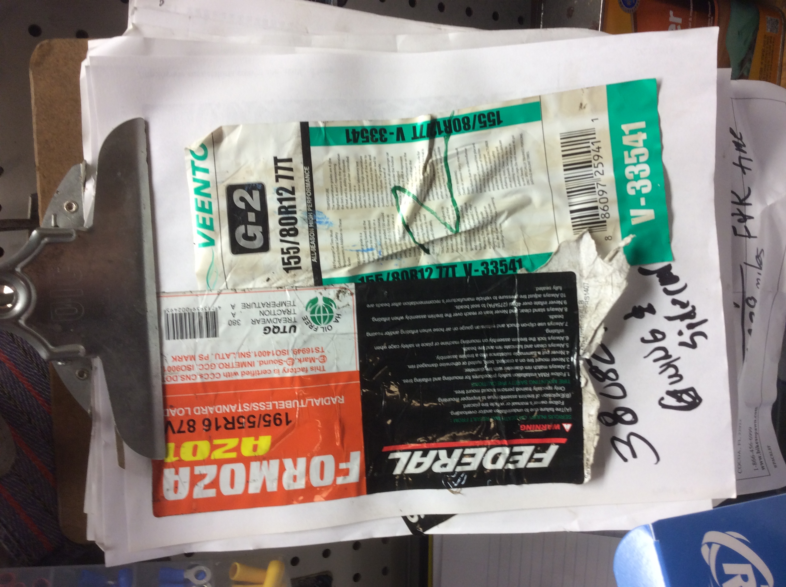

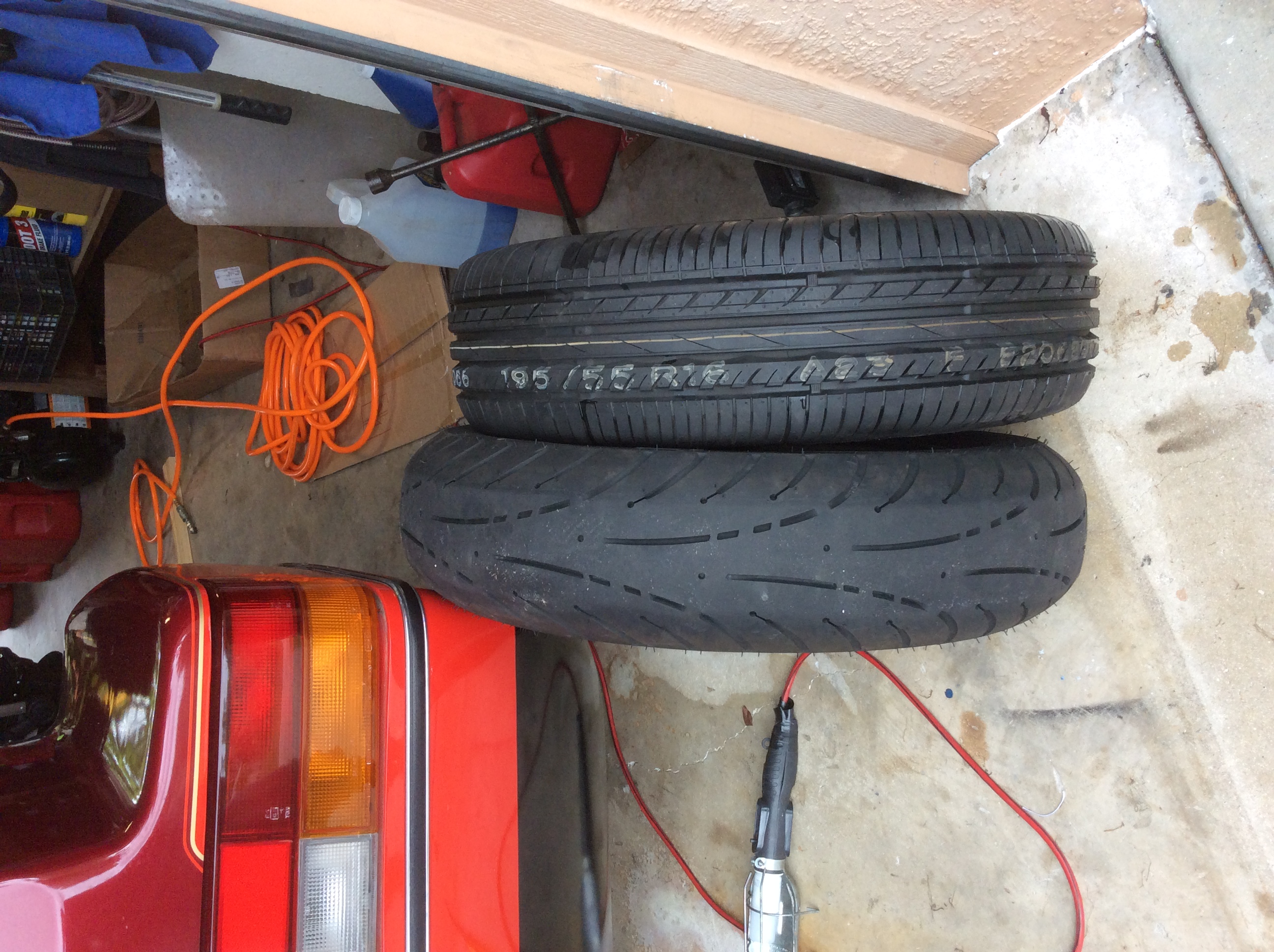

I have a Federal Formosa 195/55/16 on the rear of my GL1500 , 1995 with a Hannigan Astro 2+2. I bought another one to use when this one wears out . Got it from Easy Tires $65.00 delivered to my front door. ImthI think I have about 9400 miles on it with plenty of tread left.

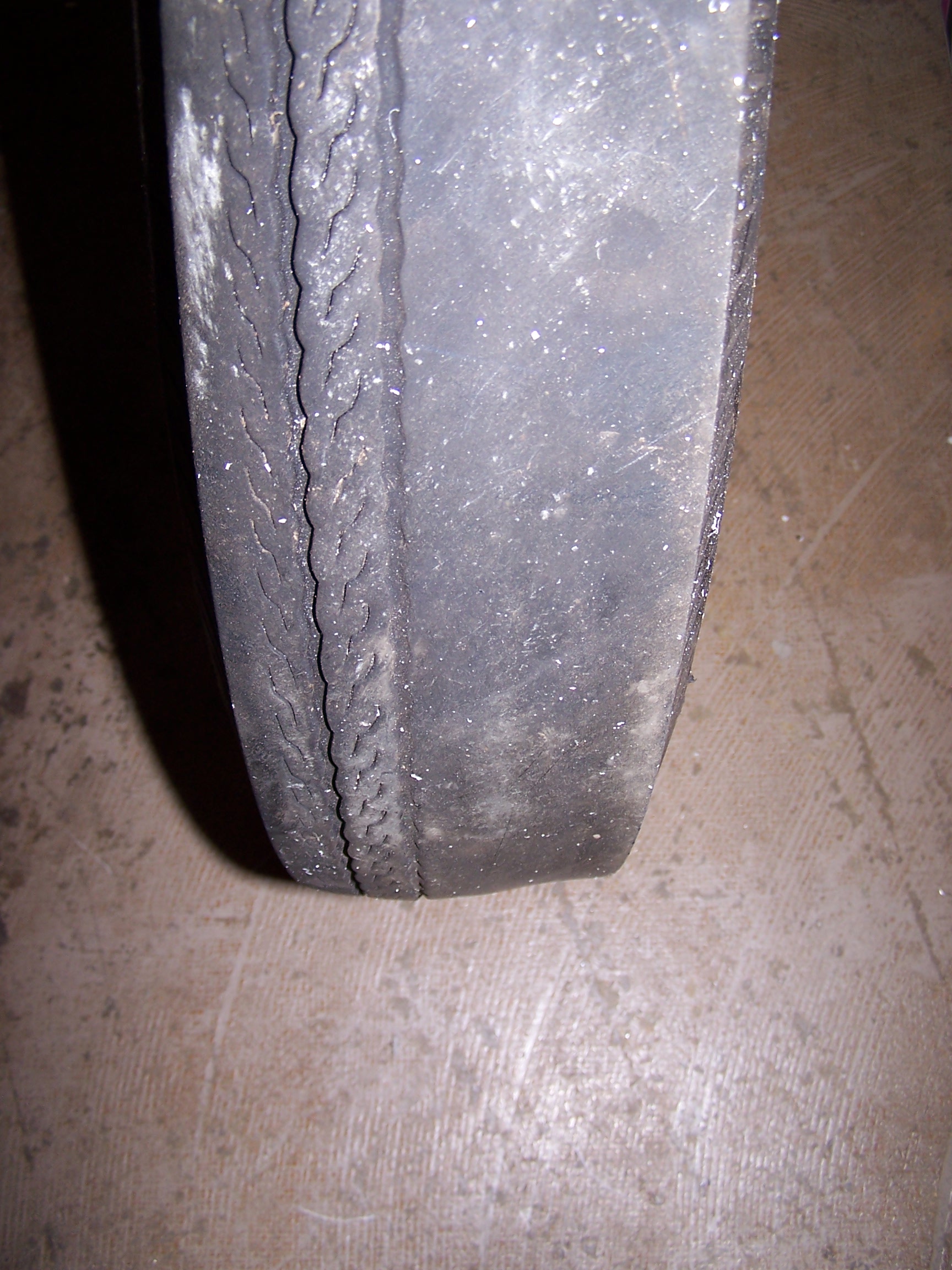

Make sure you readjust your rig after you install new lower or higher tire. Otherwise your new tire will be eaten fast. Make sure to do adjustment after changing triple tree. Picture of new tire after 500mi since tree replacement.

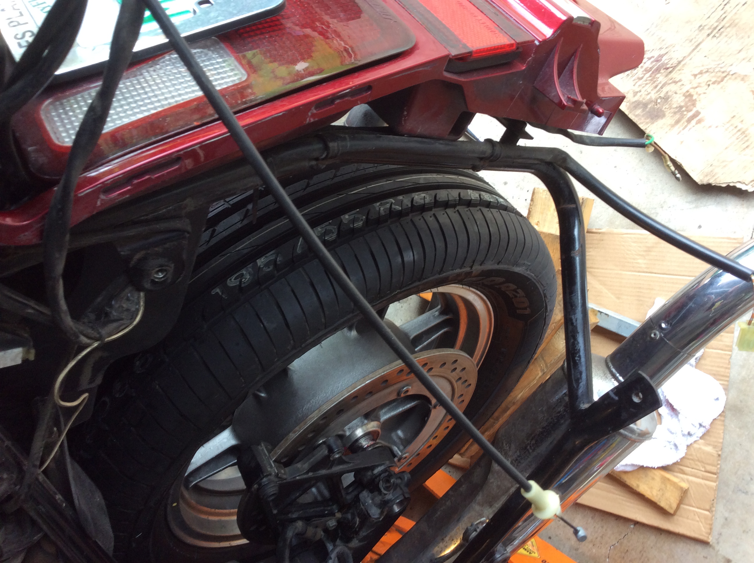

Positive about the size You can see it in my pics and I’ve included a few more . No issues with rubbing or anything. 195/55/16.

Thanks bentley. It sure does look like it fits just fine..... However looking at the last pic kinda a side shot from the rear.... everything under there is just to dang clean..... you need to get out and ride more. hahahahaha 🙂
