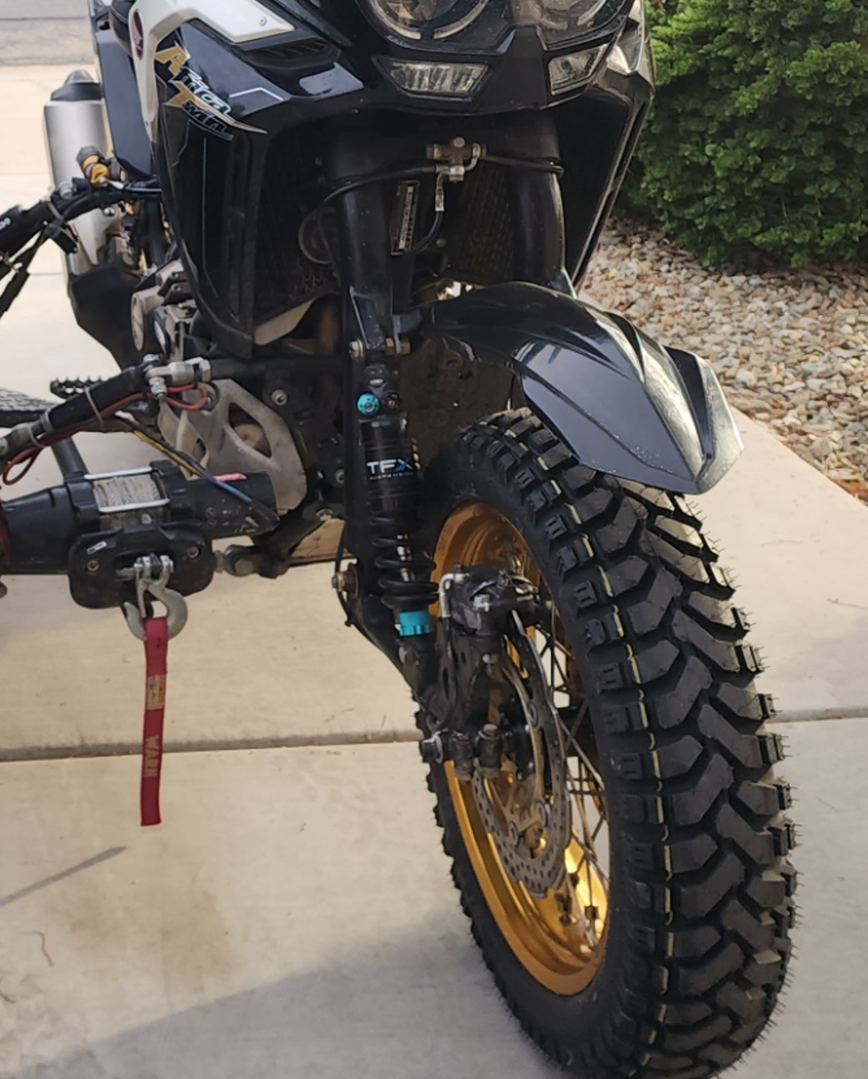

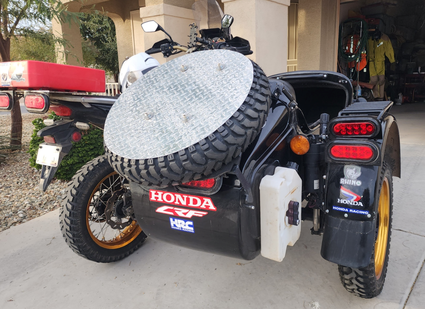

Hey Bogdan, welcome to the crazy world of hacks and opinions!  For what it is worth:
My Honda Africa Twin rig (CRF1100) has the same 4.5" x 18" rim laced to all three locations, sealed as tubeless. This is my preference, since this allows me to carry one size unmounted spare tire that could be mounted to any of the three locations in a pinch.  I wasn't smart enough to figure out a good way to run the same wheel/hub combo at all three locations on the Africa Twin, to be able to carry a mounted spare, like the Ural or some BMW's do.
It is a relatively heavy rig (1,050 lbs wet, as it stands) that I flog vigorously on highspeed pavement and do lots of power slides around sweepers on gravel roads.
It has been known to occasionally crawl rocks with friends here.  I like the same tire at all three locations, the Mitas E07 Dakar series, maybe called 50/50 onroad/offroad tire.  It has some decent size tread blocks and a reasonably soft compound for dirt riding.
Pictured below:
I have about 34,000 miles on the rig, since built new.  I keep pretty decent records about what I do to it at what date and milage.  Since new:
1.  I have gone through two front tires, average about 17,000 miles each.  The one shown just went on at 33,867 miles.  One was an E07+ with a little larger blocks and softer compound.
2.  I have gone through 6 1/2 rear tires in that time frame, with the average being 5,262 miles per rear tire.  Lowest that I remember was 3,748 miles, with the exception of one that I tore the sidewall out on at 1,026 miles, going over some junk in the desert.  Longest wearing was 7,500 miles, when I first got the rig and was scared to drive it at it's full potential.  Two were E07+ tires with larger blocks and softer compound.  I generally run the rear tires down to where I see cords.  There is 8mm of rubber and 3 more belts between air and air, once the first layer of cords it breached.  This can go another 800 miles before going flat, kind of a limp home mode.
3.  I just replaced the hack tire for the first time at 30,551 miles.  Could have gone a lot longer, but it looked kinda bad to strangers and the peanut gallery.
I think if I behaved myself and didn't cruise a little over most speed limits (speed limits are 75mph on AZ interstates), didn't slide around corners, and stayed off sharp rocks, I would get about 8,000 miles to one of these tires.  Harder street oriented tires might go 10 to 12K, but really, what fun would that be?

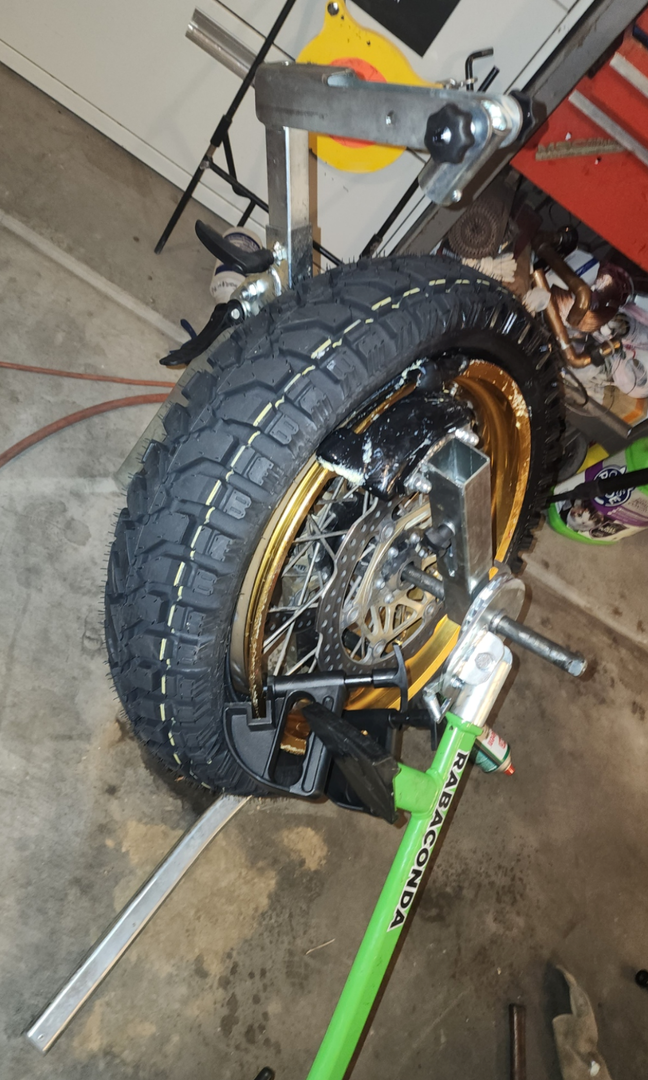

My solution was to just buy a Rabaconda Street tire changer and do my own tires (and a select group of friends' tires) myself.
I have practiced enough over the years with spoons to know that if I have to swap a tire on a trip, I could do it in a Motel 6 parking lot or alongside a dirt road.  I carry plugs, patches and a spare tire, so reasonably sure I could make it home from about any trip I could undertake, without having to source a tire along the way.
From my reading, some people get pretty decent milage out of a car tire.  I have heard rumors of 20k+.  Some, well, not so much.  I think you could easily install a car tire with the Rabaconda unit on about any appropriate sized MC rim.  The sidewalls are a lot softer on a car tire than the Mitas E07 Dakar series units I use.

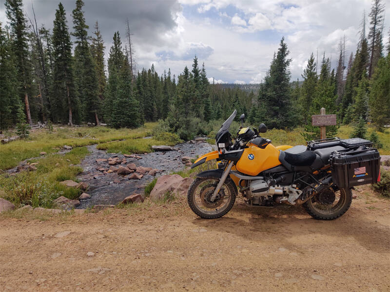

I think "use case scenario" would dictate the best way to go, and expected mileage.

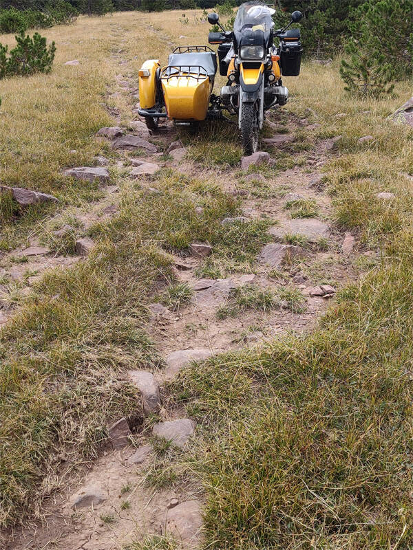

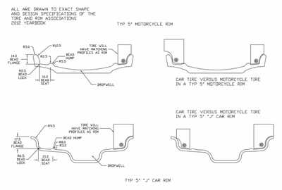

Seems there are many who install car tires on motorcycle rims.  My R1100 GS based rig came with a car tire on the stock motorcycle rim.  That tire had at least 8,000+ miles.  Maybe as much as 11,000 miles (previous owner records aren't clear when it was installed).

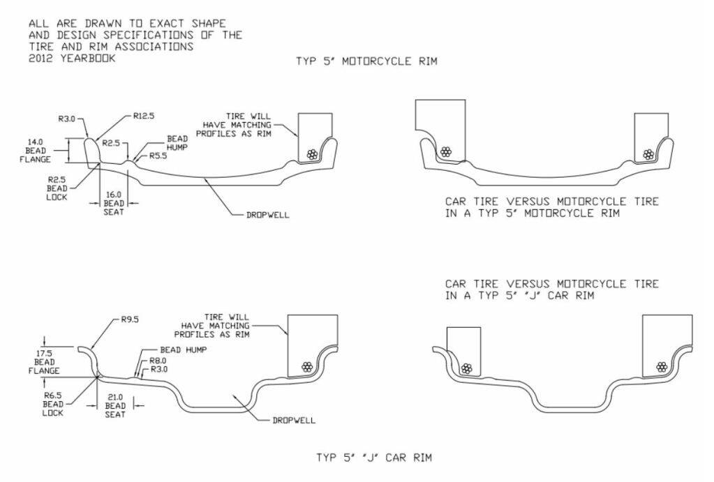

Tens of thousands of trouble free miles have been racked up by a lot of sidecarists with this combination.  That wrote, a car tire and motorcycle tire have different bead dimensions, and the car tire doesn't fit quite correctly on a motorcycle rim.  Also certain rim diameters don't match between a car and motorcycle (I can't remember for certain which diameter is an issue, but it is well documented).  The most correct way to do this is either with a hybrid wheel assembly (mating an automotive rim to the motorcycle hub/disc), or using an adapter to run a car wheel, with the proper offset to maintain proper geometry on the bike.

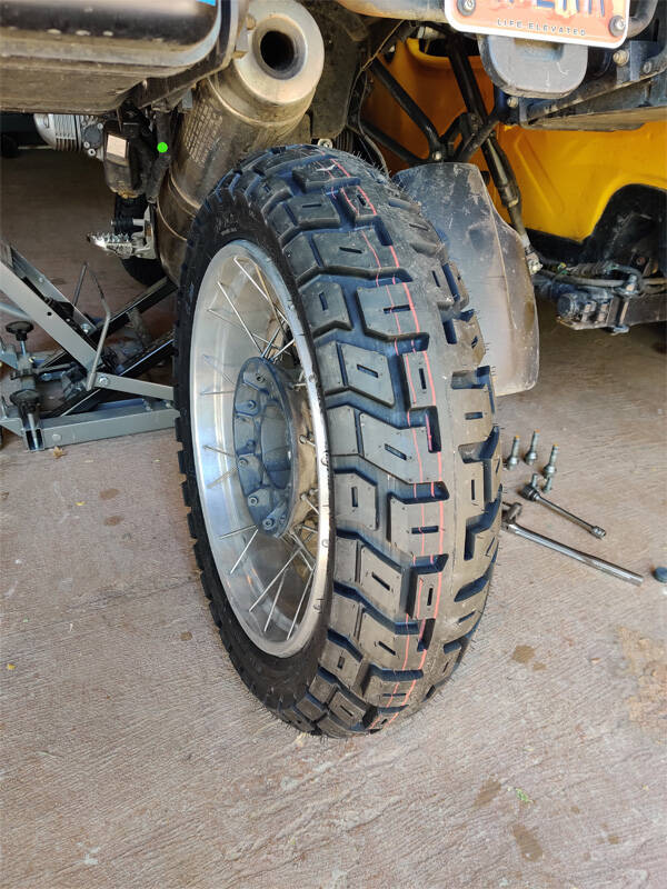

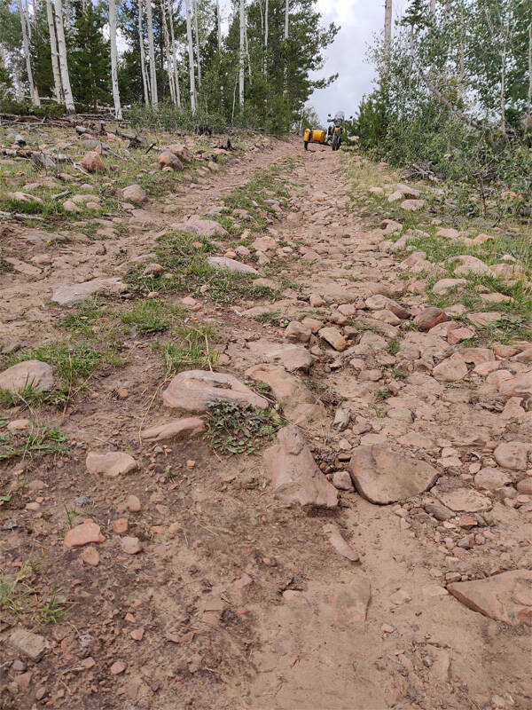

I replaced the car tire on my rig with an off road-centric tire, because this rig sees some pretty aggressive ATV and Jeep trails.
Rear Tire Mounted Mostly Of
Trail Less Worn
Long Way To The Top
Pole Creek
Then did a bit over 4,000 miles on a road trip adventure. 😆   It still has about 1,000-ish miles left.  This mileage includes a few power slides, and emergency braking on asphalt, as well as some aggressive off road miles. Had I chose a slightly more street oriented tire (like the Dunlop Trailmax Mission), that mileage would increase significantly.  But off road performance would suffer.
Horses for courses. 😎 Or should that be "horse shoes" for courses? 🤔

Tire dealers and bike shops (that you aren't best friends with) won't mount car tires on motorcycle rimes because of the different shaped beads on the tires and rims.  I use a car wheel and tire and while on the final leg of doing the Heart of the West Adventure route, I needed a tire.  I was able to call ahead to a Less Schwab in Rawlins to get a tire ordered to arrive when we did.  When I pulled up to the shop with my sidecar the Manager came out and said he can't mount the tire for me.  After I showed him that I had car wheels not motorcycle wheels he had no problem.
With BMW (& perhaps other shaft drive bikes?) a simple adapter plate makes mounting the car wheel a breeze.
