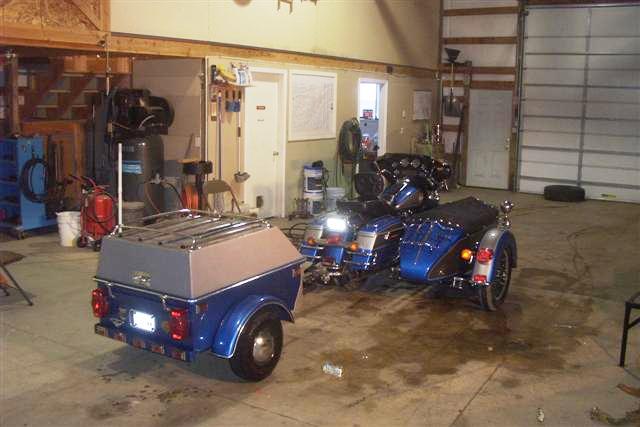

What Old School said plus the fact it's easier to push a rig backward on the few times it might be necessary than a solo bike. No fear of dropping the bike. My first rig was a Ural and had the reverse. I've had the Liberty on my FLH for a good number of years now (15) and although I worried about no reverse when I first sold the Ural and got the Liberty, it's not an issue. I haven't run into a situation yet where it was needed. Even when towing my little trailer.
