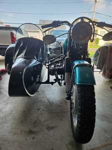

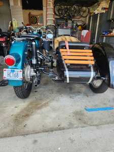

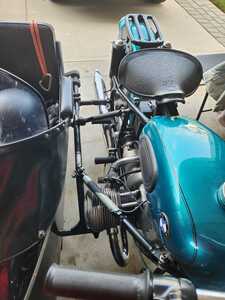

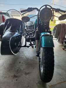

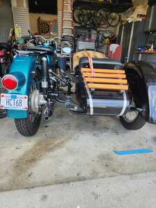

The sidecar has a 1959 LS200 frame with a Globe tub. First try I put it on as it was assuming things were more or less already set for the bike. They were not.  The rear ball clamp was on upside down so I remedied that.  The pull rods were frozen and needed some heat to free them up for adjusting. Moved the front swing arm forward and the front shocks to the lower mount for preload.  Preloaded the rear with the lever adjustment.  It's rigged up nicely now with 1.5" toe in measured 6' in front of the bike.  There is a bit of positive camber on the bike and maybe a bit too much positive camber on the sidecar, but it handles quite nicely.  The front pull rod mount is in an odd place to me.  I have seen pictures of LS200s with only a single pull rod connected to the read mount, and I have seen the front pull rod connected to the lower front part of the sidecar frame, but I haven't really seen it the way mine is.  I was wondering if the mount welded to the sidecar frame is stock or an addition for some other previous outfit.  Have a look at the pics and let me know what you all think.

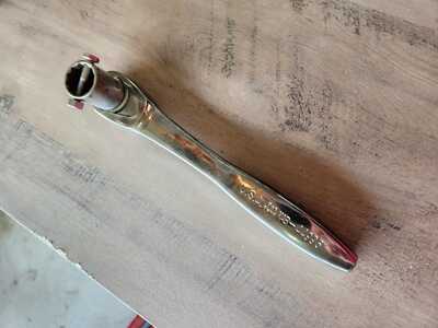

also a pic of a tool I made from an old socket to tighten ball clamps

Welcome to the wild and wonderful world of sidecars. That is a beautiful classic set up you have.
As you discover the science/art of adjusting the lean out and toe in, keep in mind that each rig and rider is unique. What works for others may not feel right to you. Consider the tire wear to determine what further adjustments, if any, might be needed.
