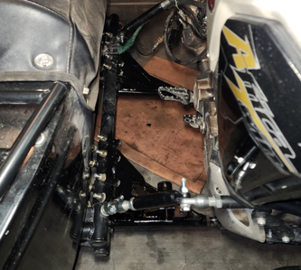

So, here is what the next evolution is looking like:
Most of the welding is connecting the old A arm reinforcement triangle plate to the new A arm triangle reinforcement plate. Both are 1/4" steel.
We are not zooming in too close on the welding... It would have been nice to have done it on a bench, but I wanted the clamps already tight on the frame tubes, before welding, so did it on the bike.
The view from underneath the tub... Where I spent considerable time fiddling with getting bolts in and tight.
Cut the front one at a little more of an oblique angle, to accommodate the winch mount. Since the winch mount was welded so nicely to the triangle plate, I welded the brace to both.
Stuff finally cooled off enough for a rattle can of Krylon to turn it black, again.
Sure, there are cleaner, better ways of doing it, but I think the A arm breaking problem is likely taken care of.
Now about that 3rd top strut... stay tuned.

Thanks for the extra pics.  I get it now. Sort of.
How do you make sure that the brace is welded precisely enough that the new brace isn't taking most or all of the load and the original clamp becomes underutilized?
Or would they naturally alternate which one get most of the load based on the dynamic positioning of the sidecar?
Wish I was more of an engineer.

@andrew-baker Drew, I'm thinking that tightening the clamps up, with the brace in position to be welded, should do the trick on load distribution.
The lower A arms are loaded, but not to the point of deflection, when the rig sits still.
The braces don't have any load, at that point, but even a slight deflection on the bottom clamp would try to compress the top brace.
As long as the welds hold to the top plate of the lower A arms, the top braces will not want to compress very much.
Didn't do any finite analysis calculations (surely forgot how, by now!), but thinking it is strong enough not have the same failure mode, and that the whole system is significantly stronger.
I think spreading the load off the rear top mount, over to a center strut, is the next big system strength improvement, prior to chucking the whole thing and starting over.
Hoping to buy myself another couple of years of riding, out of this system, after enhancements are made, though.

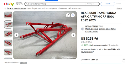

Aluminum subframe ramblings:
Just for fun, wanted to see what it might cost if I totally grenade the aluminum subframe...
Found one on Ebay, that with shipping would be about $410.  Would suck, but not crazy, all things considered, if it were really necessary to buy another one.
Link to ad.
The pic in the ad shows the cross piece that connects to the other side, at about the point the top mount connects to the subframe.  Not saying connecting to the aluminum subframe is a good idea, but as part of a system, it might be stronger than imagined.
It doesn't look like it would be all that difficult to replicate this subframe in steel.  That might be on a future agenda, as I contemplate options for redesign.
If the current aluminum subframe breaks, that might accelerate that little brain fart.  Otherwise, will probably leave it alone and just run with a new center top strut for awhile.
