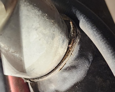

The width of the bearing surface is about 3 mm, so side load, from acceleration/deceleration rolls the end of the tubing over and creates slop. When the struts were disconnected, I could deflect them about 15 degrees in any direction, without first loosening the "tight" bolts that were loctited in to the mounting point threads.
Pic shows bearing surface on mounting point and kinda messy tube it butts against when the 3/4" fine thread bolt is torqued down.

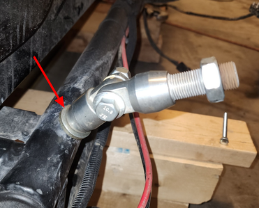

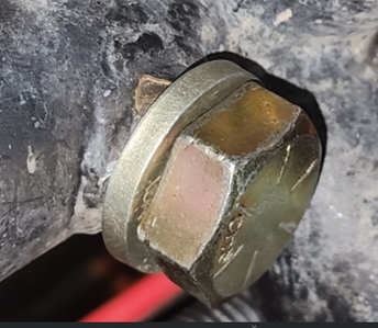

Not sure if I understand why a washer is needed here (see arrow) --
But, wait, is this the one you shortened so that it would screw almost all the way in without bottoming?
Posted : December 14, 2024 12:09 am

@ned I like Ben's thinking here. Up here those grade 8 washers are known as tension washers. Hardened so when torqued up they don't deform like a normal grade 5 washer will. My thinking is, once torqued up that tube the bolt goes through is now in compression with a hardened surface on each side, less chance of coming loose or moving with the pounding. Maybe over kill and I could be out in left field too.
Posted : December 14, 2024 1:08 am
Brstr, DRONE, FlyingMonkeys and 1 people reacted
(@ben-franklin)
Posts: 327
@mgv8 Brian, that is exactly my thinking.  The end point surface is much narrower, smaller diameter surface than the face or surface of the tube that it was tensioned against, without a washer.
The side load forces on the strut, mostly acceleration and deceleration differentials between hack and bike rocked the strut back and forth, with that narrow surface digging in to the soft steel tube face.

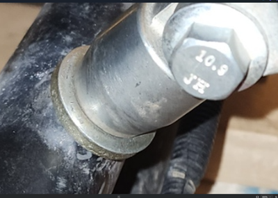

This is what it looked like, prior to disassembly:
I like to think that the hard steel washer will not deform as easily under those forces, and will spread the force over the entire surface of the tube end, not just a narrow ring on the inside of it.

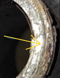

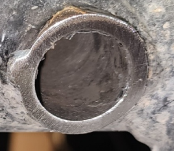

Yellow arrows show the face of the mounting point.  It was not flat, rather tapered, so the inside edge was all that really touched the tube:

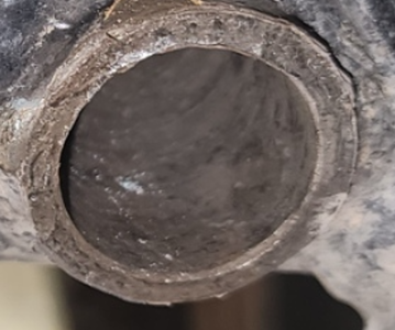

This is the face of the tube, prior to cleaning it up.  It had a deep groove worn in it from the tapered mounting point rocking back and forth on it:
Lighting is better on the front tube; shows the ridge/groove that the end point rolled/gouged into the soft steel.  A few thousands of an inch translated into quite a bit of movement at the end of the strut:
After cleaning it up with an angle grinder and file, it gives the hard, flat washer more surface area to sit on.  Hopefully to stay nice and tight against, with no rocking movement.
Blow up shows just how much smaller diameter that mounting point face is, when compared to the washer and tube face.  I suppose if I were smart, I would take it down 10mm or so to get rid of some of the taper and give it a wider contact face.
It was a similar story on the other side, where a split washer was installed as the locking feature.  The split washer could flex as the bolt was rocked back and forth, thus wearing a groove into the tube from the split ends of the washer and making things looser and looser.

@ned Yep, shortened the big, new bolt to just about the full threaded length of the mounting point, after accounting for the two washers and tube it passes through.
Old bolt was too short for decent thread engagement with only one washer.  Probably only bolt they had, so they didn't bother to put a washer on, between the mounting point and sidecar frame tube.

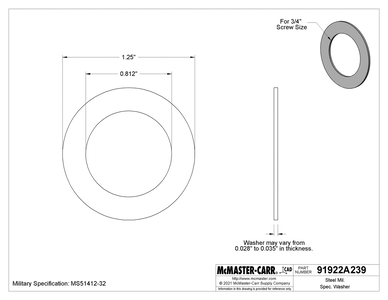

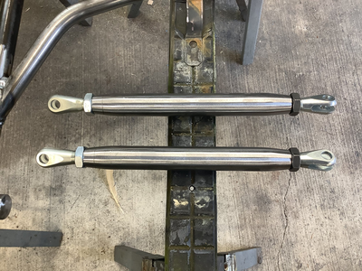

Follow up question.  I actually reworked all my DMC struts last summer more or less the same way as you except with much thinner washers. Rockwell B40 which is at the high end of Grade 8 hardness, but much thinner than yours. THESE --> https://www.mcmaster.com/91922A239/

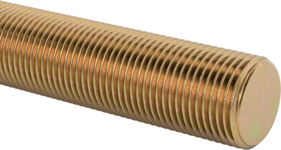

I also replaced all my 5/8 threaded rods with Grade 8.  These --> https://www.mcmaster.com/3313N805/
Cut to length to get max thread engagement.
All the 3/4" stuff (bolts, washers, jam nuts) also got replaced with zinc-yellow chromate-coated Grade 8 stuff.
I didn't flatten the mating surfaces like you but my mating surfaces looked OK in my recollection.  Can honestly say, though, that I did not inspect them closely.  (and my close-up eyesight is kinda sucky haha)
My follow-up question is, you think I'm OK with the thin washers? Keeping in mind that my rig is not getting torture-tested anytime soon.
Posted : December 14, 2024 2:39 pm

@ned Ned, i think for any sort of normal driving, the thin washers will be just fine.
I was standing in front of a rack of bins at the local Ace hardware store that happened to have both thick and thin washers, so I just went with the thick ones because I could, and I planned on trimming the bolt length to fit for max thread engagement, anyway.
Thanks for the link to Mcmaster, I am shopping for ends and internally threaded rod to make up the 3rd strut.
I am contemplating replacing the other two, as well, to get more thread engagement.  If I do replace the existing struts, I think I will use ones with both left and right hand threads, like Chuck does on the ones he makes, so they can be adjusted without removing the ends.  (Turnbuckle style.)
Posted : December 14, 2024 3:08 pm
Posts: 633
Yeah, the "Chuck-style" struts are the bomb! Definitely better than the "one-way" struts that the big sidecar makers sell.
