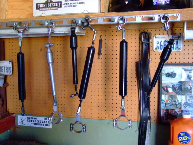

Jay mentioned a leading link front end. I adapted a /2 Earles front end to my R90. Of course it needed a steering damper which made it steer hard again. There has to be a better way than VW dampers. I used the a VW bus damper.

I have three of the long dampers that most of the sidecar manufacturers use and one Harley damper (looks like VW ones) for sale.

I believe after I get the sidecar remounted properly I might be interested in one of those dampers.
