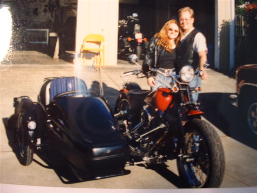

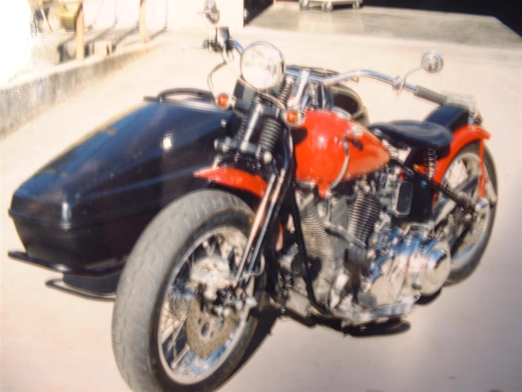

Here's an '03 Evo chopper rig I set up for a young couple's honeymoon trip.

Lonnie.... That looks like a hard ride...but I love the look... Harley makes a new "old looking" bike that would ride better ....(I think)... more expensive probably...but I love the look.... Was ther honeymoon a long distance ride ? hopefully they were young... love makes up for lots of pains... My wife and I took a Volkswagen camper on a 2 month camping trip 35 years ago... probably why she won't camp with me anymore...

That's the young couple standing behind the rig.

Just curious,did he say why the hand shift?

I love the look of the tank shift and the foot clutch... and of course the front end. What a neat rig... Now that's the way to start a marrage.

They wanted an old school Bobber with Evo power and dependability.
