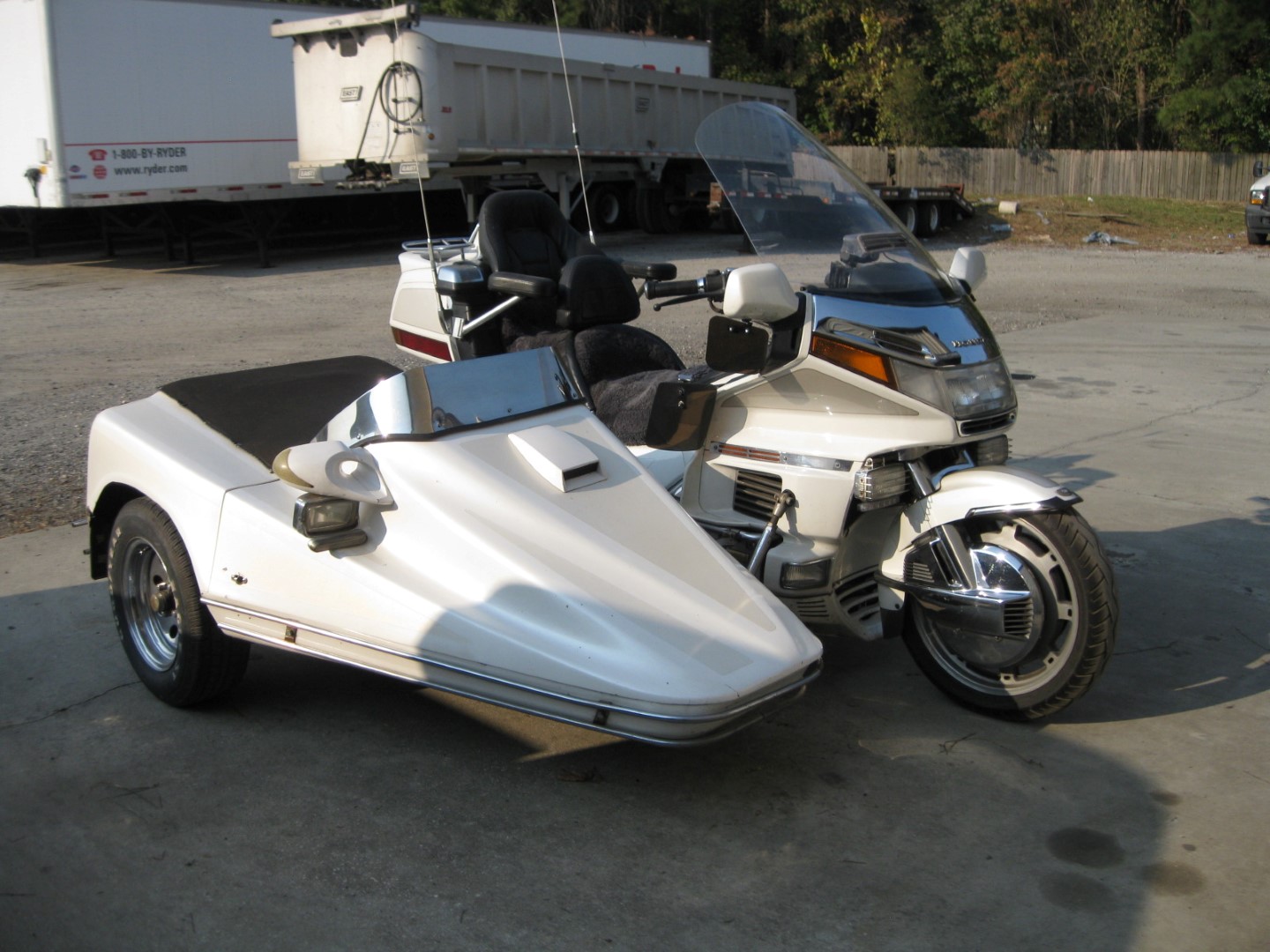

... I am hesitant to pull the trigger on one because of the heat here. I am afraid the passenger(s) will roast in traffic.
Anybody has one around south...
A passenger in most any sidecar will be hot when sitting still in the sun in the Southeast USA. A couple of things we've found that help are a sheepskin cover/pad on the seat and wearing a long sleeves "for shade" - such as a light weight mesh riding jacket or a light weight wicking "fishing shirt."
A local fellow with an Astro found that a couple of Pop Vents yielded a great improvement in ventilation when moving - as attested by his passengers, such as these: https://bikescreen.com/collections/accessories/products/pop-vents:

What kind of damper do you use, is it water tight and cold air tight? I really like the looks of it, with a few more wheels could be an indy car! It could also be used to blow up a skirt!!!! 😉

You can still get the vetter pop vents online for just a few bucks. I used them in my r1100/astro sport rig. I made the windows much larger on the 2+2 and found we did not need them.

I cut a 4 inch hole in the sidecar, placed a 4 inch PVC fitting cut down to the treads in the hole with epoxy. I then fiber glassed a hood scoop on. When the PVC plug is screwed in it is water and wind tight

Did you add a screen to the scoop? Wouldn't want the Mrs to be sharing the ride with any hitchhiking bees! 😀

Thought about it but never did. I may put a screen over the PVC back inside the scoop

I took your idea and added a front scoop to my rig as well. I didn't glass it to the body like yours and mine is smaller. like you a drilled a 3" hole in the body and bought a drain valve for an RV gray tank and bolted it to the inside of the car, this way the rider can just reach under the dash and pull the handle to open the vent, they can adjust the amount of air flow also. I did put a screen in the scoop to prevent the possible stinging visitor
My Wife loves it, she said it made a world of difference in air flow inside the car
