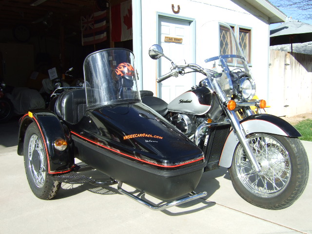

Sal, wider front tires and wider flat handlebars should be better suited for sidecar duty than the skinny front tire and buckhorn handlebars on the Intruder. If you prefer shaft drive, the Volusia/C50 version of the Suzuki may be an viable alternative. Roland & family have 40,000+ miles on this Volusia/Velorex combo, many of the miles commuting to school & work; this photo is from 2010:

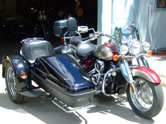

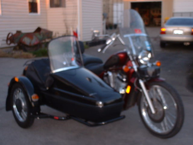

I'd probably go with the Shadow but either way, here's what either Marque might look like with a Velorex.
