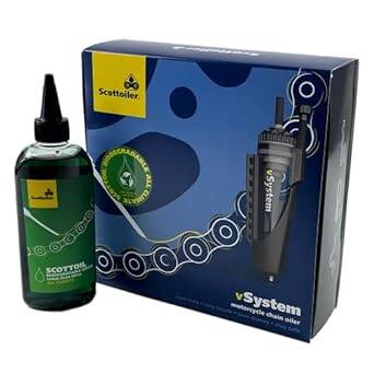

Homer, there is almost zero difference in mounting a sidecar to a chain driven bike, vs a shaft driven bike. As noted by @Brstr, you can more easily change the gear ration on the chain driven bike, to satisfy the need for more grunt with having a sidecar attached to the bike.
20,000 miles out of a chain and sprockets is not bad...very acceptable....many people gets less miles out of their chain and sprockets.
BUT....it is very easy to get MORE miles, in fact I will say you can DOUBLE the mileage on that bike for a chain and sprockets, if you install a ScottOiler.
The one you want is the V-model...NOT the E-model, or any of the other ones. The V-model.....only $ 139.00, easy to install, if you are in the Great Pacific Northwest, I will install it for you, for FREE. Never have to manually lube your chain again, much fewer times of adjusting the chain, and will double the life of the chain and sprockets.
https://www.amazon.com/Scottoiler-vSystem-Automatic-Motorcycle-Lubrication/dp/B0BQN913S8/ref=sr_1_1_sspa?dib=eyJ2IjoiMSJ9.a2hW7KweWXuDrIV_hZsNOnNAM9GgYz8yK_2pEgqvDcvBRQ3oGogDQvsgBpkB5jsUhjV-OLRaiG5WeZ8v1c_ziMHgiFNaoOTWwXRaIh5eAJfN7K63AbQPhfDFysdnoyogb8q6s9ko-mv7wBtocYDosNY_MW_eIe-qnEaD6WMCpocgRIhM7kpdTbtpoPvPpnYuOHD4ZvGo4vXIenntrE8N6ABxx7_n8jO8orgsFZgRIF-CZDafklRruLE2_3YB7kZam8DgcyXd2A06cAa4Eds0Gi55brmyCy25aO2AnOOeMME.3BrPpZVmrwIbkIbYCiXtKpK33NYMJrhDHxHVZ0f0bjQ&dib_tag=se&keywords=ScottOiler&qid=1722537607&sr=8-1-spons&sp_csd=d2lkZ2V0TmFtZT1zcF9hdGY&th=1
41P+ arKGBL. SX342 SY445
Posted : August 1, 2024 12:39 pm

I run the Scottoiler "X" series 2 unit that picks up on motion to know when to drip oil at what ever rate you program in by touching a slider type switch.  Their series one unit was pretty lame, with problems on the reservoir actually holding oil.  The series 2 has now been on for a couple of years on my rig, and about 3 years on my son's AT.  They seem to have resolved that issue.  Scottoiler people were great to work with in this resolution, BTW.
Taking a quick look, I see they have evolved the "X series" to a version 3.0.  Kinda spendy at $268 off Amazon, but I liked the electronically triggered flow. The V series that Monkey Dude recommends is probably great, but I was too lazy to figure out a good spot to pick up engine vacuum to trigger it.

@miles-ladue Thanks - going to order one  = the version recommended.

@hlk For what it is worth, after running out of the high dollar "Scott Oil" that they sell for their oilers, I switched to just running Synthetic 75/90w gear oil that I already had in my shop.  Works fine, lasts a long time!

And Homer, before you start to install that ScottOiler, if you have any questions, don't hesitate to ask me, as I have installed more than 20 of those, and never had a failure.

On recommendation, I tried using red ATF oil in the oiler. Worked great, cost less that other more expensive oils, easy to see if you are over or under oiling. It stands out from other oils.
