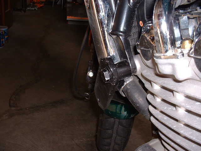

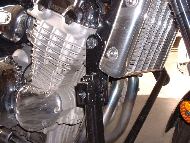

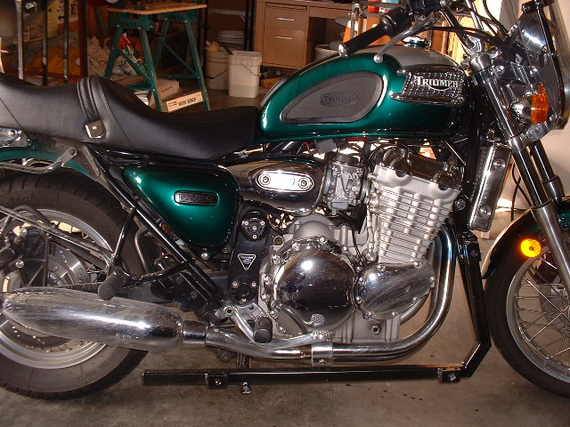

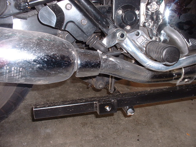

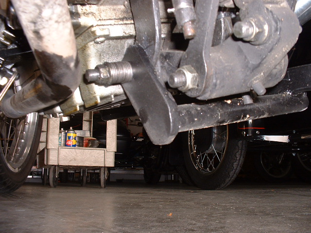

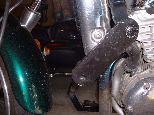

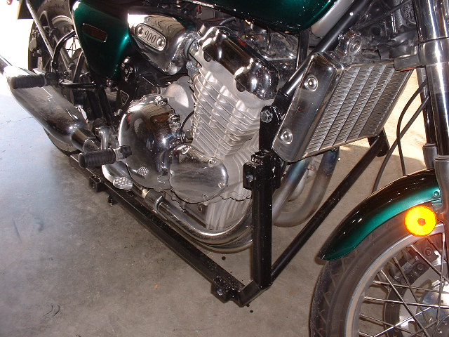

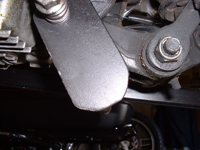

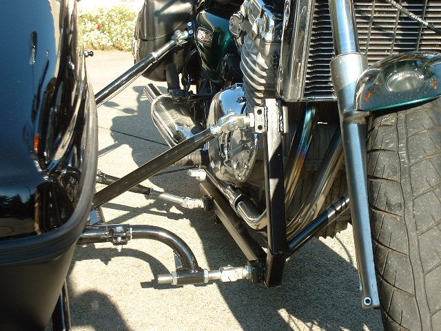

A few years back I purchased a Triumph TBird sub-frame from my friend Doug Bingham. He was the only vendor at the time that had a Triumph sub-frame for sale. Like most of his work it was a little rough but sturdy. Apparently he had some extra washers and Velorex frame clamp blocks.
After that one I built my Triumph sub-frames on the bike.
Here are some pix. Maybe they will be of some help as to mounting positions for the Tiger.

Thanks, Lonnie. But I don't see the pictures?
Posted : March 27, 2016 6:03 am
Try again, it took some time to upload the pix.
Posted : March 27, 2016 6:13 am
(@Bob-Herman)
Posts: 40
Okay, now I see them. Thanks.
This setup is pretty close to what I envisioned for the Tiger, and gives me confidence that I am on the right track. Thank you, Lonnie.
