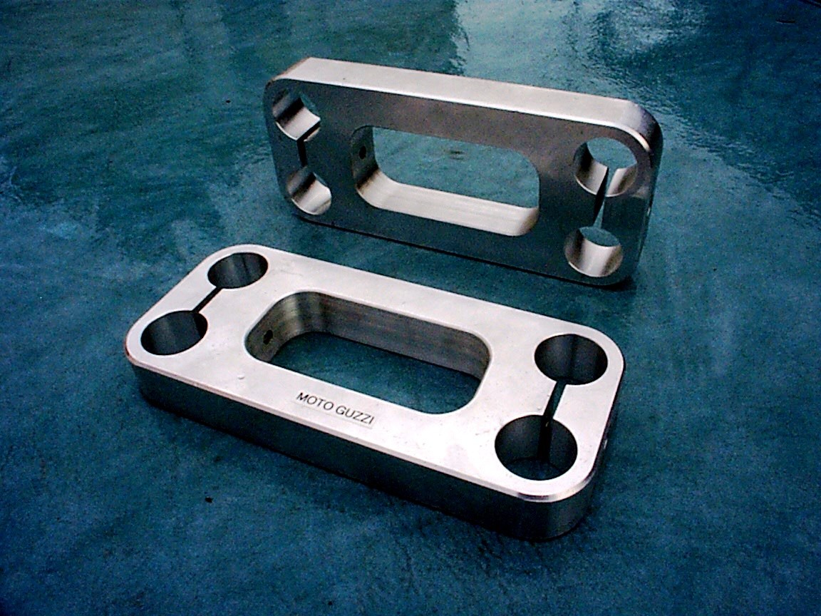

We use to make clamps that go on the top end of the fork to move the entire fork forward. We no longer offer these however they would be fairly easy for some one to have made. We were thinking about an inexpensive way to make them again, just got to busy with other things. We were going to work with a company that claims that they can water jet cut them out of one inch think plate aluminium. All we would have for your bike are proper not "universal" mounts as well as we do offer aleading link front end as the one we make for the G5 / Convert should be the same.

You keep the original tree's in place. You then slide in some old fork tubes cut down such that they are a bit longer then the distance between the tree's. Then the clamps clamp onto the salvage fork tubes and your original forks clamp to the other side of the clamps moving the entire forks forward by about 2 inches with out changing their angle.
Nothing for the Toni frames, we are set up to rework the tree's on Eldorado's which is what my wife runs. I have attached a photo of clamps we use to make for the G-5 / Convert.
I could not find photo's on the bike.
