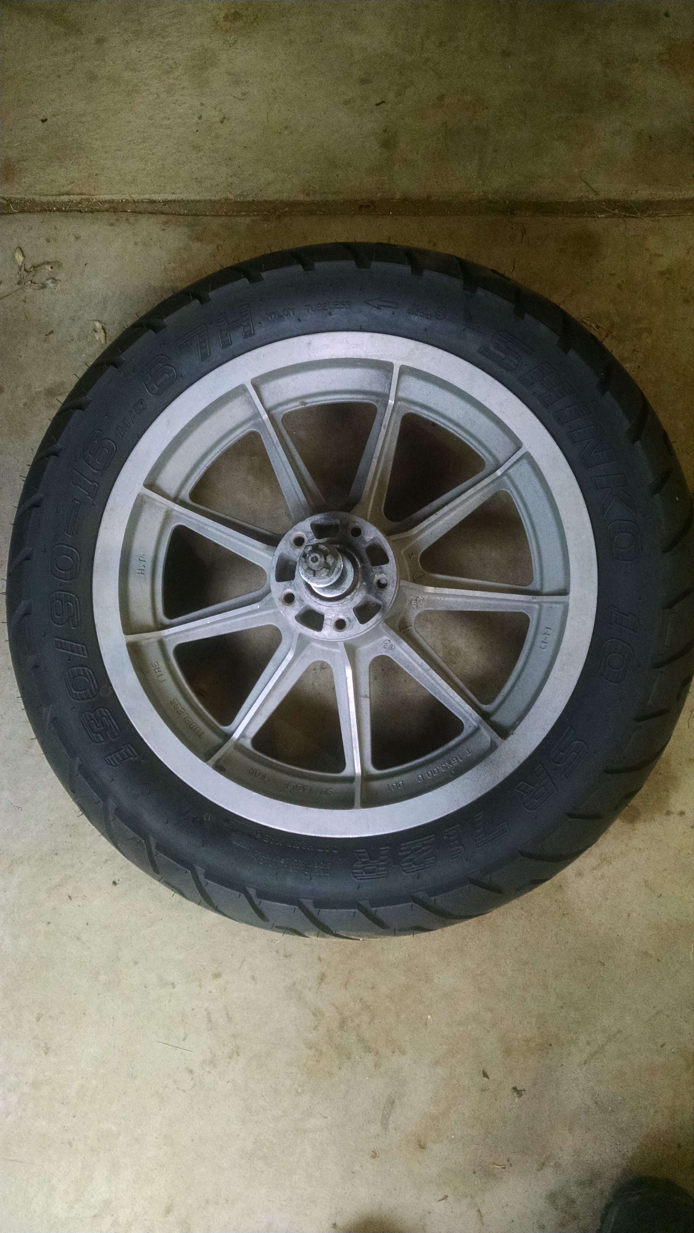

I have a Sportster rear wheel with an axle that I could let go for very cheap. I got it off a home built sidecar I bought for the Harley tub that was on it.

I would sell the wheel and axle without the tire for $50 plus shipping. Thanks, Dave

Axle is 3/4" dia., overall length 12", 5/8-18 threaded end.
