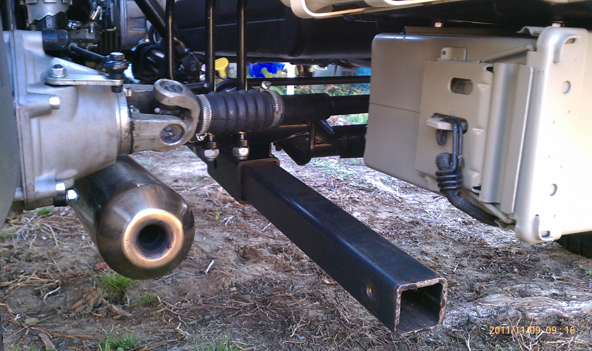

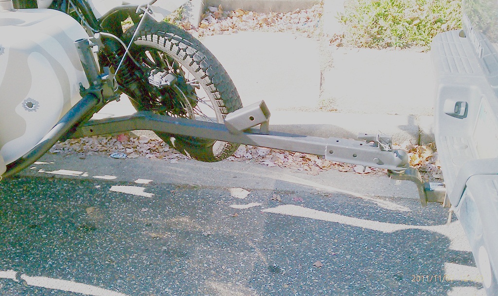

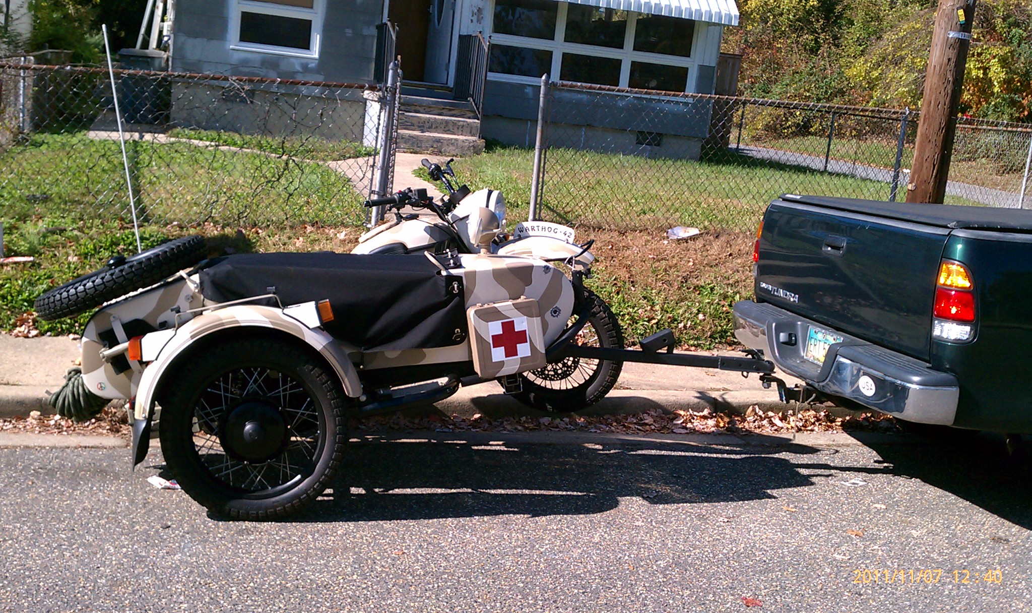

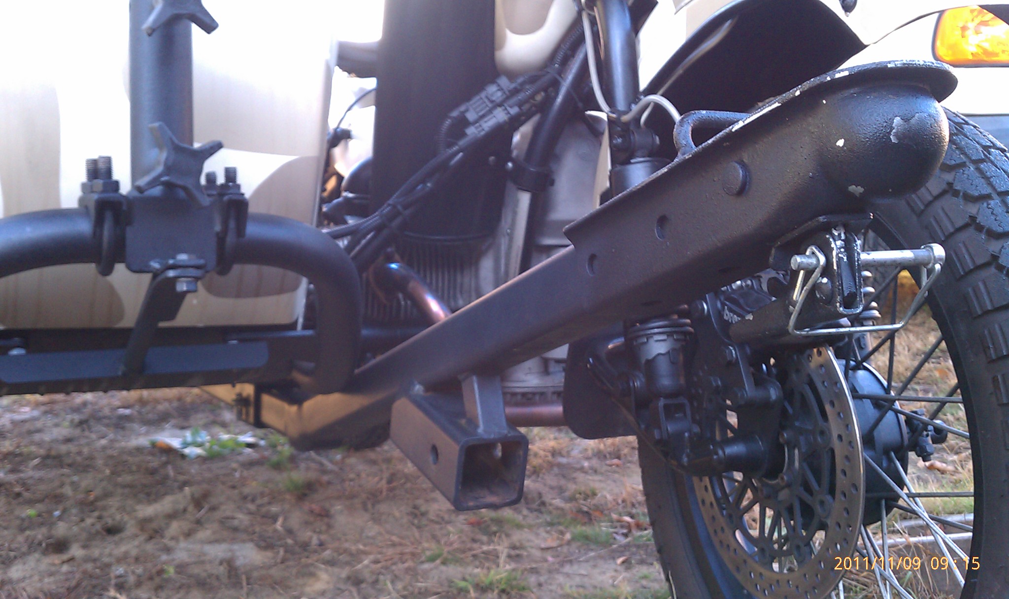

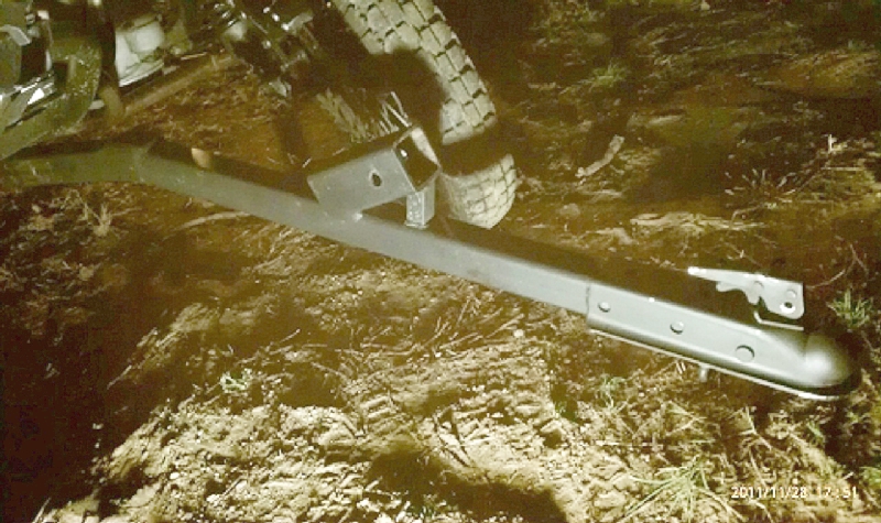

These photos show a Ural with a homemade Tow Bar setup. It flips over to allow the angle to move the front wheel up off the road and then stores beneath the hack frame when not in use. It is an interesting tow bar mod.

Yeah, your correct and you would certainly have to look at such first in making one for yourself. The fellow who made this particular one up for his Ural has already used it when he recently broke down on a trip out of state to VA. He got someone to tow him with it and he says that it worked very well for his rig. I plan to make a similar one for my Troyka in the near future. I won't store it on daily neighborhood rides near my home, but I'll have it handy for any longer trips.

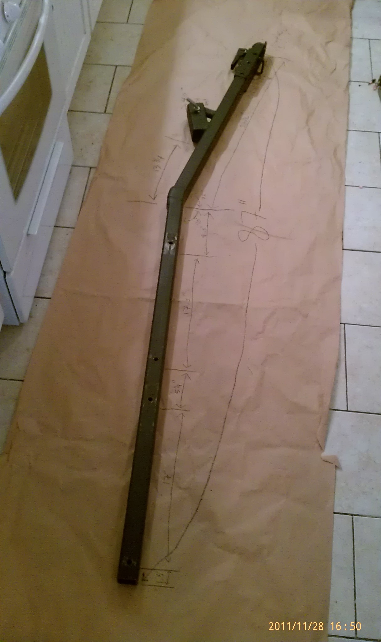

Here are a couple of pics of another tow bar used on a Ural.
Another question on use of a tow bar, is, will the tranny ever accidentally jump into gear when moving? Me, I don't believe that would happen, but it is actually easy enough to make/fabricate a cover to go over the gear lever on the Ural to prevent such from happening. My contention is that if it was going to do such, by accident, the rig does not know when it is being towed and would do it when driving with a pilot on it, too. After towing Model A's for years with a tow bar, I am not all that fearful of a tranny suddenly shifting gears on me by accident when the vehicle is towed.
As to handling, I really can't say, as I have not built one yet for my sidecar. I assume it will tow just like a two-wheeled trailer, but the wheels of the sidecar are not at the same plane on a Ural. They are offset a bit from each other and not directly in line with each other. (Hope that says what I wanted it to). Any rate, the fellow who made the first one that I'll be copying in the near future, didn't mention any quirks in handling with it. Like towing any trailer, you do need to follow some common sense safety techniques in stopping and in making turns. He also has safety chains on the tow bar. The HF magnetic lights for towing are likely a good investment, too.

i have almost finished making a copy of this Ural tow bar setup. How it would work or not work with other sidecars, I have not a clue. I can't address how it works just yet, as I have not fully installed it just yet. Mine still needs to be painted, so even when I put it on for testing, I'll have to disassemble it all for painting. Unfortunately, the local area has been really wet for the last few days and weather is getting cooler. I have not mocked it all into place just yet, but the main bar is welded and all the hardware is there to be assembled. I'll add more pics to my flickr account in the future, as I get the work done. Hopefully it won't be long before I can test it behind my old beater Nissan pickup and find out just how it does do when it trails behind me at various speeds . Although the receiver pieces hold the tow bar for storage under the hack frame, I doubt I'll store it there all the time. I figure to use it most often for off-roading, which my Troyka has the ability to do. I like having the option to carry it in my truck or on the Ural. It may even add ballast, but not sure how that will effect things or not. If one has the welding skills, equipment and talent, this is an easy and cheap mod to make. I have essentially none of those qualities, so my cost outlay has been about $100 bucks, so far. Not bad when compared to the cost of a trailer that takes up a lot more space and is probably more apt to be a theft target.
Here is the flickr set, but none of the parts have been primed or painted at this point. I'll add more pics as I finish out this project. Gobium was the fellow who gave me the most input for this DIY project with his photos and advise. I modified the receivers a little differently than he did, but everything else is pretty much the same. I have not weighed out the total parts to see what it added to the weight of the rig. I had to make my receiver support pieces a bit different than Gobium's, as my frame is a hair different than his and I wanted the pieces to not interfere with my engine jugs and such. They make a rubber inner part to keep the main tow bar from rattling inside the receivers, but I have not ordered those pieces, yet. Gobium used a big hose clamp to pull up his bar and keep it from rattling. I think I'll order the anti-rattlers, myself though. Lots of various styles of them to pick from.
http://www.flickr.com/photos/a1930ford/6445801935/in/set-72157628257545359/
Like say, I can't say this would work on every rig, but it does work for a Ural. Can't say how it tracks behind a vehicle, as I have not experimented with such just yet. It is easy enough to make if it interests you to try it out though. My tow bar has not been chopped down to the final length just yet. I could add a hook or receiver tot he rear for pulling the bike out of any mud or such, if I wanted. Gobium's pics show his tow bar made with a receiver piece for his winch to attach to. I didn't put one on my tow bar setup, but I could at a later date, if I needed to. Lots of options to modify it as one desires. If I had a welder and such, I could have easily cut the cost down to very, very little on this project. My local welder/fabricator charged me $40 bucks to weld on some tabe for safety chains on my old Nissan, cut and weld the main tow bar piece, add a piece for looping in the safety chains on the bar, making up the support pieces with the hangars attached, cost of two pieces of 2"X2" bar stock and trimming all pieces and drilling the holes. Not bad, in my opinion.

A one piece drawbar tube heated and curved to the 25 degree angle would have less chance of failure from the constant impacts of weighted towing than a 2 piece drawbar with an unreinforced buttweld.
A straight drawbar wouldn't be as affected by the torsional stresses that can also lead to failure of the two piece drawbar.
Steel is cheap, your Troyka isn't.
L.
