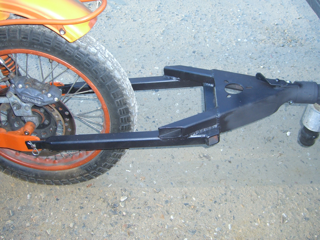

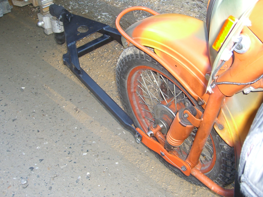

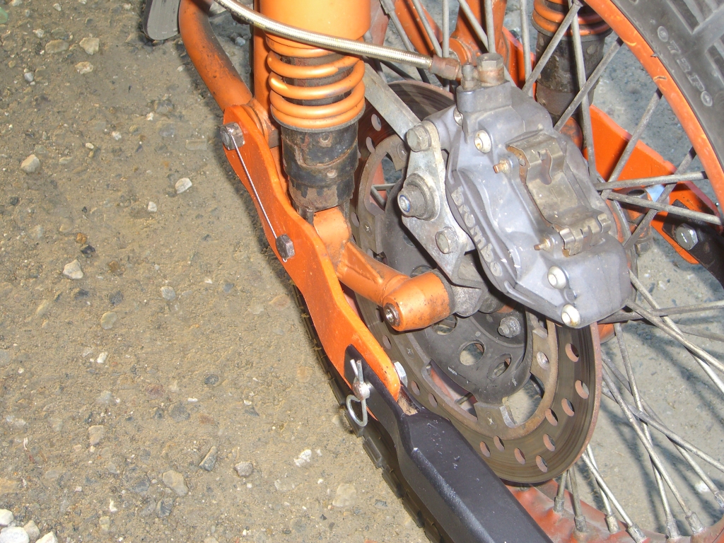

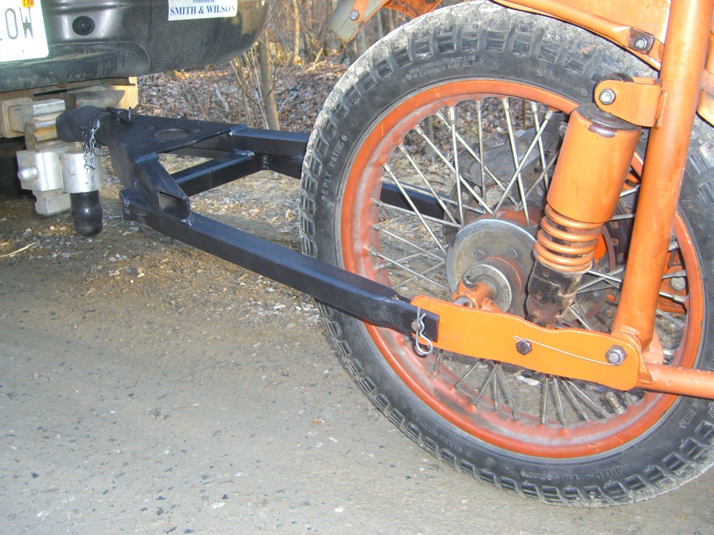

Well, we will have to see in that regard. I can always have another long piece made if I want, as all the pieces are detachable. I suppose one could telescope the end pieces and pin it too, if they wanted to try that option, too. U'll have to ask my welder guy just what he thinks would be the strongest to use. May be something to consider. I don't see this bar as having chronic use.
Posted : December 4, 2011 10:30 am
I don't really see an issue with a tow bar welded by a professional welder. The back yard hobbiest can add a small plate on each side of the welded area if they are not confident in their welds. Weld the edges of the plate length ways along the corners of the square tube. Not across the tube. The easiest way is to take the tubing to a tube bending shop and have them bend it for you. In a situation where you are going to support the weight of the bike with the front wheel off of the ground I would probably use a slightly thicker material than usual. Probably not a real problem but one less thing to worry about. Safety chains are a must for this. Thought should be given to the fact that if something breaks of the hitch comes off of the tow ball the front wheel will hit the ground causing it to try to steer in whatever direction it is pointed. A normal trailer will usually just drag along behind in this situation so it is important to be sure you have strong chains properly mounted. Bob

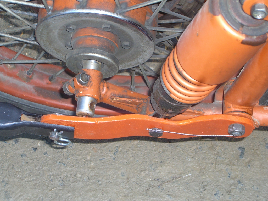

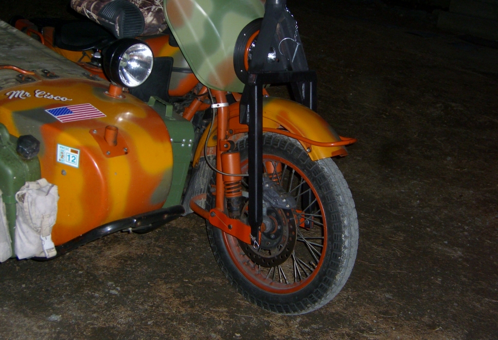

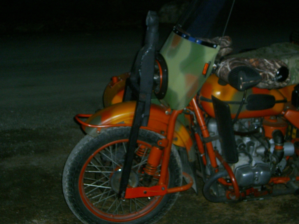

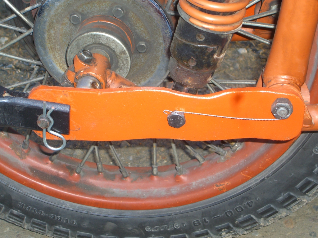

The fellow who did my welding is a certified welder and knew exactly what this project was to be used for. Even so, I didn't watch him directly welding it, as I had burned my eyes with a bad flash burn in the past and I recently had surgery on both eyes for cataract removal. I didn't want to chance any further eye damage, so I didn't watch his work as he did up this piece. I still have some additional trimming of the rear of the long bar and some drilling of holes for another receiver to the rear and the receivers on the frame. I found a removable tow light that pins to a receiver and had all the wiring and pig tails to it. at Walmart, for under $10 bucks. This is cheaper than getting some magnetic tow lights, so I'll pick up another receiver to stow in my old Nissan beater truck that I'll use for towing. I'll address the issue with my welder when I return to have the final work done by him, but I am pretty sure he covered all the bases when he made the original long bar to this setup. If any additional support is needed, I'm pretty sure he will let me know. Never wrong in the least to suggest looking at such though. Safety is only as safe as you make it.
I am always updating the pics at my flickr set regarding this. I have not actually hitched the rig up to my truck. I have a battery swap in progress and didn't want to get out in the rain or the cold garage floor any more than I had to today. Eventually I'll update this set and show the tow bar setup as it progresses to completion. I am a firm believer in safety chains and my rig is set up for that. I don't believe I have taken any pic of such, yet. Most of the pics explain what the pic represents, so anyone else can easily adapt whatever they believe works best for their own setup or rig.
Like say, this is a work in progress, but getting nearer to completion all the time. Wish my bike was running at the moment, as I do what to see if there is any real difference in handling when the tow bar is actually in place on the bike. I really don't expect to keep it stored in the receivers all the time, but it is always nice to know of any driving change characteristics in advance. This surely adds some ballast, but where it adds it may make change in driving. I'll be glad to check it out as soon as my new battery is in place and the rig is all put back together. My particular model of Ural is a real PITA to remove and re-insert a new battery. It is not a 10 minute affair in the least. Qualifies as actual work and for someone who is retired, work is a dirty word. 🙂

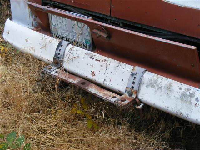

This looks exactly like the Harley had, except it wasn't much heavier that the tube one on the video. As I said before,ours had a clamp on the end for old style steel bumbers. Similar to this, but only about 12 inches wide.
It would be useless today.

Yes, I had thought it may be my browser. I'm sort of laughing about the bumper attachment, as I recall just how flimsy my Model A bumpers were. The attaching bolts were well known to be rusted and easy to break on those old Model A's. My '42 Chevy bumper wasn't much better, either. 🙂
